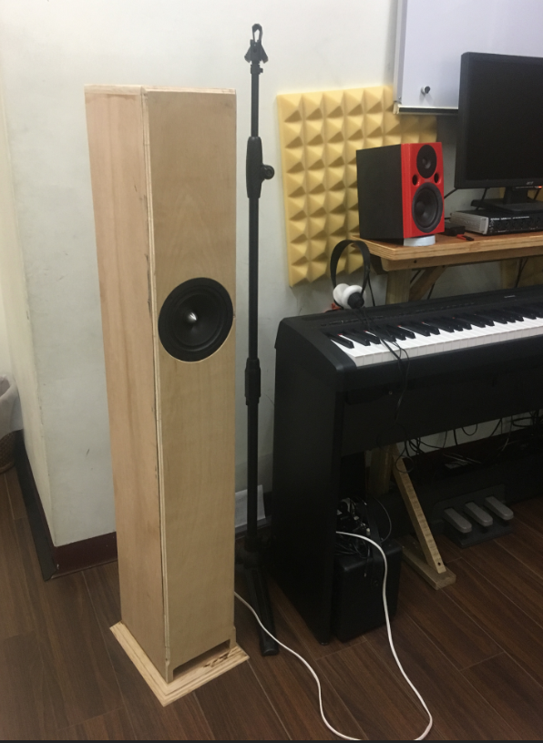

Well, it took a long time, but the TABAQ large with the W5-1611SAF I had planned to do is slowly coming along.
One is assembled, the other one on the way.

Great perceval - looking forward to see the finished boxes and your listening impressions. I see you mounted the drivers on the inside of the baffle. I am contemplating doing the same with my 4FE32 drivers which should land soon. Did you make a rebate at the back for the drivers? I assume your are using something like 15mm thick plywood here.
Actually, the baffle is two layers. So, drivers mounted on the face of the baffle, and another 7mm layer glued on top to rebate the driver flush to the baffle.

Hi there,
Just wondering what’s the dimensions of the port of your TABAQ large?

Hi there,
B
I tweaked the dimensions of the line and port a little after measuring my drivers (after break in), which numbers were a little off from the company's specs.
My port is the same 3.1cm, but I set it at 9cm long for my drivers.

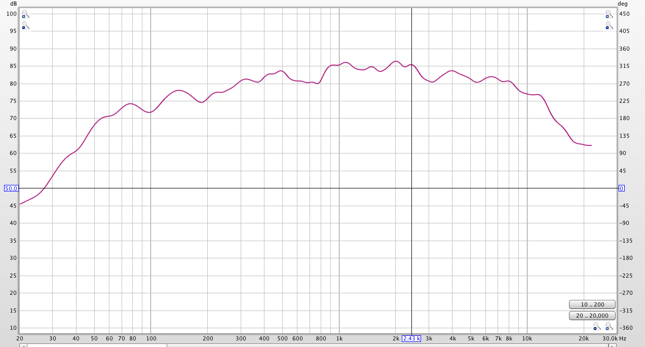

Hmmm... did some measurements.
(drivers were broken in a while back with 200+ hours)
I feel a little let down by the W5-1611saf in this case.
I have read it was a good driver with a good reach... for a 5-incher.
But I'm not sure I can live with its limitations.
It doesn't reach lower than my 4" drivers, and it starts beaming much earlier than my other TABAQs. If on-axis, the reach is fine and will need a BSC.
But just a little off axis and it starts dropping at 2.5kHz... which the BSC will just make worse. And if I just run without a BSC, than the 800Hz-5kHz range will be prominent, and I hate that kind of sound, where the mids overpower everything else.
Plus, listening as is, I can kinda "hear" the plastic cone... which is strange because I do like my polypropylene coned W4-1052SD... but the W5 is totally different.
So, I might transfer the W5 to a simple ported box for near field listening (computer speakers) and somehow make the Large enclosure fit the SB 5x8" woofers... that will take some creative work, I'm sure!
Then, I would just need to tweak the vent and add the SB65 for high range. I think it would work much better.
Here's the W5 off axis, 15 deg:

But that is typical fullrange off axis frequency for fullrange I think?
Especially small fullrange, my W8-2145 is pretty good of axis.
And now 2020 I dont run any speaker without EQ.
Either EQ APO or DCR with Brutefir with Raspberry all of them free of cost.
But I only run my music from computer or Raspberry but minidsp are good also for dedicated amp.

So that's what I was thinking 3-4" driver are the winners in the Tabaq while the 5" struggle a bit, thiele-small parameters, sim etc. help to find a possible right candidate but then the most sophisticated device our ears are the one count

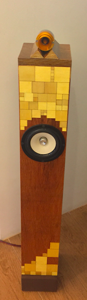

Hi tamra,
I build Tabaq with W5-2143, very nice driver but on-axis only, beaming problem is very noticeable so as you can see I solved the problem adding a tweeter on the top, now beaming problem is solved.....all the best
