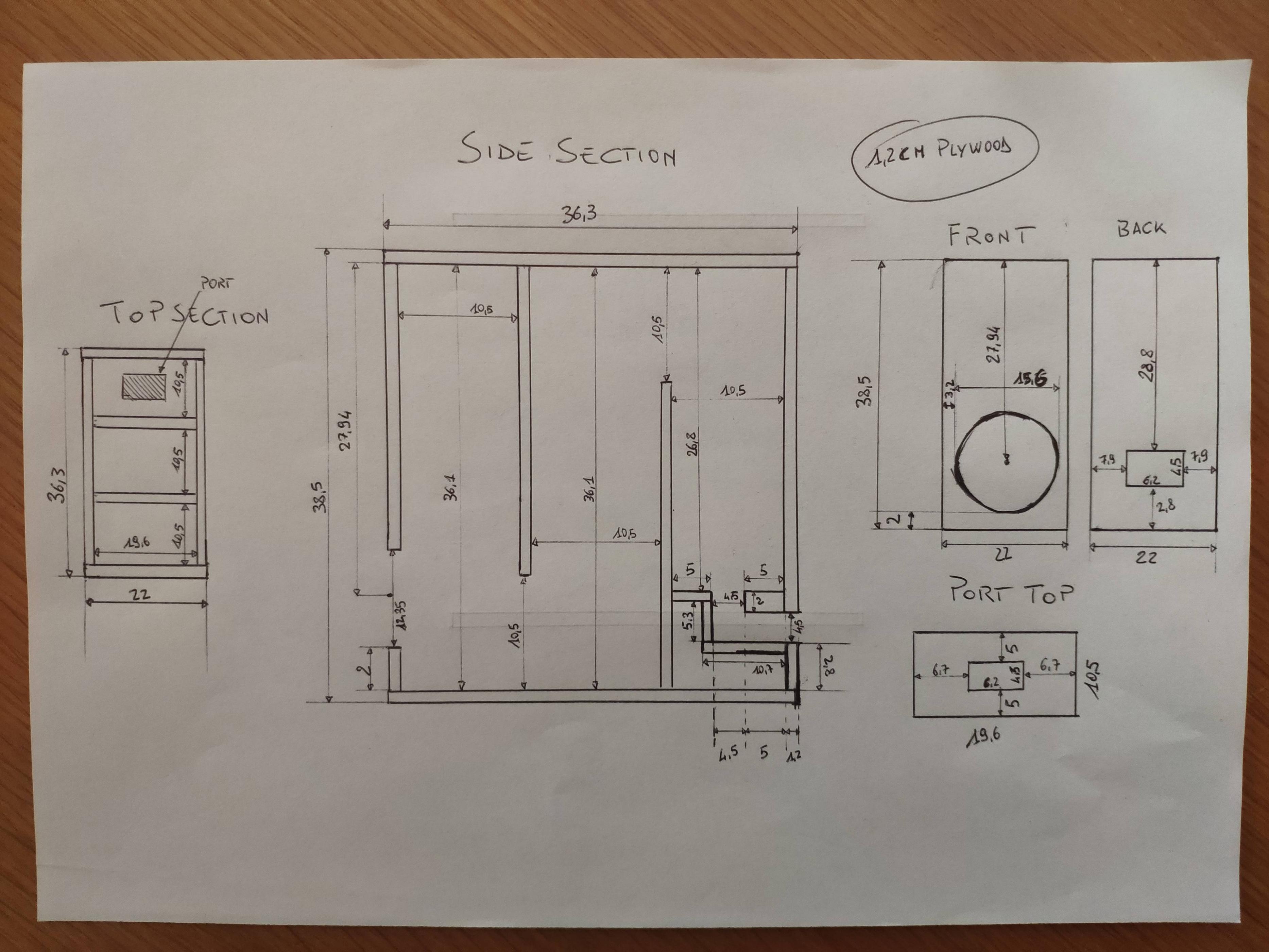

Looks good - do you want the driver so close to the bottom? Maybe flip whole box upside down so vent and driver see on top wall.
Yeah, that's the idea: flipping the box! Thank you

Hi ddlooping, thanks for spotting that, I'll transfer this to CAD and update the numbers. Sadly I need to adjust the port size because of this mistake
I think the front and back should be 36.1 cm instead of 38.5 cm as well.
Profile picture of enclosure has front and back panels mounted internally and marked as 38.5 cm. but 38.5 cm is the total height of the enclosure while 36.1 is the internal height.
The dimensions from front to back add up fine for me.

Indeed, another trivial mistake from my side. Please excuse me, that is my first try with this
