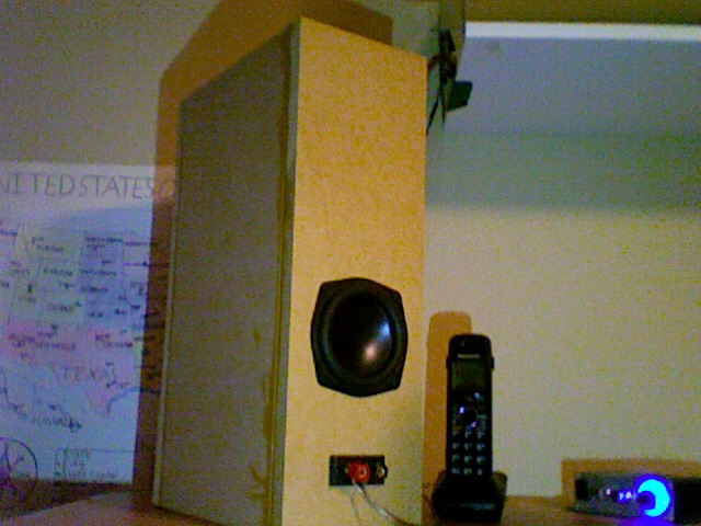

Alright so I just went ahead and build them. I'll post a little more info tomorrow when I'm awake but the initial graphs show the lower corner just barely above 50Hz, almost exactly as the graphs predict for the other drivers. These things are bass monsters, with 20mm of Xmech they can make my entire garage painfully loud.
That was a fantastically easy build. Finished in record time. It also turns out that a standard air plane pillow that they give out has almost exactly the correct amount of stuffing material for one. I cannibalized 2 that we had from our flight to Hawaii a few weeks ago, I just ripped the cover off and stuck them in there after some stretching actually. I weighed them and they were 4 ounces, which is close to what is called for.
I think they will perform wonderfully for my fellow pole vaulters
Thanks for the excellent design Bjohannesen! I may have to build a few of these for myself with some higher quality drivers at some point. Graphs and pics to come

Heres a quick picture I took on my mac's built in camera, it's not super high quality but lets be honest, these aren't Mona Lisas...
I don't plan to finish them, there's really no point
I've been listening to there all afternoon pretty much. Off axis response on these drivers is excellent, well, relative to on axis response. I can't get over how good the low end is, my brother came back from college for a few hours today and listened to them and his response was "How is it so good!?" I then discovered the futility of trying to explain a mass loaded transmission line to someone with no background in audio.
As expected though, the high end leaves something to be desired. I'm not too upset by this because they will be used in a boom box sort of setting.
I think I need to make a pair of these for myself with some nicer drivers, maybe some 4" Tang Bands. Whichever have the most Xmech probably.

All in all, not bad for a pair of speakers that cost me about $50
P.s. Who knew you could use bookshelf speakers on an actual bookshelf?! Weird, right?
