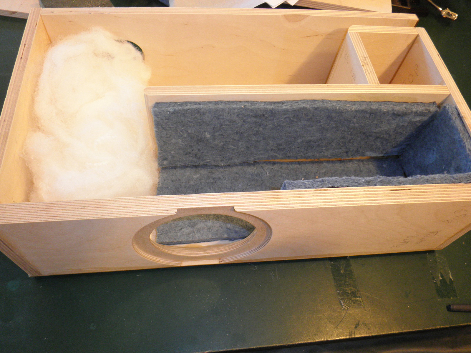

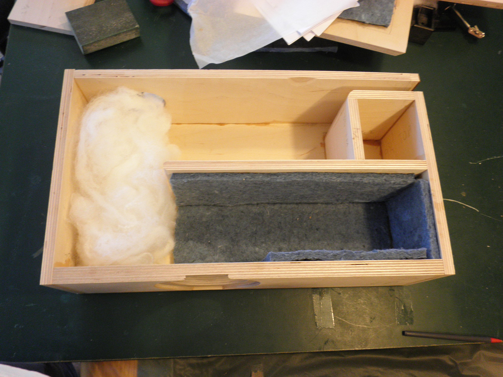

Hi Bjohannesen,
I'm in the early stages of construction on your TABAQ w/ 4" TB bamboo and I have a question on the stuffing. Your diagrams states "Opening and the last 25cm of the line is not stuffed".
Is the opening considered to be the full length of the 9.7cm filter compartment such that, from the top of back of the box, 25cm + 9.7cm = 34.7cm unstuffed?
Or does the 25cm include the compartment such that, from the top of the back of the box, only 25cm unstuffed?
Thank you for the great idea and drawing...I've never attempted a folded transmission line before!
Mario

Hi Mario, i could also have put it in this way: Only the upper 2/3 of the line is stuffed. The last one third and the opening is not stuffed. This is not critical, a few centimeres would not make much different. Also note that this is simulation.
You might find the bass a little too tight, but this depends on the placement of the speakers and your personal taste.
I tried to remove about one third of the stuffing (still upper 2/3 but more loose). This resulted on a little bit more and lively bass, but i went back to the original stuffing. I preffer a clean bass wihout "boom effects". With music I do not use my sub with the 4" TABAQ.
Have fun !
Regards
Bjorn

....getting there slowly but surely. Using 3/4" BB for baffle and 1/2" for the rest of the cabinets...will finish the cabs before 2 wks vacation on Sunday and will veneer them when I return....thanks for the plans Bjorn,
Mario

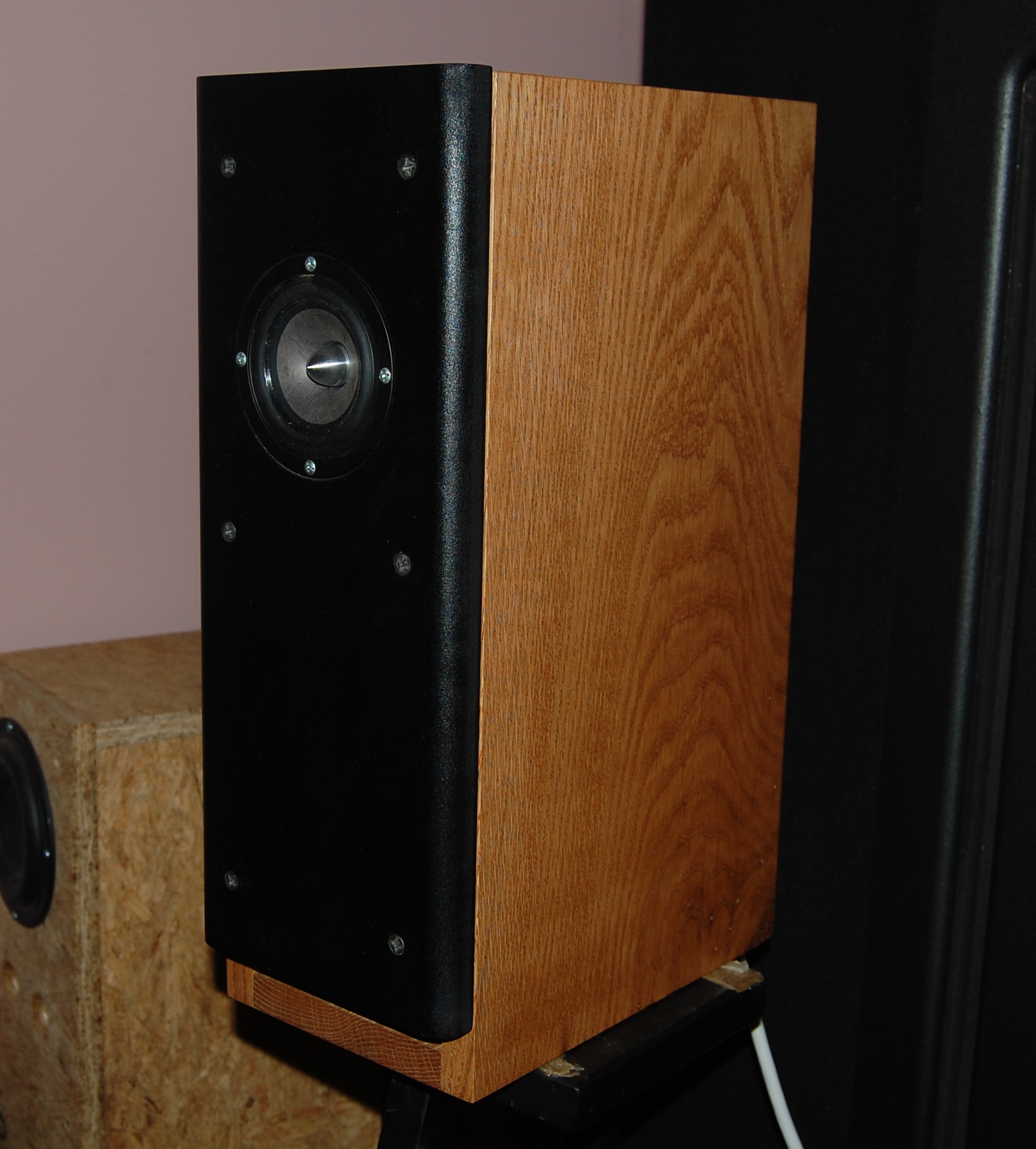

I put together a folded Tabag, slightly modified to place the port at the bottom front. maintained the required length and cross sectional area. The cabinets, except for the MDF baffle are made from a an old oak tree I felled a few years ago(3/4" thick). The 3" bamboo TBs sound really good.(my better half prefers them to my Apogees). Easy to adjust the stuffing with the removeable baffles, which has a profound effect on the quality of the bass.

Folded Tabaq
Mario...
Here is a pic of the Tabaq with W3-1364SA.
The port is not visible in this picture - underneath the lower edge of the baffle.
I'm busy making some heavier sand filled stands from granite tile, 2-1/2" conduit.
Hope to try them today. Also, I'm making a baffle for the MA CHP-70, just for kicks.
Cheers
Peter
