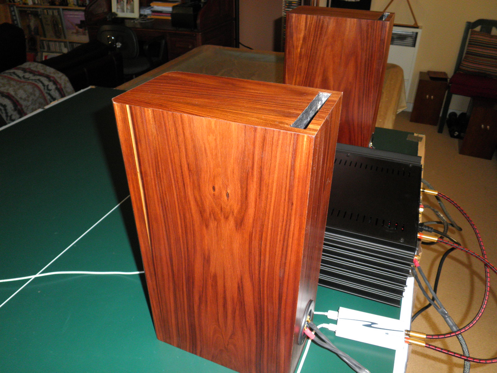

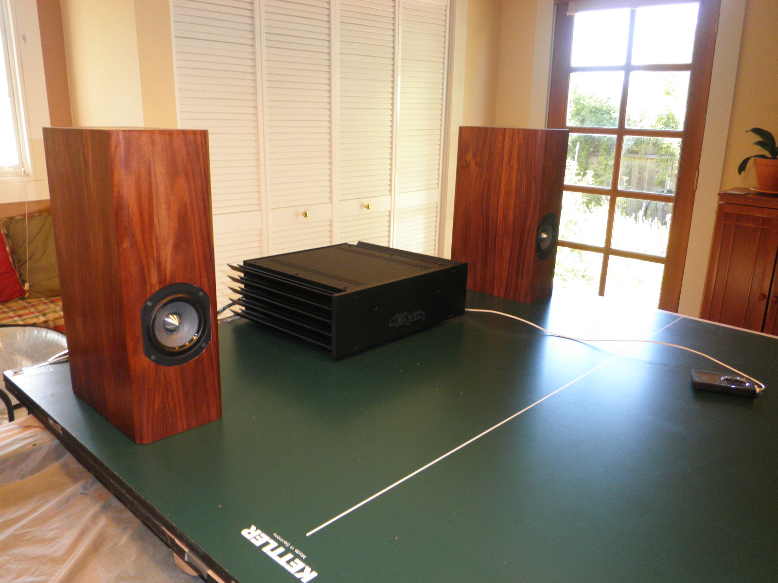

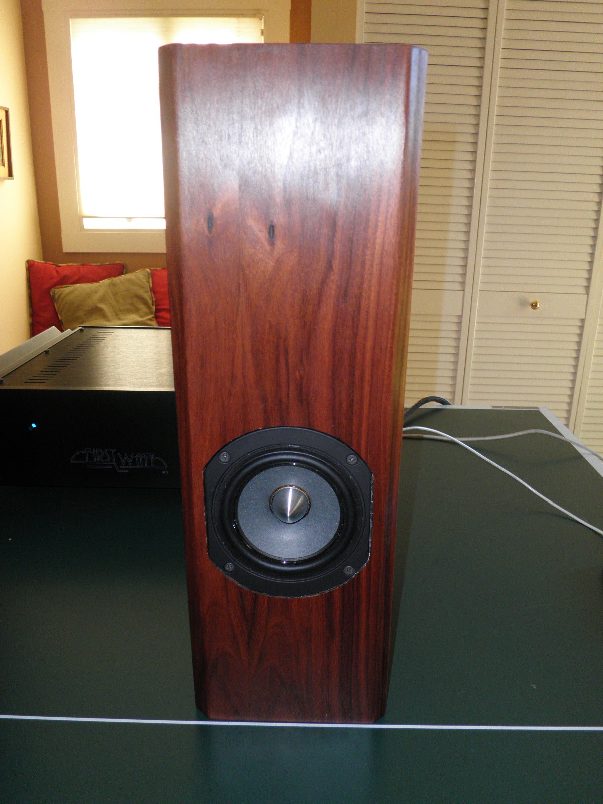

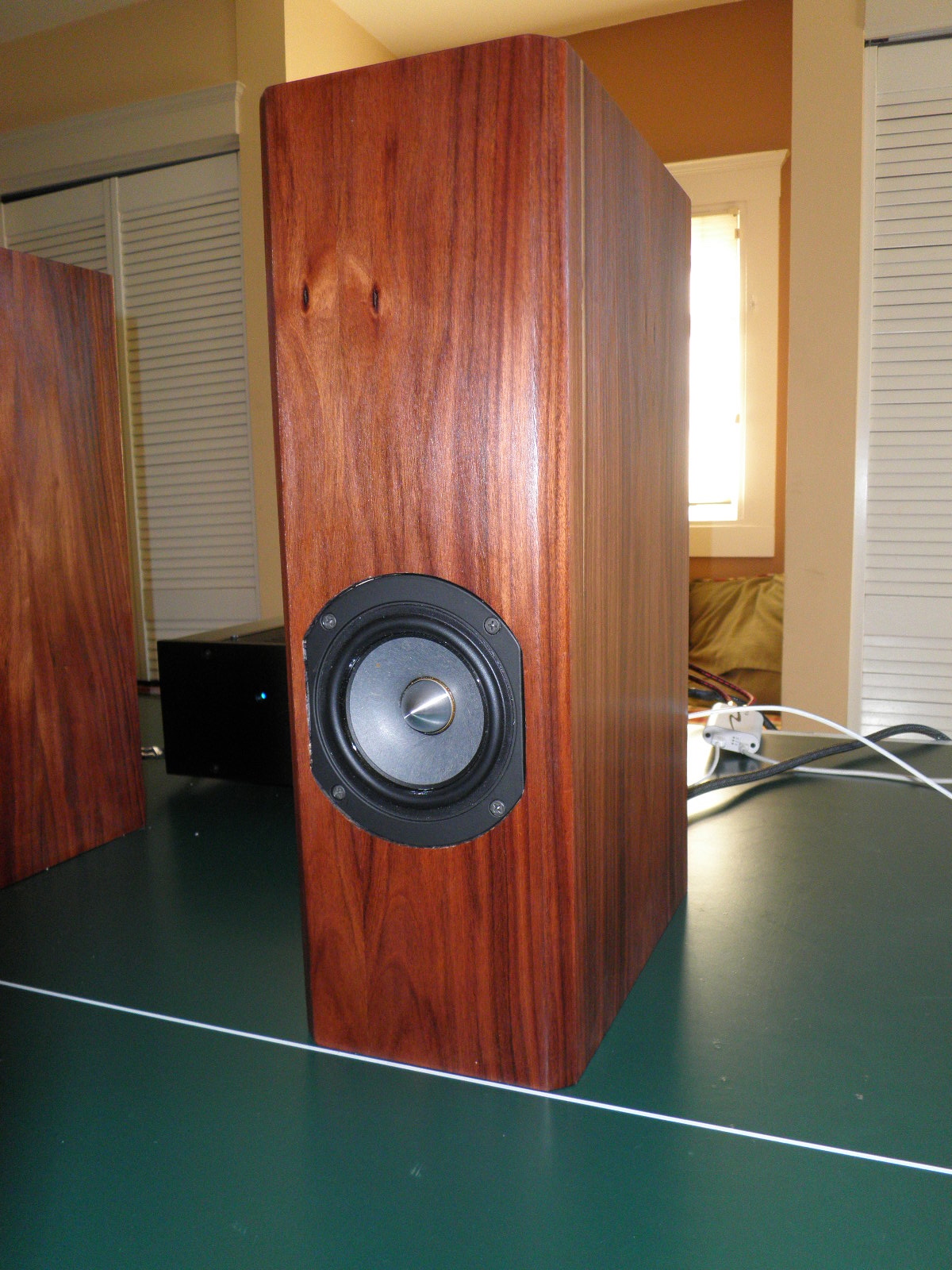

I finally finished the folded TABAQs with rosewood veneer. They sound much better than I had expected as the TL really brings out the low end. Imaging is very impressive as well.
The drivers, with about 120hrs on them, are TangBand W4-1320SJ's driven by a FirstWatt F1....quite a nice match providing forward, bass-full sonics right on top of the beat. I haven't put in any baffle step circuits and probably won't anytime soon. Thanks again Bjorn for this creative twist on a TL cabinet.
Mario
