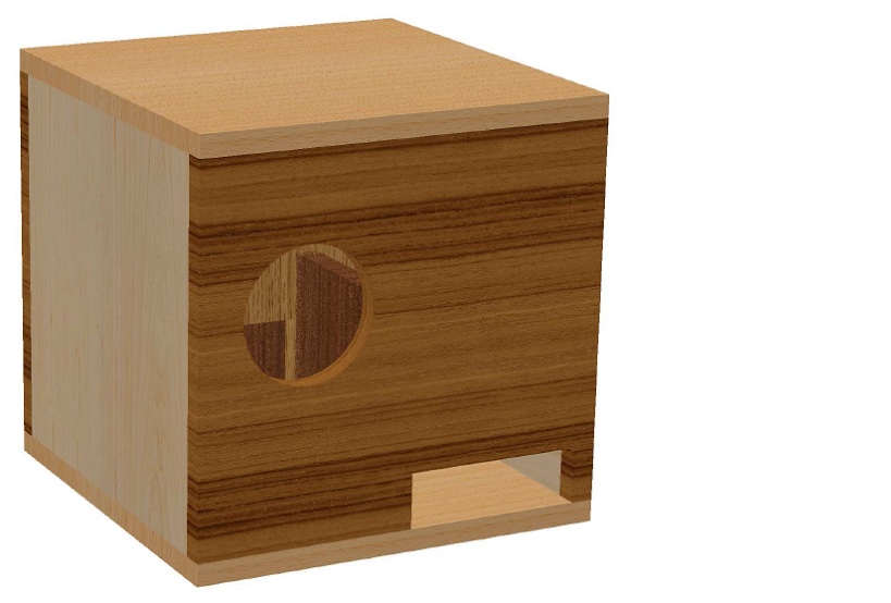

here is the design rendered in wood.

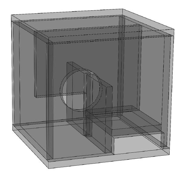

Here is a see-thru version. There are three internal dividers: one shaped like an 'L' and two shaped like small rectangles placed perpendicularly to the 'L' divider to direct the path starting from the closed end (the quadrant in front to the right of the speaker hole, above the vent), the path goes up, then turns 90 left, 90 degrees down (past speaker) then turns 90 degrees towards back wall, through the opening in the 'L' and 90 degrees up, then 90 degrees right, then 90 degrees down, where it reaches the final quadrant in the back, from here it turns 90 deg toward the front and exits through the rectangular port on the front. The port has a top wall that also serves as the closed-end wall. The total path not including the vent is 32 inches. Stuffing would be placed basically in the first 2 quadrants and partially in the third quadrant to fill about to 2/3 as Bjorn suggests - although this can be tuned. The speaker is located at about 1/3 of the way from the closed end. I would make the top lid removable with screws and gasket so that one can play with tuning using stuffing. This design permits the TABAQ to be essentially a bookshelf or desktop style speaker for a PC. The terminus being located at the front will enhance the bass and may reduce the amount of BSC.

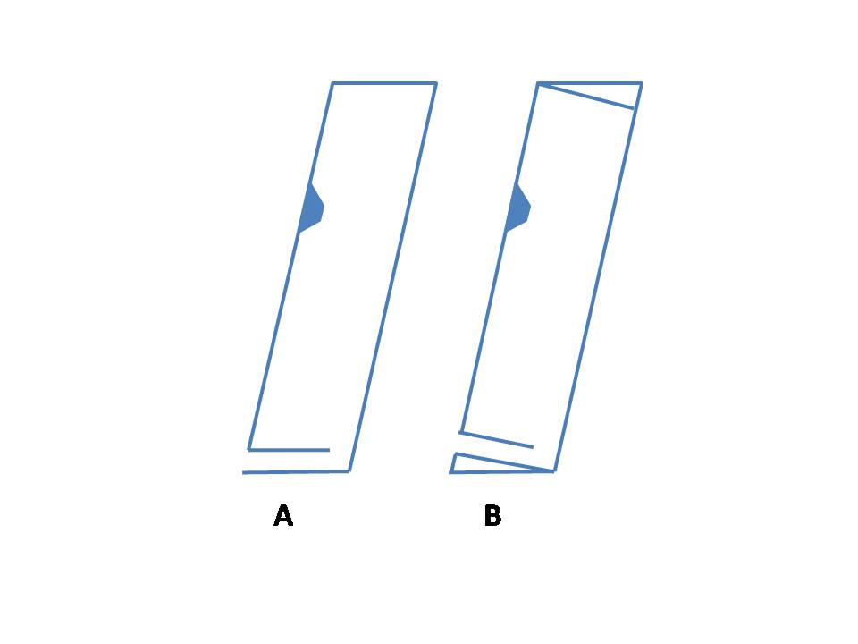

I see no reason why not. Indeed it's a good idea if you plan on putting it on the floor because more of the HF lobe of the driver will be directed at ear hight instead of reflecting/being absorbed in the floor.
The only slight problem could be that the port doesn't get as much floor loading.
You might put the port on the front of the bottom to compensate though, but that would call for a good amount of tilt (at least get the port 4 or 5 cm of the floor to not affect the tuning).
on the posn of the port: I would advise anyone to avoid a port on the front for full range (or 2 way) because of the midrange output that will be there (incl port resonances). I had a BR with an Alpair6 with the port on the front, and imaging was not as I expected, putting some damping in front of the port did solve that
slanted TABAQ
Thank you Squeak, turns out that slanting looks like to improve staging, silly me 🙂
referring to xrk971 and upright TABAQ , which version sounds best? are there any trade off?
thanks
Ide2003,
Are you asking if the Tabaqube can be slanted? It could but construction would not be simple 90 degree corners anymore. Acoustically, if you follow design guidelines of keeping cross section and path length, driver location and venting cross section and length it should all work. Angling straight Tabaq does aim sound up from rather low position if they are on floor.
Xrk971
