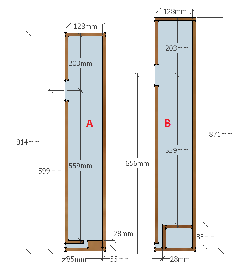

GM, the 3" TABAQs are usually port tuned at about 55Hz, a little lower for the 4".
The slot vent area is 16cm^3 and 9cm long.

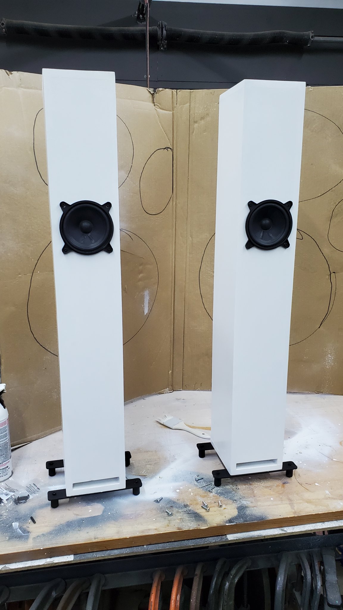

Shouldn't be a problem. You could get two small mono amps, but that would also means two power cords, one for each cabinet.Hello, did anyone manage to put a small (class-d) amp inside the Tabaq cabinet?
(I know there are amp sections, but i am interestes in this particular build.)
Or place a stereo amp in one cabinet and you would only need one cable going to the second cabinet.
As you'd prefer.
I'd avoid placing the small amp boards on the "roof" of TABAQs. That's where there's the biggest build up of pressure. You better stick in on a wall, between the driver and the vent.

Also, if one use Plan B there is some unused space for a Class D amp.
