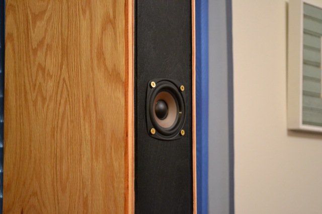

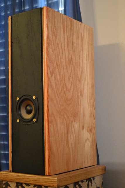

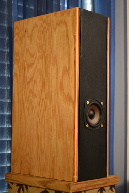

Was able to get these finished these for my sister, before the change.
TangBands that were on clearance from PE.

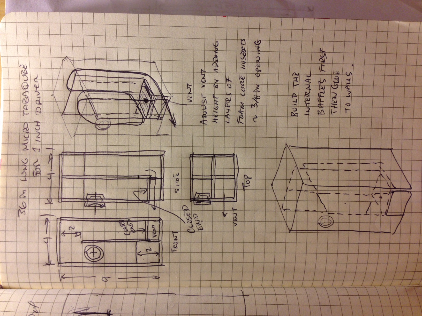

I built a micro Tabaqube with a 36 in pathlength (4 x 9 in) and 4 square inch cross sectional area to use with a 1 in driver from a small MP3 speaker/player. These player I have utilizes an LM4871 3-watt (mono) amplifier and also contains a microSD mp3 player, a rechargeable Li-ion battery, and a 3.5mm jack for connecting your external sound source (iPod). I wanted to make it small and portable, and I wanted to make fast and cheap. So I ended up using the foamcore paper board (poster backing) as the speaker housing material. You can make this in a hour with just an X-Acto knife, a ruler, and a hot melt glue gun. Anyhow, I made each quadrant have a 2 in x 2 in cross section, and there are 6 turns to the TABAQ - basically it looks like the 3d transparent drawing from my earlier post for the TABAQUBE but looks stretched out since the footprint is only 4 in x 4 in instead of 9.5 in x 9.5 in. I stuffed it pretty tightly with polyster fill from an old pillow per Bjohanessen's recommendation of about 2/3 the length from the closed end. I put some wire inside before sealing the unit off with glue on the top lid. For the vent dimensions, I was not sure how big to make it because this is so far from the parameters of the original TABAQ, so I made provisions for having an adjustable slot width by adding more foamcore inserts to tune the sound.

Micro Tabaqube for 1 in driver
Here is the plan for the micro 1 in driver Tabaqube. There is no simulation here so YMMV. Add VERY LIGHT (circa 2 to 3 grams of polyfill teased out to form a soft loose amount in the first 18 in of the line) stuffing to the first half of the transmission line. Too much and there will be no bass response. You will have to manually adjust the vent gap by adding or removing little slices of foam core until it sounds good. I would have modeled it if I had T/S params for the driver.

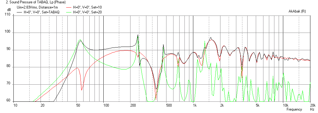

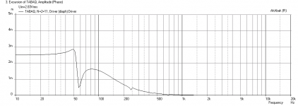

I have a similar problem with a Tabaq (3W-871) i built, it sounds a little flat. Could be something with the stuffing or with that it isn't airtight. Would it be better with a different speaker, say W3-1878?
I put the stuffing around the wall, should i fill it up instead (this is my first build so a friend who helped me said it would be enough)?
I haven't tried any real sealant but used glue to attach the sides to eachother, but maybe this isn't enough?

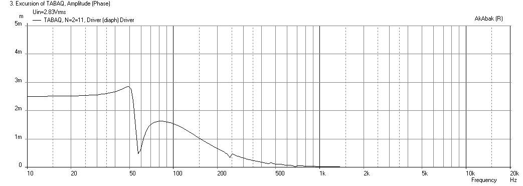

The W3-871 sims pretty well in a Tabaq. As you can see, it should reach 55
Hz. However, the max displacement of 0.5 mm may cause problems as about 1.5 mm is needed to reach 80 Hz at 1 watt. Maybe this is cause of why it sounds flat? Max excursion is being reached? Try another W3 driver with higher xmax if you have one. The Vifa Tc9fd has xmax of 2.5 mm and can be swapped out with bigger cutout.
