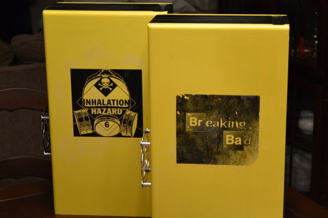

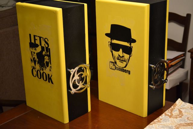

TABAQ TL for Tangband
For "Breaking Bad" Fans - Can't get enough of TABAQs!

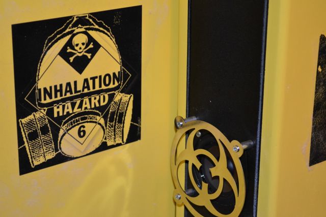

Folded TABAQ design from Bjorn Johannesen.
Driver - Tang Band - W3-881SI
Cabinet - 1/2" MDF
Finishes:
Yellow - Oil Based (4 coats) Primer (3 coats)
Black - Truck Bed Liner Paint
Decals - Acrylic Gel Medium transfer technique off of laser prints
Speaker Grills - Bio Hazard computer fan grills - 92mm.

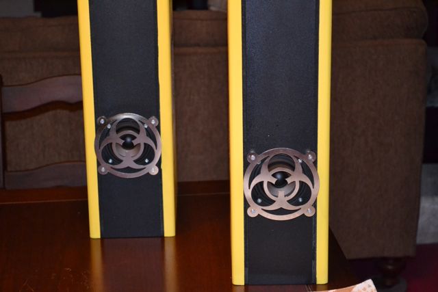

Finished a pair of folded Tabaq speakers with the Tang Band W3-1053SC 3" FR driver.
I am impressed! 🙂
Don't have the BSC installed yet, but placed them close to the back walls of my room, and playing them with my Tubelab SE - most of what I have heard sounds good - Dire Straits, Roxette, some instrumentals, even some electronica. I listen around ~70 dB most of the times, the speakers do a fine job.
Bjorn, I know this is late and already hundreds of Tabaqs have been built, but thanks for coming out with this simple and elegant design for the DIY community. 🙂 It extracts a lot of performance for modest drivers.

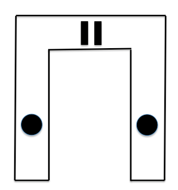

I followed that thread when ryani was building, good stuff - when I get my hands on some more budget 3" drivers I might give it a try. Probaby will try a 2 driver/cab version with one of the drivers mounted on the side.Basically keep line length in tact, double the Vb and place another driver 90 degrees to the one on the front baffle.
Liangan, recall a post on this thread thread stating that 4" drivers should work - maybe you can share the specs of the MA driver you have in mind so that Bjorn or others can comment? The Tabaq design is pretty flexible and actually a good number of different drivers have given satisfactory performance in the cabinet - check the recommended specs (Fs, qts and Vas) for the design.
CHR70.3 metal cone in MLTL

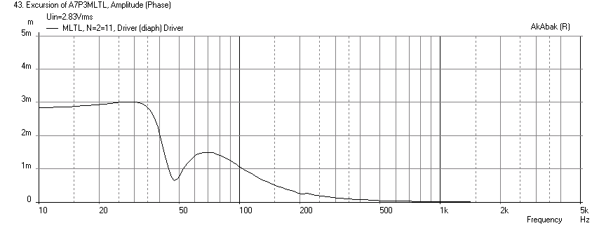

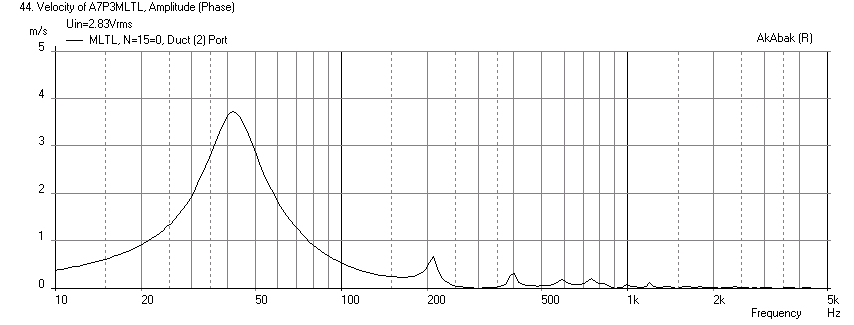

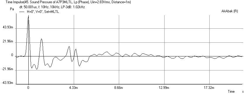

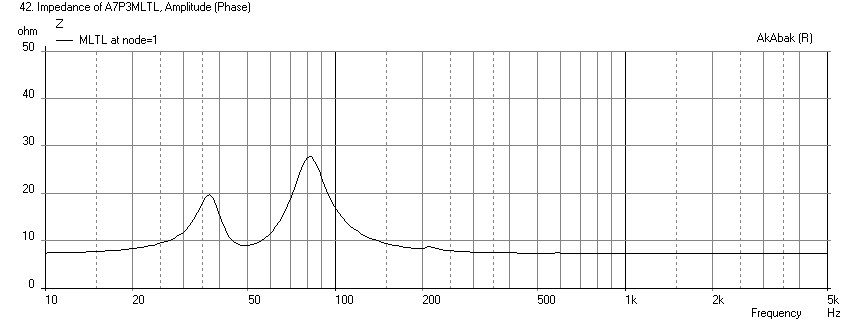

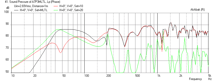

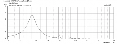

I am not sure what the 90 deg aligned drivers will do - you will not get a true bipole and the stereo imaging may get diffused. A sim with a single CHR70 shows that it is significantly different from the 3 in or 4 in Tang Bands in that it can reach pretty low into the 40 Hz almost with a slightly longer 34 in line with an 22 sq in cross sectional area and a 3.85 square inch x 7.5 inch long vent. This is for 1 driver. Double CSA and Double the number of vents for two drivers. Here are the results for a long flat MLTL that is 5.75 in wide x 3.7 in deep with the vent pointing down at the floor and driver mounted at 1/3 distance from closed end and position of driver is 40 in above the floor. The dips at 150 Hz and 350 Hz are dependent on room placement.
Plots are as follows:
- Freq response 1 watt at 1 meter
- Impedance
- Cone displacement
- Impulse response
- Port velocity
