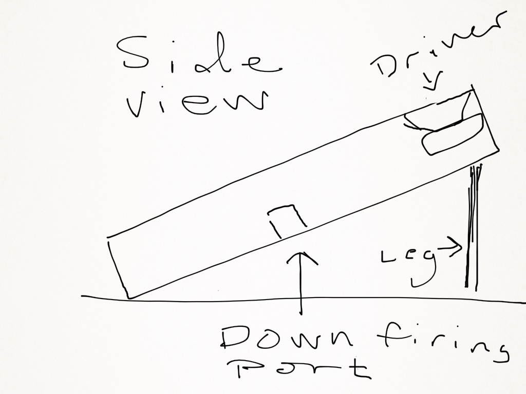

First I thought about to make them kind of omni/up firing by bulding the side ported version and mount the driver on the opposit side of the vented side. Maybe a little bit up tilted at the far end of the speaker, this would tilt the drivers slightly towords the lisstener and give to port some room to breed (but not to much, so that port couples nicely to the floor. What do you think about this approuch? I will use faital pro 3fe22 and I think they sounds better slightly off axis. Hope you get what I trying to do here, if not I'll make a drawing (probably uggly drawing) of what I mean.

Some thing like this. Driver facing upwards in an angle and port coupled to the floor.
Looks like a waste of space to be frank. Just slant the top instead. The port should be at the end and always very near (ca. 2 - 3 cm) a boundary.
I don't think it would make a big difference. For 10 cm the new cross section would be 10 x 18,85 cm. If you go too shallow though (I think 10 cm is about the limit if you are using reasonably thick material) it will introduce artifacts.
