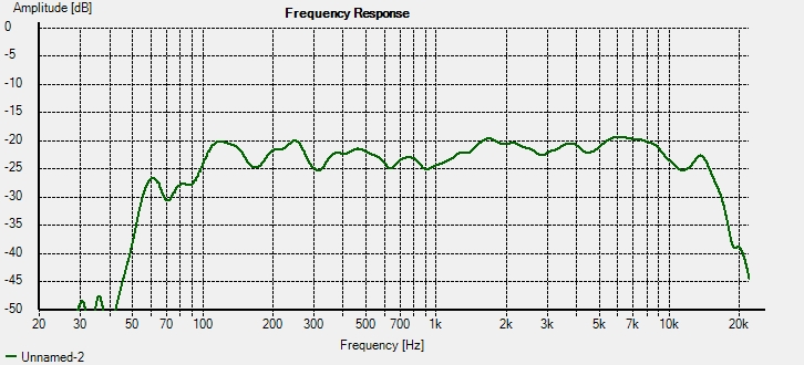

Here is rough measurement of Vifa TG9FD frequency response. Measurement distance 35cm on axis, TABAQ in front of open bookshelf. BSC 1mH + 6R8.
FR smoothing 1/6 oct. Below 100Hz the vent is too far from mic to give correct results.
Depending of final placement the BSC might still need some fiddling.

Hi Bjorn,
I can try to make near field measurements, maybe 10cm is ok? My mic is ECM8000 with the general calibration file, so there can be some tolerance issues especially at 8..15kHz range.
I was little surprised how strong BSC filter was needed, but of course the placement directly to wall will change situation somehow.
Below 100Hz, the real room response seems to be pretty flat down to 60Hz, dropping ~5dB @ 50Hz. Very close to your simulations. It is just that the far field FR measurement below 300Hz in normal room is real pain...
-Erkki

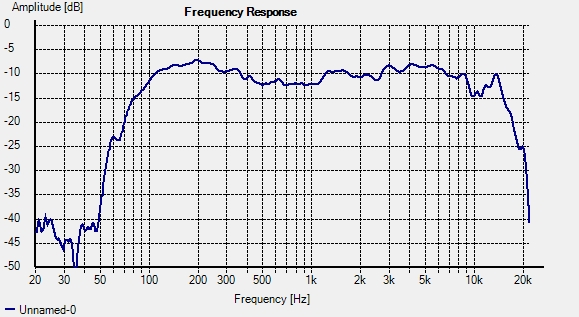

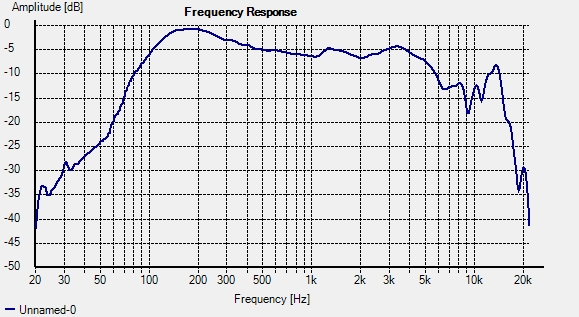

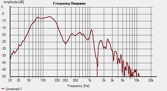

Today some new measurement results, with same BSC (6R8 + 1mH).
First two from left: distance 10cm
Next two; distance 2cm
Last one in the right: distance 10cm, no BSC.
Smoothing in all 1/12oct.
TABAQ box was 30cm from floor, and the driver is assembled 3cm higher than drawings suggest.

Hi errki1
Interesting results. Measurement of the speaker is often measuring the room instead of. Sometimes just sin tones is a good way to get an idea of how low the speaker is performing.
I sims I have done, there is a loss in bass when your lift the speaker from the floor.
