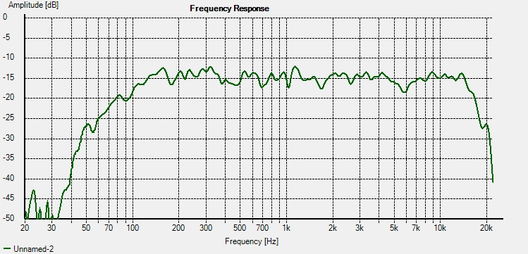

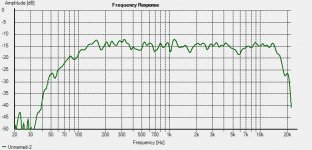

After some measurement sessions and BSC simulations & modification the result looks like that. Bass response is much better in reality, as the measurement was made for the mid/high range. Mic distance 40cm.
Now I can say the TG9FD really sounds very good.

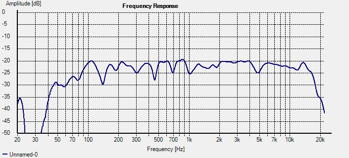

I can see three main reasons, first the distance: mic-driver 40cm, mic-vent 70cm. Just taking mic to 1m distance, shows quite different result. See the result here.Not sure why your bass is not showing up though, the Vifa in a Tabaq should hit 60 Hz easily.
Also, the speaker was approx 1m from the wall, so no bass lift from there. Then, I may have stuffed the box little too much (110..120g, material from Biltema ), but these drivers have higher than specified Fs, maybe also Qt. I think I should study REW or ARTA a little and measure T/S parameters to check.
Do you think these are even close to correct asumptions?
Your first curve "merely" confirms the manufacturers own datasheet.
Fs at around 110 - 125 and the bass rolloff looks almost exactly like the official naked driver measurement, so the Qts looks to be about right.
If it's not too much bother it would be interesting to see a measurement done at a proper distance for integration and/or the port alone and you didn't do it already up against a wall and with less stuffing.
I think it would do much better.
Edit. Measuring Fs seems to be kind of a black art with a lot variability. Just look at the original Tangband W3-315E. It's curve is the same or slightly "worse" than the TC9, even though it's marketed at a Fs of 100. MarkAudios CHR driver has measurements with the rolloff starting at approximately 100 Hz (it is a slightly larger driver), with the impedance peak at a somewhat lower point though.

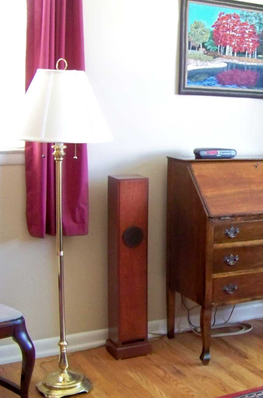

The design is exactly the original for TB, but elevated with 15cm high base from the floor. I will take some stuffing away, although the box is glued together so it can be slightly challenging..
