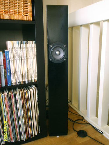

This is the best-easybuilt speaker with Tangband W3-871 or
like mine W4-1320!
Excuse my ignorance here - but would putting in the larger driver mean the dimms need to be changed? For example, the front of the speaker is only 10mm wide - same as the driver.
Cheers
Nickel, i started with the W3-871 and then just enlarged the hole
to fit the W4-1320, its tight but it works.
Nothing else need to be changed.

G, there is no need for an tweeter.
The sound is very similar to W3-871 except that
here you have the bas!
Very good sound
I run it true an an cheap Matsui DVD player with DAC in the box
and AMP 6 Basic.
Im very satisfied!!

Hi Solve. Do you have the ports in back? How far from the wall are you running the speakers? Also are you using a subwoofer with them? Very nice job.
Solve said:
Gavin,i have the port in front and something like 40-50cm from the wall.No need for subwoofer for my taste.
Solve
