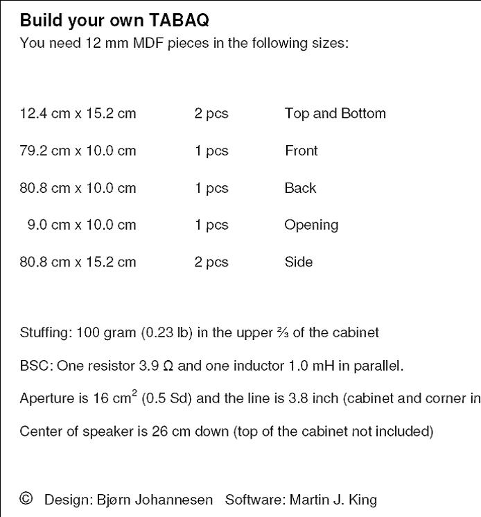

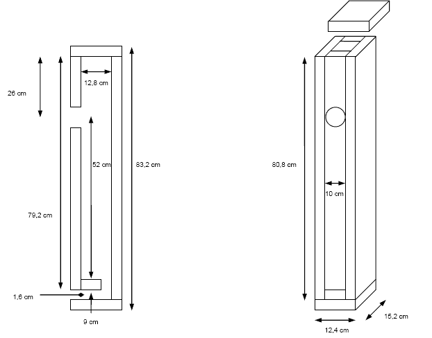

I just cut the 3-d drawing with dimensions from the PDF for you.
See below.

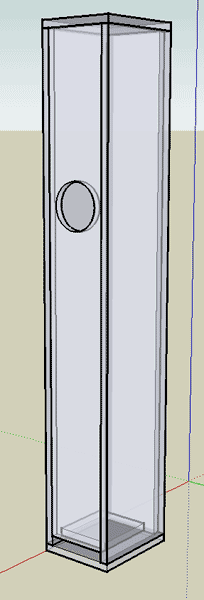

planet10 said:
I've been tempted to do a SletchUp of this for awhile... here is a snapshot...
dave
Hi Dave,
Lots of arrows on the original drawing going every whichaway.
Can you give the _area_ of the port in cm? I'm doing a sample from
stock on hand and the way this MLTL will be finished off is with
a round port exiting the bottom. I'm using 2" inside diameter PVC.
