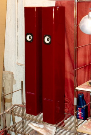

"extended" tabaq with Vifa TG9s
pics:
these are 1 metre tall, using 16mm MDF; the extra space is completely filled with Quarz sand. They're damn heavy!
The drivers are not flush and they're not fixed yet, as the finish needs to be completed with 10micron paper, maybe some more "patching", 2-3 coats of gloss varnish and then polishing.
Bret
pics:
![2809430_6256b2c636ea98898712e083bc7a7f94_standard.jpg](/community/proxy.php?image=http%3A%2F%2Fwww.23hq.com%2F23666%2F2809430_6256b2c636ea98898712e083bc7a7f94_standard.jpg&hash=9f49cfa3b057e0b43e757d96facb61da)
![2809429_998ba0f16ac4dc0ab642b2f4be39b94a_standard.jpg](/community/proxy.php?image=http%3A%2F%2Fwww.23hq.com%2F23666%2F2809429_998ba0f16ac4dc0ab642b2f4be39b94a_standard.jpg&hash=9360772c6734e8d5e5d7f109fc6d2233)
Bret
