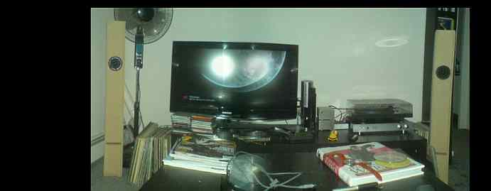

I've got about 20 hours on them now. Bass is definitely heavy w/o the bsc. With it the bass becomes rather remarkably airy and transparent. The hollowness of a kick drum is really conveyed, same for a bass fiddle.
The little paper woofers (very glad I went with the paper ones) can produce enough high freq. Despite my initial concerns. I do feel the bsc is overattentuating though, I'm going to try and get to the shop to buy some more resistors so I can play with that...

These look like a good option for a fist build, but i'm concerned with them not being able to play loud enough. Ray, how have these performed SPL wise? i know you were concerned with maximum volume too.
and/or is there anyway to incorporate another driver into each? i was thinking about using the 4" ones, but if i could drop in 2 3" or even 2 4", then it seems that reaching sufficient SPL levels wouldn't put too much stress on the drivers.
