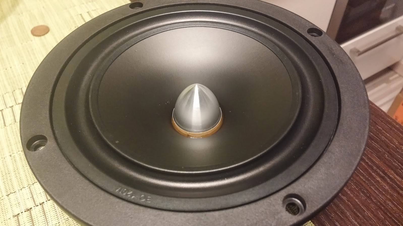

Just assembled a TABAQ box variant with dual Tymphany TPY03W012o 12-ohm drivers in parallel. Xmax is rated at 2.5mm, which is plenty with dual drivers rated at 30W each.

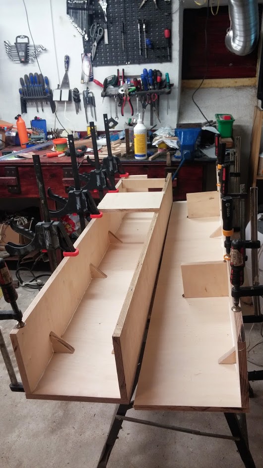

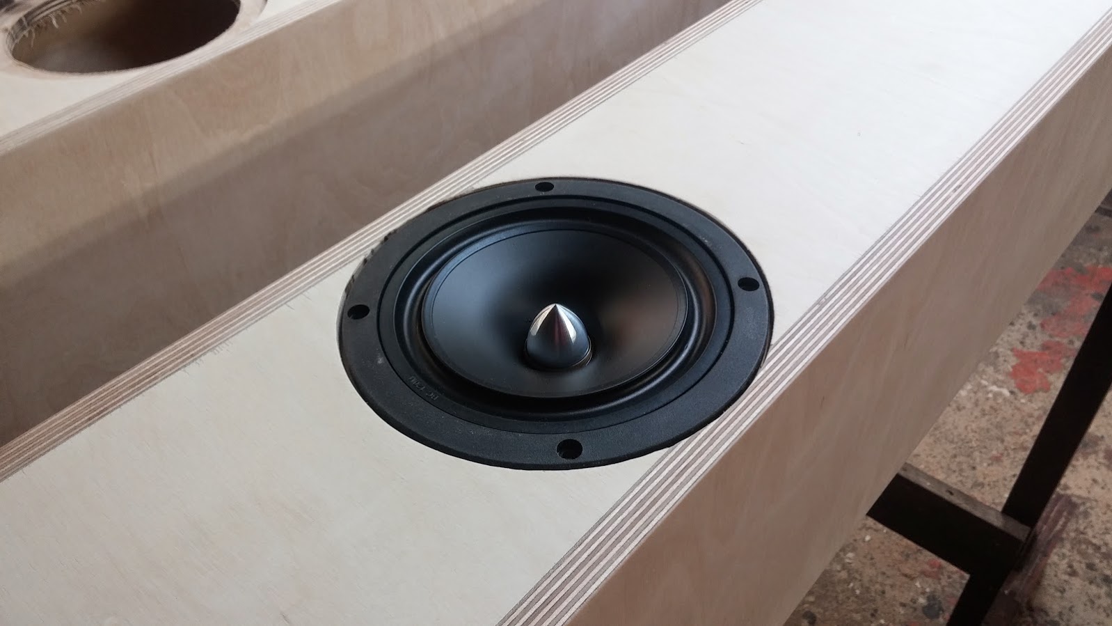

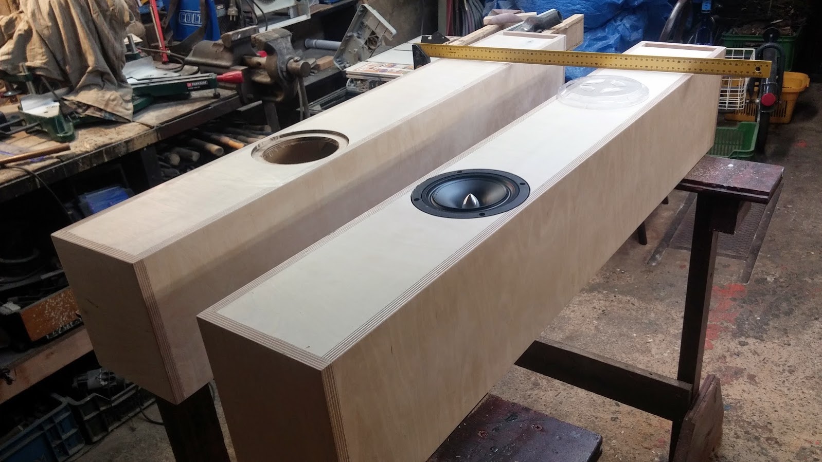

Here are pics of the prototype:
Dimensions are more or less the same as the Tabaq box, with a second driver cutout about 104 mm above the first.

I think for double the speakers the volume of the cabinet should be double, and the port area as well. How does it sound anyway, do You like it?
The original TABAQ was designed with cross-section and volume for the 4" Tang-Band with larger effective area (Sd) than the 3.5" Tymphany that I'm using. It is a happy coincidence that the stock TABAQ works fine for a fairly large range of cone diameters, ranging from about 3" to 4.5".
In this case, it sounds better with 2x 12-ohm Tymphany drivers than with 1x 6-ohm Tymphany driver, probably due to smaller cone excursions at any given power level. The lower-end bass extension also has more authority. I'm using a BSC network of 0.75 uH || 5 ohm || 0.47 uF, and this may well need further tweaking by trial and error to get optimal sonics with these drivers.
@Perceval: Thanks, however the credit goes to the (professional) cabinet fabricator. I just gave him Bjorn's plans with my penciled changes for dual drivers, cloth baffle, etc., and just waved my hands around for some other stuff, and he just did the stuff perfectly. I only assembled and soldered the drivers, BSC network, connectors, etc.

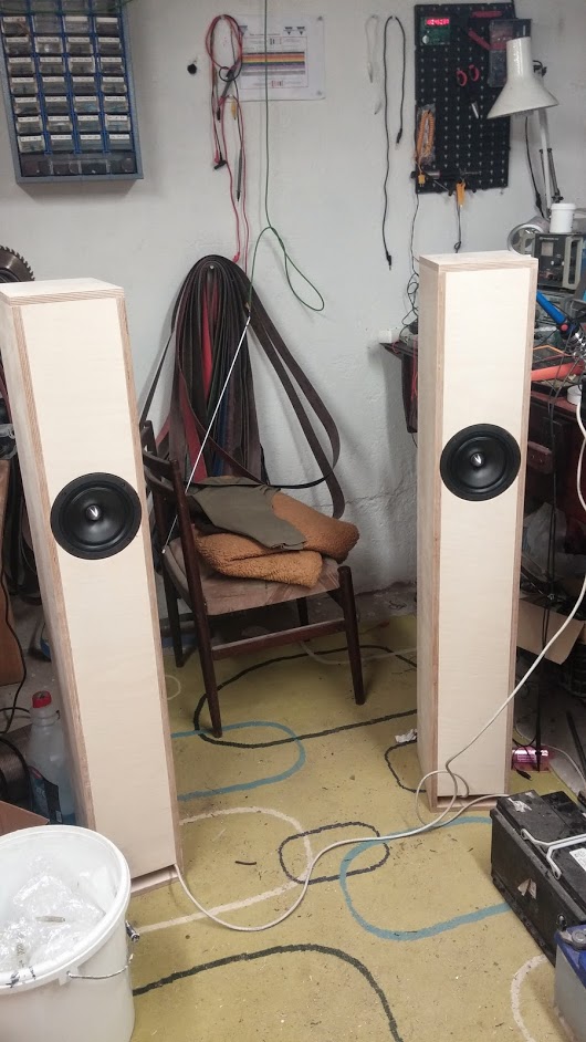

I just tested TABAQ with Visaton FRS8.. Great sound from this small speaker.....

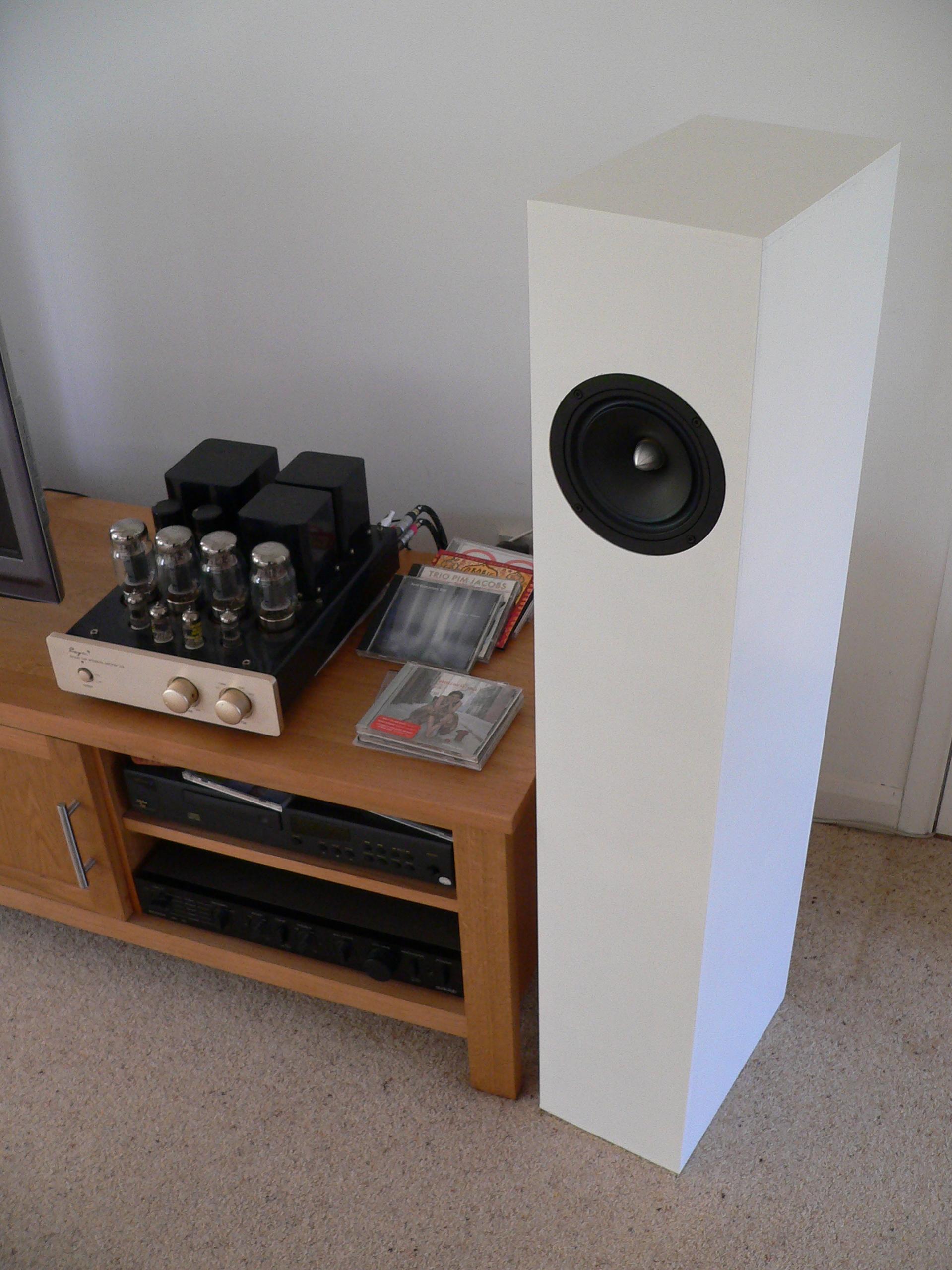

On the subject of TABAQ speakers: I posted some pics of mine which used W5-1611SA drivers. Could I stop at that? No. I have swapped the 1611s for W5-2106, a development of the 1611, from Blue Planet Acoustic TangBand W5-2106 Wide range speaker | DIY and they are now even more amazing.

Hi Danzz, the W5-2143 looks very interesting. I have used the similar W-2106 from Blue Planet Acoustic in Germany in my TABAQ they are a great improvement on the previous W5-1611 on which it is based (no mention of it on the TB website). Paper cone rather than polypropylene seems to give a warmer sound. My base is quite good in my enclosures (can't seem to upload a photo)
