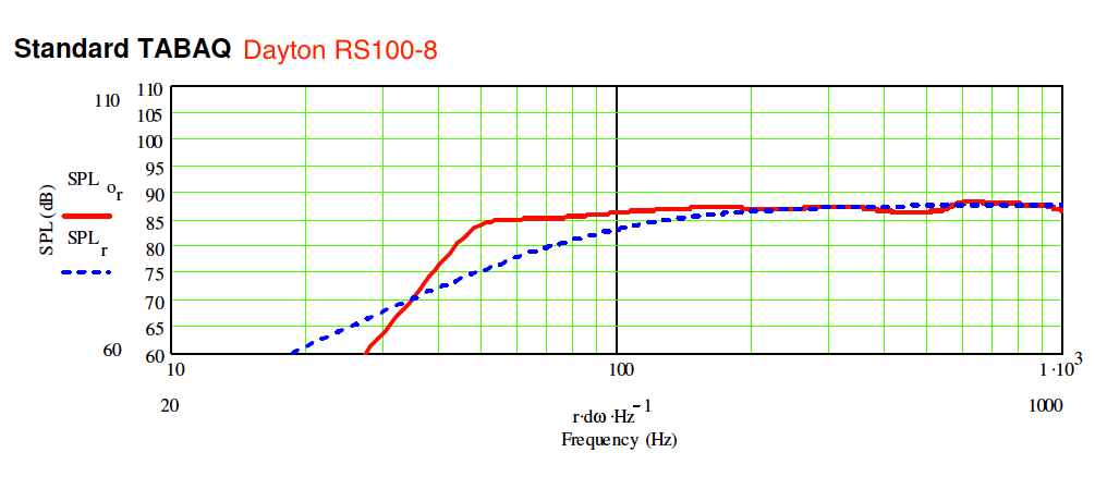

After reading much of this thread, and some reviews of the Dayton RS100-4, I've been considering a build of a TABAQ type cab.
I have a couple of questions regarding the choice of driver, and the tuning of the line.
Wouldn't the use of the Dayton mentioned above require a lengthening of the line to get full bass performance from that driver, who's Fs is considerably lower than the 3" drivers the line was designed for. ( 87 vs 110 Hz. )
That Dayton driver has a cone that is very similar in size to the 3" drivers recommended for the enclosure, but it is slightly larger, would a slight increase in cabinet Sd be in order? I have no idea what change may be needed to the port.
In the past when I've built TL type enclosures, I've "tuned" the bass to taste by varying the stuffing until I was satisfied with the amount and quality of the bass. I've never had the benefit of Mr. Kings simulation software to suggest a good starting point though.
I seem to recall Mr, Johannesen tuned the original TABAQ to about an octave lower than the Fs of the driver. That would make a line for the Dayton needing to be tuned to 43-44 Hz. wouldn't it?

No, you don't want to or need to change the length as it is a mass loaded TL which means it uses the port constriction to pull the tuning frequency lower than the natural 1/4 wave frequency of the TL - and it requires a driver with a moderate Qts to allow low frequencies below fs to be reached. 55Hz is about as low as you want to tune any 3.5in driver. The design is quite flexible to various drivers and this one is right in the ball park to keep things the same. You may need to tweak the BSC and adjust stuffing to taste. The RS100-4 is a great driver - you may also like the Dayton PS95-8. Other ones to think about or try include Faital Pro 3FE22 and 3FE25, Dayton RS100P-4, Vifa TG9FD, and Vifa TC9FD. All should work reasonably well and the Vifa's will give you the flattest frequency response and smoothest mids. The PS95-8 will have the brightest HF presentation but have more of a cone breakup. Basically any 3in driver from the Subjective Comparison thread can be used.

Hi mightym xrk971 is absolutely right.
For a long time, this was the candidate for Kvart & Blge, Audiophile Quarter Wave Full Range Loudspeakers
It will work perfectly in TABAQ. I did several sims to see if there was a better design for this driver, but got to the conclusion no modifications would be needed.
Please take a look at the simulation attached.
