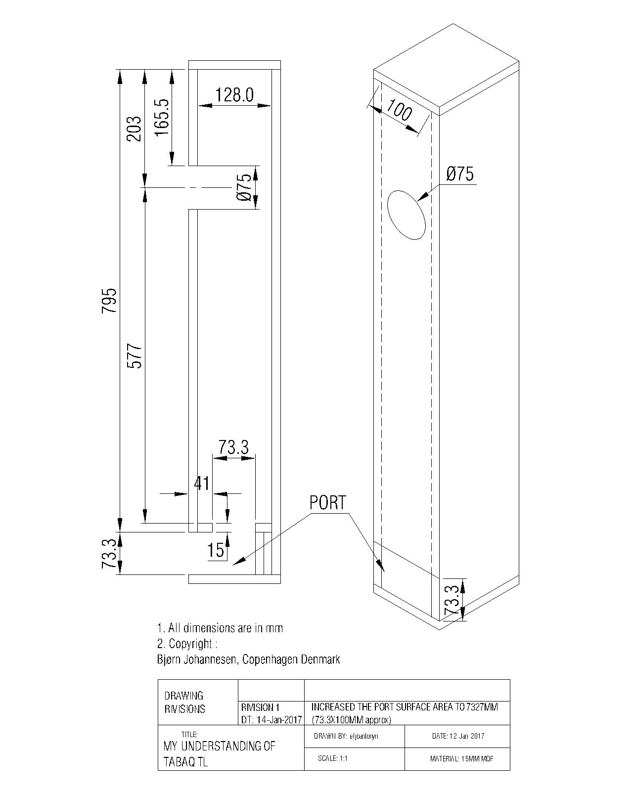

The nice drawing! can be used for 3 and 4 inch.

Can you please answer these questions ?
1.How much inside length for the enclosure your recommend for more SPL ?
2. You said 3.8" (96.57mm) aperture for the port. But there are no PVC, Mild Steel bends readily available in that dimension.
But, for the dia of 3.8", surface area is: 7327 mm2.
So, if we use a rectangular port of the same area, would it be suffice ?
If so, a 100x73.3 mm hole (7327mm2 area) cut at the bottom should work, right ?
3. Is the length of the port important ?
if it is, what should be length of the port ?
4. Also, should the port face the front (so the port tube in an "L" shape) or is it ok to be down firing ?
If down firing is ok, then how much clearance we need at the bottom ?
Sorry to ask so many questions 😱
I'm Mechanical Engineer and I'm used to having full data available before committing to anything, became a habit .😀
Looking at recently posted plans the port length is supposed to be 9.7cm so you could just recalculate the path length to this dimension using 19mm ply.

Thanks for the heads up...I just didn't saw the port dimensions until you mentioned it here.😛
BTW, please don't make a TABAQ based on this drawing as its still a work in progress.
The lengtjh of the port is 9,7 cm and the area / cross section is 16 cm2,
The port is an extension to the line and could fire downvards. I have tested distance to the floor 5 cm and this worked well.
Bjørn
Thanks for the reply !
So, the port dimension should be 1.6cm X 10cm !!
I'll correct the drawing and finish it and start planning the build.

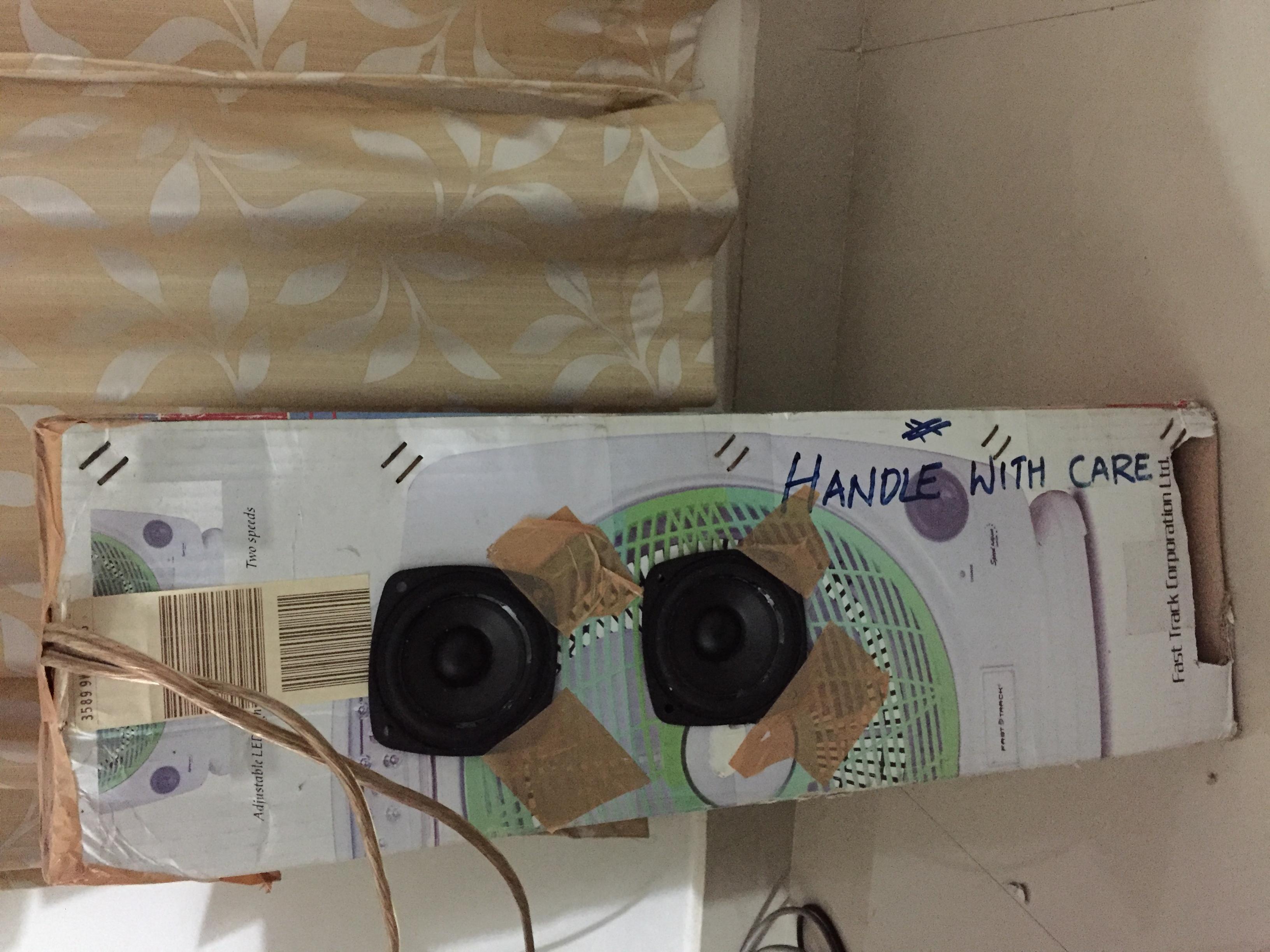

By the way, I got the drivers today and did a listening test by placing it in a cardboard box. It sounds decent but the lower part of the treble and bass were missing. I can understand the bass but misssing treble...may be I will should add a dome tweeter ?

Marc, I think your plan to fill-in the lower end with a sub is a great approach. At the moment I am listening to my TABAQ's, loaded with the TC9FD and supported with a single 8"sub, RSS210, (25-80hz)... I thoroughly enjoy it! Listening to sweep tones, the TC9FD in the TABAQ reaches down to a solid 50 hz but I still prefer the support of a sub.
Pete
It's early days yet. The driver cone and spider must be stiff. Besides, a leaky and lossy cardboard box is hardly the proper enclosure to assess driver performance! 🙂
Try putting the drivers in separate boxes of smaller size. You don’t need to cut any vent.
You have to break-in the drivers first. Start at low volume and increase it as you put in more hours. By the time your Tabaqs are built, these drivers will have broken-in somewhat. You can decide whether you need to add tweeters after you've listened to them in the Tabaq enclosures.
And yes. As you’re planning to use 15 mm thick material, don’t forget to chamfer the back of the driver holes to allow the drivers to breathe.

Copy that !🙂
I put them in two cardboard boxes and I must say the mids and treble is :eguitar: very bright and lovin' it 😀
No need for tweeters 🙂
But the bass is non-existent though which I can understand.
When I compare it with existing floorstanding speakers, these little guys are very clear (male voices are superb) and have that "sparkle" at the top end.
If I had a sub, I would have left them in the cardboard boxes and called it a day 😛
