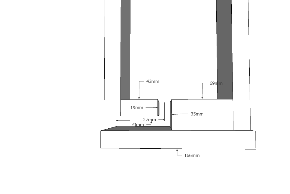

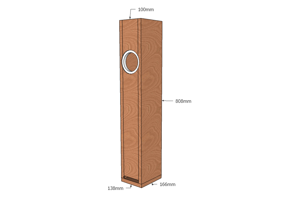

I played around a bit with sketchup. Does my dimmensions look correct?
All boards are 19mm thick. The center line marked inside the vent is 97mm long.
The front baffle is 792mm long and the driver center are 203mm from the top.
I left out the top panel on purpose.

I think your port dimensions are a little bit off (the port length should be 9.7cm and its cutting dimension should be 100 x 1.6 cm) but I'm a n00b when it comes to TABAQ. So, let the experts comment on it.

With 19mm material vs 12mm, baffle length should be 792 + 7mm. As the 43mm part intrudes 7mm further "up". Sides and back panel also longer by 7mm.
It's a minor thing..... stuffing, BSC and placement in room will have a greater effect.
Thanks, didn't think about that. I'll make new drawings with corrected height.

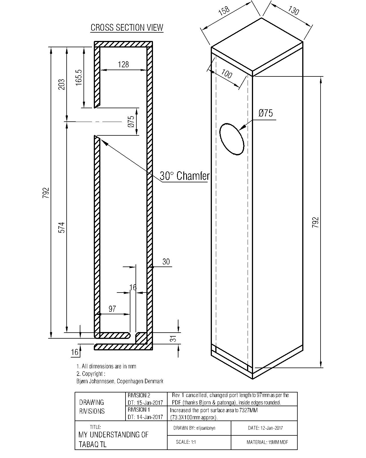

Eljoantonyn: the port is 16 mm high and 100mm wide. Is it wrong to measure port length from the center of the port?
Not the most accurate according to some "studies".

Sorry to say, I still can't "get" Bjorn's drawing
May be I'm used to well prepared engineering drawings all my life and just couldn't digest this one
Anyway, I did one more drawing and I hope this one is correct.
Please comment !!

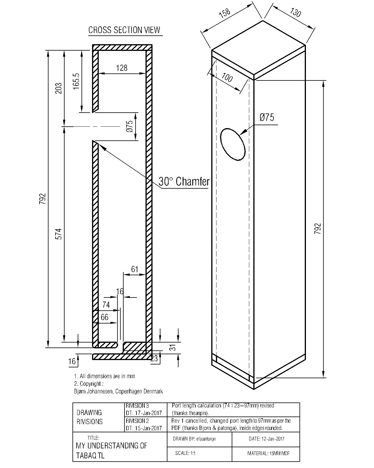

Port length is still off, you need to take the "shelf" height into account. 97mm is the full length if you draw a folded line through the center of the port. If using 15mm material the imaginary line should be 23mm (vertical, 15mm + 16mm/2) + 74mm (horizontal).
Thanks for spotting the mistake !
So, the horizontal distance should be (distance from front of the box to the port center) = 74mm
And the Port top to port center= 23mm ?
So, how about this drawing ?
I don't mean to split hairs here, but the chamfer in the drawing is actually a bevel as it leaves no parallel material on the radius face. While this may not generally be an issue, with these smaller drivers, you may run short on material for a mounting screw to bite into. You may want to consider allowing the chamfer to end further away from the front face so as to leave ~8mm of parallel surface material on the radius face (hope that makes sense). This would also allow you to use a steeper chamfer angle and not risk a "blow out" of the screw hole (which should be pilot drilled, of course).Thanks for spotting the mistake !

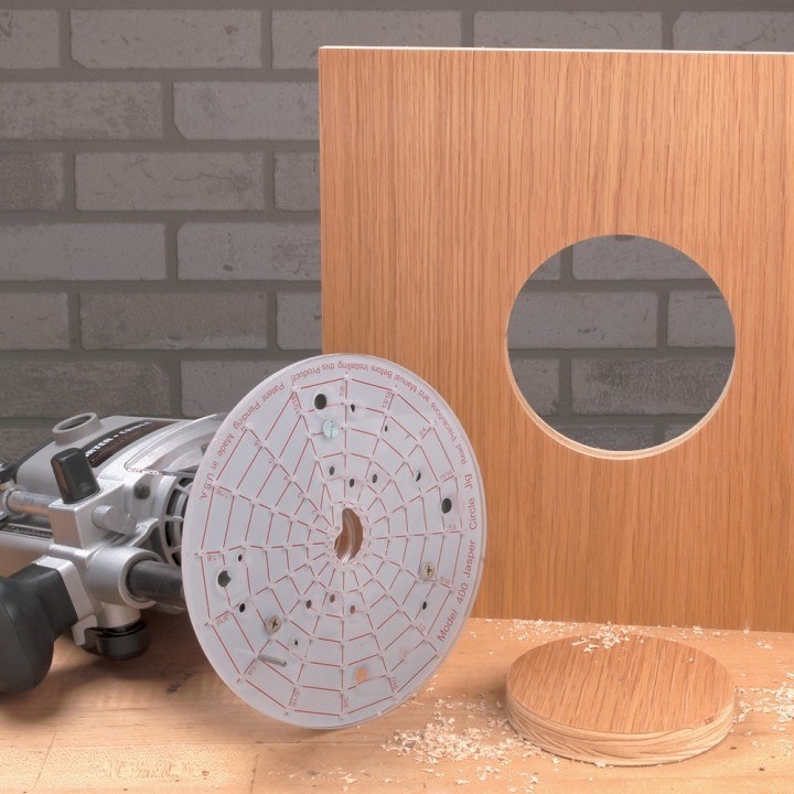

My thoughts exactly. I cut the parts for two speakers on my table saw in about fifteen minutes. Routed the speaker holes and chamfered the driver relief in about ten minutes.

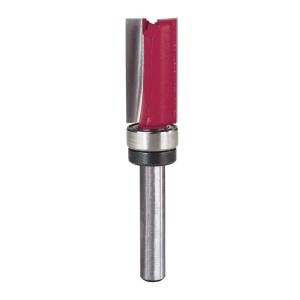

I made a template for cutting my driver holes using a Jasper 400 circle jig to cut a 3-1/16" hole in a scrap of plexiglass. I hot-glued my template to the mdf and used a top bearing router bit to cut the holes for my drivers. Then I used a 45 degree chamfer bit to cut the relief for my drivers.

The 75mm hole with chamfered edges shown in the drawing are just for indicative purpose ! The 3" TB driver I have doesn't need a 75mm hole.I don't mean to split hairs here, but the chamfer in the drawing is actually a bevel as it leaves no parallel material on the radius face. While this may not generally be an issue, with these smaller drivers, you may run short on material for a mounting screw to bite into. You may want to consider allowing the chamfer to end further away from the front face so as to leave ~8mm of parallel surface material on the radius face (hope that makes sense). This would also allow you to use a steeper chamfer angle and not risk a "blow out" of the screw hole (which should be pilot drilled, of course).
sent from my mobile look-at device
IIRC, its mounting holes are at 72mm PCD. So, if I had cut a 75mm hole in there, the driver would...
Anyway, thanks for head up
