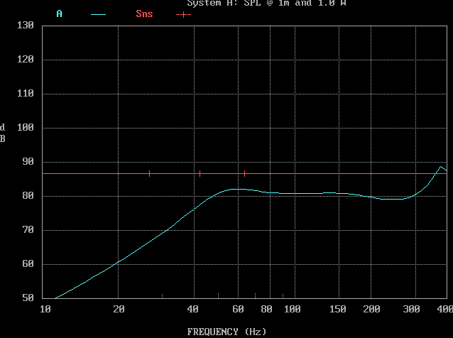

I fired up my favorite program for modeling bandpass subs quickly - bandpass boxmodel. I actually bought this program when I was a teenager, as mentioned above, was trying to reverse-engineer bandpass subs. Nowadays it's free.
Using a "textbook" bandpass we can get fairly flat response, as the pic shows. The efficiency is very VERY low though; about 82db. The box is impressively small though; just a hair over four liters! These MCM subs love stupid small enclosures.
The F3 is too high though; just 49hz. Not much of a "sub" woofer.
To optimize this sub I'd probably do what I did with the tapped horn - add a resistor to increase QTS, which will extend the low end response. The resistor will also make the enclosure size more manageable, as a five liter enclosure contributes to a ridiculously long port.

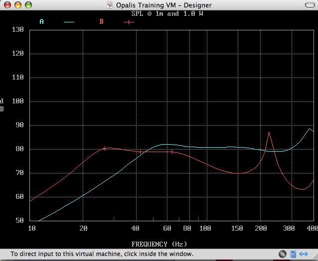

I'm really not trying to scuttle my own project here, but a one dollar resistor makes that MCM woofer VERY attractive in a bandpass.
I've attached a pic which shows the response of the SAME woofer once you bump up it's QTS to 0.6 via an increase in QES.
The difference is night and day - it extends the response a full octave!
Of course you need an enclosure that's five times as big, but that's expected due to the increase in QTS.
The bottom line is that you're looking at a $25 driver that can reach down to 25hz in an enclosure that's barely over a cubic foot.

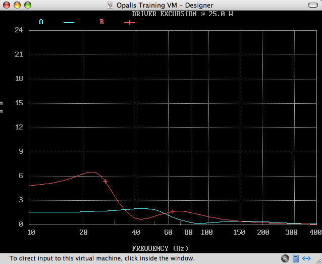

dammit, i'm really starting to wonder if I should build a bunch of these. Here's a pic of the excursion at 25 watts. Keep in mind we're not going to feed these with much power, since I'll be using a minimum of three.
