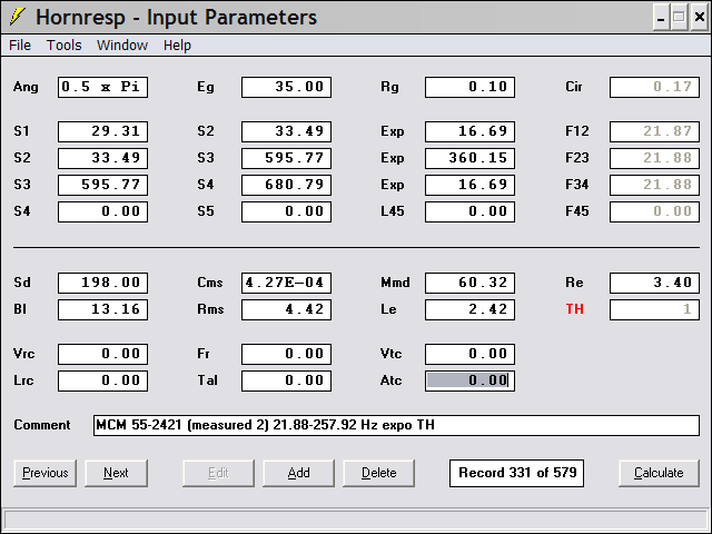

Hmm, while I agree that the 2421 has an excess of HF BW capability, I don't see that as a reason not to use it, especially since it doesn't run out of Xmax until the far side of 130 dB in the desired passband if it doesn't let its smoke out first, which is more than plenty for typical HIFI/HT apps. Pretty impressive for only a ~81.51 L net bulk! I've built 'bookshelf' speakers bigger than this.......
GM
Thanks for the additional insight. An exponential design sure smooths things out when compared to simple conic flares. I am still very much on the steep part of the learning curve with respect to tapped horns, so please bear with me. I have not read _all_ of the collaborative thread (though I do recall seeing you as a regular contributor), but try to get a few pages read here and there when I can.
The only real issue I have with the response of a 55-2421 in a tapped horn is the 5 dB step in response that is typically predicted around 100 Hz, which is right where my mains cross in. I am aware that the resonances predicted in Hornresp may not exist/can be altered through folding, but not all of the drivers I have modeled exhibit this step in response.

Indeed it does, though at the expense of gain BW for a given path-length. Not many 'free lunches' in sound systems design.
The stepped response is the price you pay for a small net bulk, i.e. there's only true horn loading in its HF BW. Design it as a max gain BW TH where Fs = Fc and watch it smooth right out, though now its size will be measured in thousands of liters just like a traditional 'ideal' bass horn.
Bottom line, as in any optimum speaker alignment you want to use the right driver for the app and if you can't find or mod an existing one to suit, then you either accept its trade-offs and work around them as TD does with his DTS-20 or rethink your system design.
IIRC 'JH' posted that while the HF 'ripple' wasn't nearly as bad as predicted, the folds didn't have much (any?) affect on them either like in a typical folded horn. Not surprising considering the typical driver-in-mouth TH designs that folks here seem to prefer.
No, my speaker design/building avocation for a variety of reasons has been on hold for many years now, so my postings are based on what I think I know about TL, horn, etc. design from prior experience and of course the much appreciated published efforts of others and last, but not least, rely on Prof. Leach's well proven math to calculate the throat, etc., values of any low frequency horn alignment.
Note that just plugging numbers into his math will probably not give you a viable alignment or even a decent starting point, especially WRT TH alignments, i.e. GIGO applies (garbage in/garbage out), hence the tiny throat predicted (the byproduct of a low Qes/Qts) would probably quickly destroy even a 'bullet-proofed' horn driver if used in a prosound app and probably cause audible distortion via surround deformation using a thin, high compliance half roll one, but the 2421 is robust enough for prosound apps, so I see no reason why it wouldn't be fine for a much less stressful HIFI/HT one. Only one way to know for sure though.........
