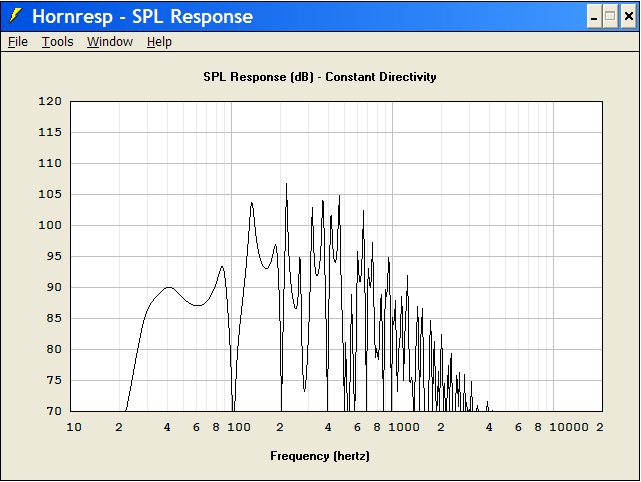

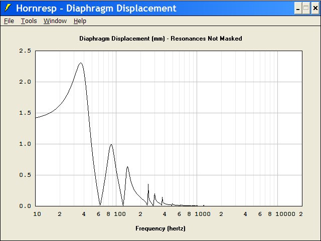

Last but not least, here's the most interesting graph of all. It's the exact same woofer, in a tapped horn, with a volume comparable to the bandpass.
We see two things:
1: The efficiency is slightly lower than the bandpass.
2: The Tapped Horn plays lower
In other words, it confirms what I'm hearing.
This is what I hate about physics! No free lunch DAMMIT!!!
We see two things:

One can get an idea what the TH can do so far as sensitivity compared to a normally loaded driver when you consider that the TH-115 has a 15tbx100 driver for example.
To the degree the sensitivity is increased, one see’s a corresponding reduction of excursion for a given SPL.

I've been crunching the numbers on bandpass boxes for well over a decade, and was quite excited to try a tapped horn as soon as I could. Based on my experience with this, here are a few observations:
- For a given box size, the efficiency of all alignments are quite similar. For instance, a bandpass and a vented half nearly the same response in the lower octaves if the F3 is comparable.
- You can shrink a tapped horn down dramatically. For example, the 15TBX100 can be used in a tapped horn that's one quarter the size of your TH115, IF you're willing to sacrifice efficiency.
- When the tapped horn is shrunked down to a dramtically smaller footprint, then you discover that a plain ol' bandpass offers an efficiency that's comparable - and a lot easier to build.
This morning I crunched the numbers on the 15TBX100 for a couple of hours, and ran into a couple of challenges. The first challenge is that putting the 15TBX100 in a bandpass box that's 10 cubic feet doesn't work too well. It's just needlessly large. On the other hand, you can shrink the TH 115 into a package that's comparable in size to a proper bandpass, but then the efficiency drops. It's quite a catch-22!

The problem is comparison. I can model BP, but not TH. You have measurements of a TH but not a BP. How to compare?
From your impedance curves the "gain" is obvious from acoustic loading driving the cone velocity to zero in several places (i.e. low electrical impedance.) This is exactly how the BP gets its gain.
As to the 1/4 wave tube being 90 instead of 180, this is only true above the first resonance, which will be the resonance of the lumped mass of air in the tube against the driver (or more appropriately the small volume of air in front of the driver). This is why compression drivers have two impedance peaks instead of one. Only a flat piston on a tube of equal area would not show this effect.
I just cannot see how a twenty to thirty foot wavelength knows that a horn is a horn and not just a duct. Compared to this wavelength the cross sectional variations are miniscule. The horn is a duct at the lower edge, the system acts as a dual bandpass at these lowest frequencies and then as the normal BP would fall off, the 1/4 wave resonances add to the response to bring the output back up. I see this all the time when I do bandpass designs where the ports get too long. The Bose wave cannon is really the ultimate design in this configuration (no credit to Bose, its an old idea that they simply resurected.)
Mc Bean's hornresp can model a number of enclosures that aren't documented.
For example, it can model single reflex bandpass. Just take the volumes of S1 through S4 and set them so they're equivalent to the area of the port in a bandpass. For instance, if you're modeling a four inch port, set S1 to 79.57cm, S2 to 80.57cm, and S3 to 81.57cm. You have to stagger them very slightly to prevent a divide by zero error.
Horn response can also model dual reflex bandpass. Set the port length in the variable LPT and the area in Ap.
The greatest reason to use hornresp for bandpass is that it can model pipe resonances and reflections better than anything I've seen. It also lets you juggle a lot of variables. For example, you can define a dramatically flared port, then examine how the flare effects the tuninq frequency (it makes quite a difference actually.)
Patrick Bateman said:For instance, if you're modeling a four inch port, set S1 to 79.57cm, S2 to 80.57cm, and S3 to 81.57cm. You have to stagger them very slightly to prevent a divide by zero error.

gedlee said:The problem is that Tom's measurements and your simulations look nothing alike. What's up with that?
I believe there's three reasons for this:
1: In the real world, the peaks predicted by horn response aren't as severe as the simulations predict. Considering the predictions indicate peaks that are a fraction of a DB wide, this isn't surprising "IRL."
2: Danley's measurements pick up an efficiency bump from being in half space. I really hope people on the main TH thread recognize this, because there are a lot of people out there who are expecting a 4cf tapped horn to play 12db louder than a vented box of comparable size, and that's NOT the case. Even Danley's white paper spells this out. This fact got lost in the main thread when everyone started doing their sims in 1/4 space and 1/8th space
3: I've been using box volumes which are dramatically smaller than Danley or the other people on the main TH thread. This yields much lower efficiency. I'm going that route because I'm using multiple small subs, instead of one big ol' "tower of power." In my home, with hardwood floors and a lot of square footage, multiple subs sounds a heck of a lot better than a single sub.
