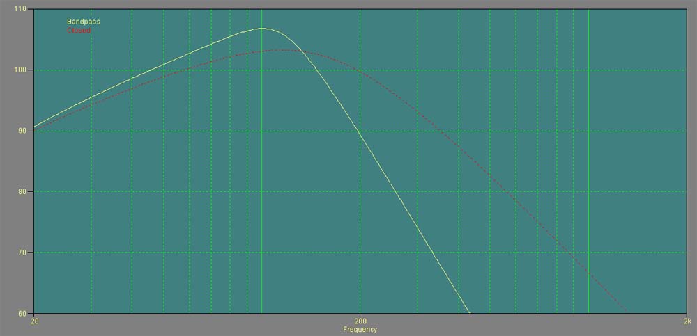

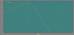

I finally got a chance to run some sub sims. Attached is a plot of the MCM driver in a bandpass box and a closed box of the same volume. The added efficiency of the bandpass is evident. What is not evident is that the cone excursion of the bandpass is lower and with its acoustic LP function the bandpass should play much louder than the closed box. This is a simple single ported design like I find work so well in my own systems. The LP filter is included at 120 Hz.
Now the problem that I have with the MCM is that its excurasion limits and thermal limits don't track each other. In other words I can't even come close to the stated excursion before the power input exceeds the spec. This is a total waste of VC real estate.
Other than that its a good driver.
I am going to use two drivers in one enclosure with one amp driving both. I should be able to do this for a very reasonable price - maybe $399 each. These are ideal broadband subs, but in a really great system I would add a single VLF subs at the very bottom end. That design is next, but the cheap MCM drivers "can't get their from here".

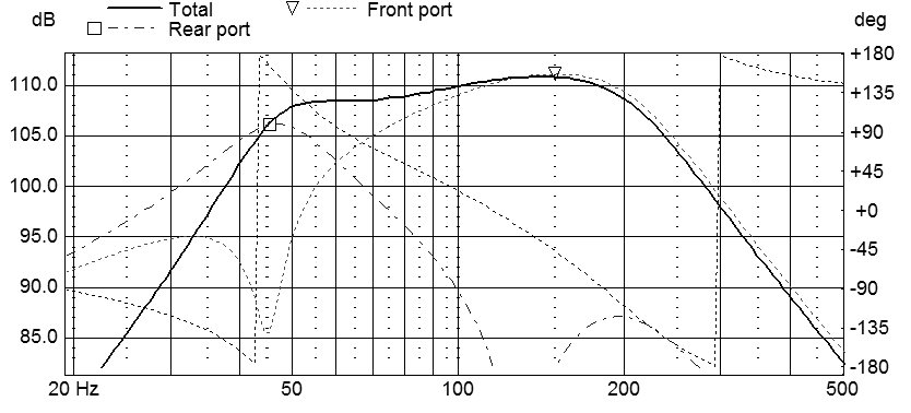

The models don't really disagree from what I'm seeing in a simple comparison to a BP6 enclosure of either separately tuned chambers or a series configuration which more closely parallels the physical layout of the TH. Just as a transmission line is akin to a ported box with added factors, the same is true of the Tapped Horn relative to loosely related bandpass designs.
In more classic use we assume the chambers to be significant in size and we assume the ports to be more simplistic and separate from the chamber's volume. These differences, along with an accounting of Q differences for various resonances pretty well explain what is observed, although I'm just making the observation, not the math behind these additional factors. Since bandpass designs or similar rely on the combination of resonances to produce the gain in sensitivity, the Q of these resonances is significant to the accuracy of the result, where the specific implementation will greatly impact those Q values.

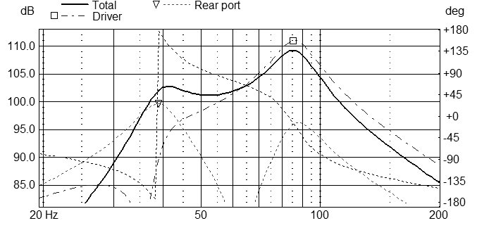

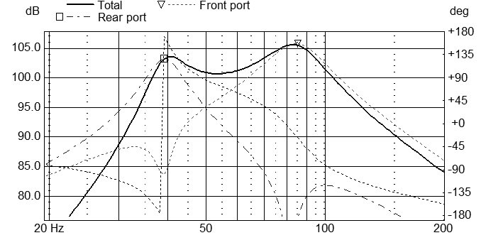

Attached are two 6th order bandpass examples, parallel and series, using the same approximate gross volume (port volume included) using large ports of 10-12" diameter where the impedance minimums are approximately matched. I only had the 8 Ohm version of the driver in my models, so I input 2W to match the drive level of the 4 Ohm version driven with 2.83V in the TH-115 measurements. The impedance minimums in the models are only slightly below 2x that of the TH115, where I have found it fairly common for this model in LspCAD to slightly over-estimate minimums. I have been building quite a few bandpass subs over the past 2 years, and the model has been as accurate as the driver parameters and assumptions made.
What you see is that the peaks of both designs are rather comparable to the sensitivity of the TH115, with a significant saddle in the response where the tapped horn has little or a much shallower saddle, with a more extended top end.
These particular models are not showing port resonances nor radiation of HF through the ports, both of which are at work and significant in the TH design.
A friend recently built up and sent me measurements of a 6th order bandpass (both chambers tuned separately to outside), where the LF chamber wasn't stuffed and used a straight, 4" diameter, flared port. In this case the 1st port resonance and an internal pathway reflection coincided, making for a very strong port resonance near 190Hz. While almost an octave above the designed HF corner of the device and where ~160Hz was >15dB down, the output of this resonance was in fact equal to the midband response of the device.
It shouldn't take much extrapolation to figure that with a much larger and longer port, this resonance, and others, could be intentionally pulled back into the operating bandwidth (departing from common practice and goals) to serve as useful output. Now taper the ports to somewhat broaden the resonance with a lower Q/ less narrow resonance, and you can see how a design might be able to fill in the saddles seen in what might otherwise be seen as over sized bandpass boxes with a peaky response.
This is of course looking at the problem from the other direction from a horn model, but being that the TH has behavior somewhere in between, this should come as no surprise. The more the chambers are tapered, and the less of a volume there is for each chamber, the more deviation there will be from this look, but it does show that the models and expectations make sense... So long as the design fits the assumptions of the model.

Please define what you mean by "series" and "parallel" configurations as these are not terms that I have ever used when I described bandpass enclosures.
Do you mean a resonator on each side of the driver as "parrallel"? What I call dual ported. And two resonators in "series" on one side of the driver?
gedlee said:Mark
Correct Earl,
There really isn't any clear nomenclature so far as I've seen, so a little searching and a picture is worth lots of typing:
I agree that "parallel" was probably a poor choice of words, but the first system was this configuration:
![6thordbp.gif](https://www.diysubwoofers.org/images/site/6thordbp.gif)
The system I referred to as a 6th order series bandpass is as follows:

In reading the replies and Marks plots, I would again say that a Helmholtz resonator and a resonant tube have some similarities but also have differences.
In a case like the TH-115 there is very little “rear cavity volume” only the air trapped under the cone and no obvious “front volume” so what is happening is mostly the action is from the length resonance’s.
In Marks nice BP model, one can see that there is a definite “low pass” corner and it is usually the close placement of the high pass and low pass corners that form the “band pass” gain that fills in the space between the two bumps.
These filters are the Helmholtz resonators, both are low pass filters, one for the front side and one for the rear side of the driver.
A Helmholtz resonator only has one resonance however, while a resonant tube has a “lowest mode” where there is a pressure maximum at the closed end and then a series of modes above that which alternate between velocity and pressure maximums at the driver end. A resonant tube is not an acoustic low pass filter like a Helmholtz resonator.

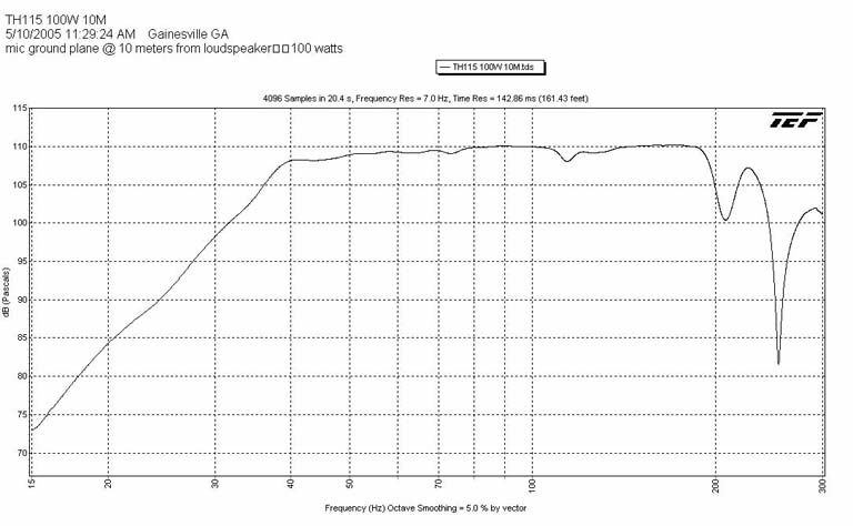

Below is a measured curve for 4X TH-115’s, each driven with 25Watts (these were with the 8Ohm driver).
The sensitivity is between 108 and 110dB 1W / 1M which places it in the 30-50% nominal efficiency range. Can one even make a BP system with that kind of sensitivity?
To me, considering the sensitivity as well as the lack of the low pass corner near the high pass corner and the absence of phase shift associated with the low pass corner and different phase shift everywhere else; makes it look a lot more like a horn than a BP system to me.

Mark Seaton said:Hi guys,
In line with my earlier posts in this thread, I'd say that just-a-guy isn't far off the mark.
I also think "Patrick" needs to be a little more conscientious in making proclamations in regards to designs based only on a few builds and models, especially when the two don't match or deviate significantly from the intended target.
I don't think we disagree on anything here do we?
A few weeks ago I set out to build a set of dramatically under-sized tapped horns. If anyone wants to check my data, I posted exactly what I built. There are two tapped horns; one is in my living room, the other one is in shambles, after it fell off my deck(!)
Once completed, I was surprised to find they weren't as efficient as I'd hoped. At that point I modeled and built a bandpass box which is half the size.
I have personally built front loaded horns, tapped horns, bandpass boxes, vented boxes and sealed boxes. Based on my hands-on experience and almost two decades of study, I believe that a bandpass and a tapped horn of SIMILAR size will have comparable efficiency.
Things change when you give the tapped horn some room to breathe though! Once you quadruple the foot print, the efficiency goes up dramatically. If you try the same trick with the bandpass, it doesn't work well, because there simply aren't as many variables to play with. For instance, you can use a much larger port, but then you start suffering from port resonances in a big way.
To make a long story short, I would discourage anyone from building a tapped horn which has been dramatically undersized.
Note that I'm not discouraging anyone from building SMALL tapped horns, just UNDERSIZED tapped horns. For example, let's say your goal was to build a tapped horn that's flat to 25hz. If you had to choose between using an eight inch woofer with an FS of 31hz or a pair of six inch woofers with an FS of 50hz, I'm inclined to believe that you would get better results with a pair of sixes. Keep in mind that is CONTRARY to what you would do with almost ANY other sub box. When it comes to subwoofers, a low FS is typically a GOOD thing. As Danley noted himself, tapped horns work quite well with drivers that have relatively high FS.

Hi Tom and the rest,
To add to my last post and clarify to those reading along, I do see the TH as distinctly different from common bandpass usage. My point was more that there is a some relation and correspondence in terms of potential sensitivity. If you were to conceptually start with a bandpass and incrementally morph the enclosure to a tapped horn as you shrink enclosure volumes to zero, with port areas and lengths increasing greatly, at some point we get far enough that the assumptions of the bandpass box no longer hold true, or at least the assumptions leave many operational aspects unaccounted for.
This means the model has to be adjusted to account for the behavior, and we see that modification of a front loaded horn and other factors do roughly track the results, of course depending on the accuracy of the input data. We also know that classic modeling of horns makes quite a few assumptions which are over-simplifications making for deviations in the smoothness and exact shape of the realized response.
If we look at a parallel situation of a 4th order bandpass and its comparison to a front loaded horn, we can similarly see that as the port gets larger and longer, the front chamber gets smaller, and especially if we start to flare that port asymmetrically, we see the assumptions in the bandpass model are no longer true, making the model incomplete, and a more accurate model is needed.

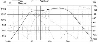

Since thought experiments can be fun, I quickly increased the size of a dual ported, 6th order bandpass to that of 4 TH-115s and played around a little. Earl can possible clarify with the exact limiting factors of efficiency, but relative mass/cone area makes it nearly impossible to get a wide bandwidth response without impractically light weight 15" drivers where the TH115 achieves its sensitivity with only 4 15" drivers. Just to point out that the high sensitivity is possible (at least per the model, which I would want to double check at this efficiency), I upped the ante with 8 x 18" drivers in the same package. Starting with a stock driver as a point of reference, I needed a very light and fairly powerful driver with a Mms of ~140g and a BL^2/Re of ~150. That's not an easy driver to build, and certainly not easy nor cheap to get significant excursion from. Of course actually fitting all of the drivers in the box would be no small task either.
![scratch :scratch: :scratch:](https://files.diyaudio.com/forums/images/smilies/scratch1.gif)
Note that I still didn't quite get the low end sensitivity of the TH-115s, but I thought it would be interesting to show that a bandpass should be possible of that sort of sensitivity from 1W:

To be more clear on my comment about Toms measurements, its a point of public record that I question the accuracy of ground plane measurements in this circumstance. A ground plane measurement assumes that the boundary plane is infinitly rigid and perfectly smooth, neither of which is actually true in practice. The degree to which the failure of this assumption affects the results is unknown, but clearly the further away the measurement is taken the greater this effect will be. Tom has agreed to post (or supply) measurements done in a more conventional manner (free field impulse response at 1-3 meters) so that the results can be compared. I am most anxious to see them.

when I model a pair of the 18ps76’s in a vented box, what I see is a sensitivity between 101 and 102dB 1W1M, about –3dB down from the TH-115.
Also, with that alignment one reaches Xmax in the 65Hz to 35Hz region at about 350 Watts total input and even a 12 inch port has noticeable loss.
So far as Tapped horn excursion, I believe the issue arose from Akabak giving a different predicted value from Horn response at the time, I don’t know if they agree now or not.
I can tell you is that if you want to know what the excursion is, the easiest way to do it is to put a window in the box with a light inside and a white dot on the cone next to a scale.
My point then was that if one sees an increase in sensitivity of say 10dB, one also sees a reduction in cone motion of about 3 for the same SPL.
Also, it has been my observation that often the “Q’s” of the hf resonances are over stated in the computer models, some times a hf feature is predicted that is totally absent in the measurement.
