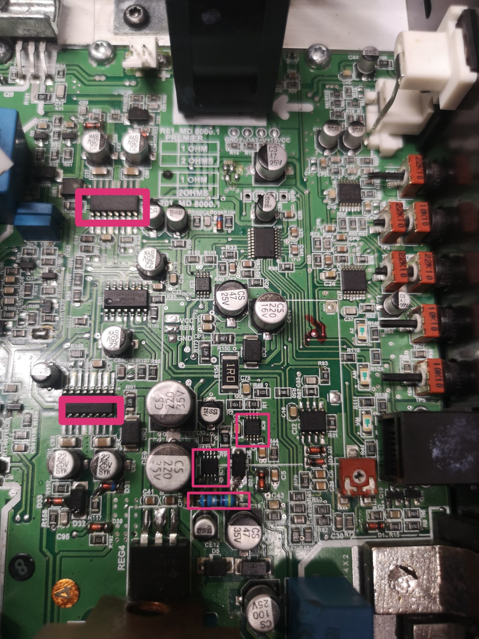

Did this problem start suddenly after working normally?
Are you sure it's not a dirty switch or pot that's causing the problem? Have you tried operating all of the pots and switches through their entire range to see if any were intermittent?
DCV measured across pins 9 and 11 of the 20957 ICs?
Is EVERY PS FET being driven by a clean drive signal on their gates?

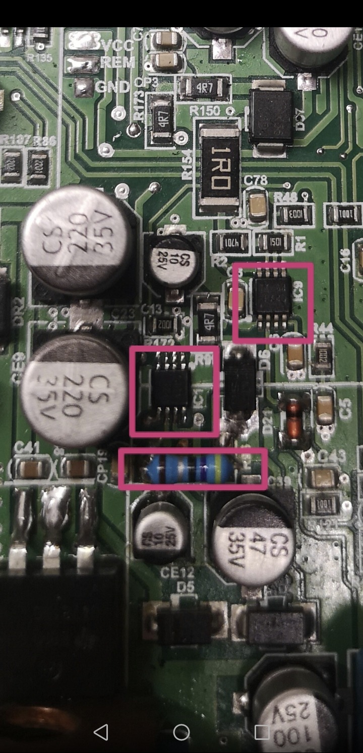

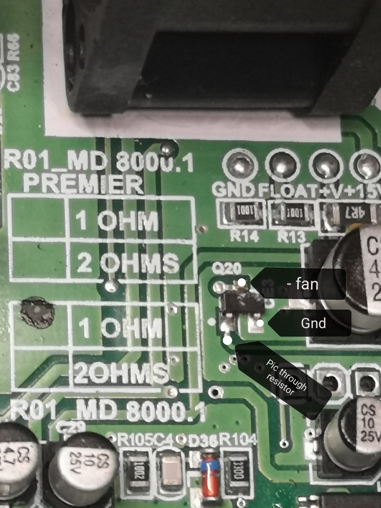

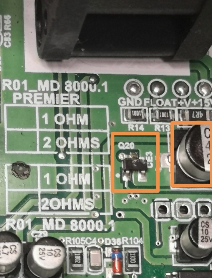

You need to be more specific, which 3 components are getting hot ?
Resistor was substituted because original was completely burned
Pin 9 and 11 14.8v each driver,
i don't know about previous repair, trimmer are all cleaned with contact spray, fet drive signal very low but present 2vpp, square obviously
