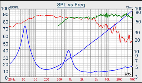

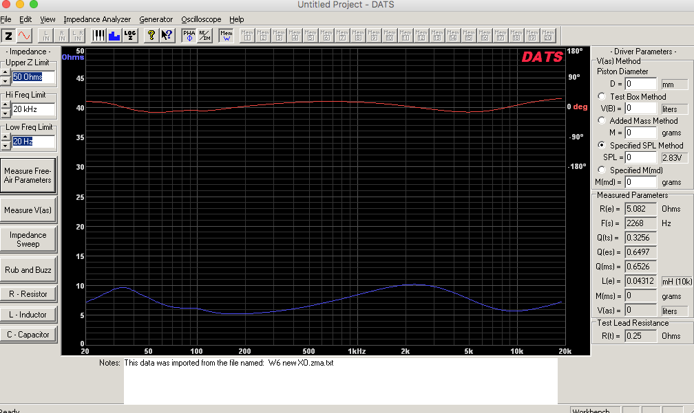

Something very wrong with my W6-2313 pair.
They have been sitting away for a while, but last two days, I decided I wanted to re-visit them and work on a new XO.
I already had my .frd and .zma files, so I started with that... and there was some weird stuff in the measurements after hooking up the new XO.
Of course, I thought it was some wiring issues, so, I combed through it (even though it's not so complicated, 1st orders on both) but everything checked out.
So, decided to re-do the .frd files because something was fishy.
Yikes....
The tweeter is dying.
Don't know what happened.
These things have less than 500 hours of listening, and always casual listening, no parties, nothing over the top.
But, as you can see in the measurements, the tweeter starts falling off at 3kHz!
I thought I might have wired wrong and used the woofer, but nope, woofer check up fine and has a regular drop for this kind of woofer.
No wonder I was having trouble getting some high range...
No idea what's happening, and I will for sure drop a line to TB to try to find out.
But if I were you, I'd wait for "mk II" before buying this driver.

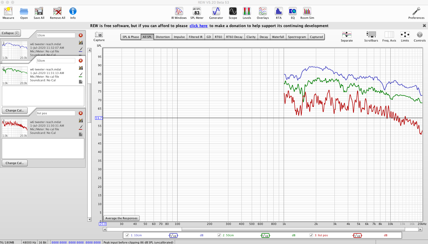

Here are some measurements, taken at 10cm, 50cm and listening position, which is about 2m away. Plus the graph from TB....

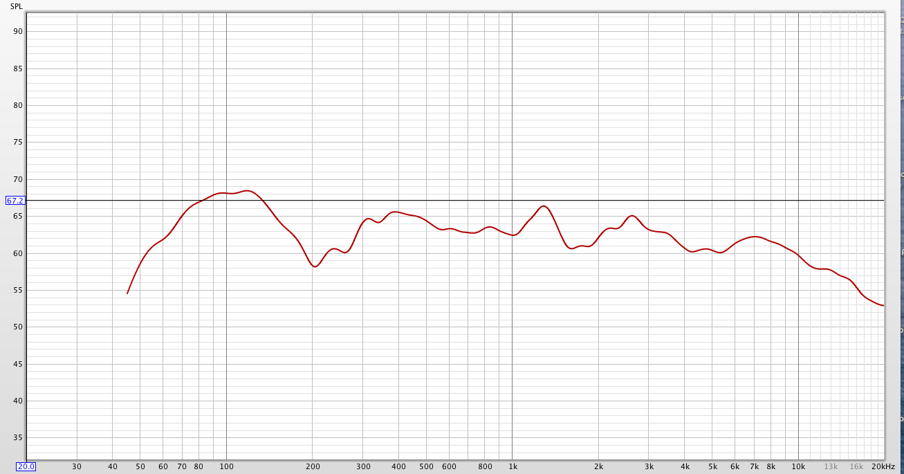

did you get a chance to measure yours?
I have re-done the XO to accommodate the tweeter.
Starting to sound much better.

It seems very odd that both tweeters are doing the same thing at the same time in their lifespan. As you are hearing it and measuring it, could it be something in the signal chain? Did you swap out with another set of speakers?
My two are still doing fine. I ran a Dirac calibration with them and two 18" IB subs using the Monoprice HTP-1 processor. I really like them, but I'm struggling to find that sweet spot for their placement to get the imaging I remember from the first time I listened to them.

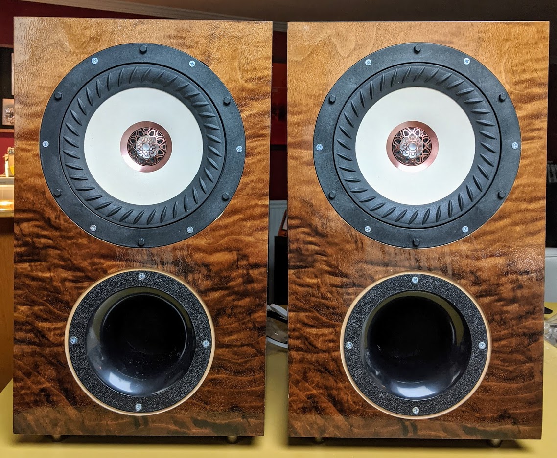

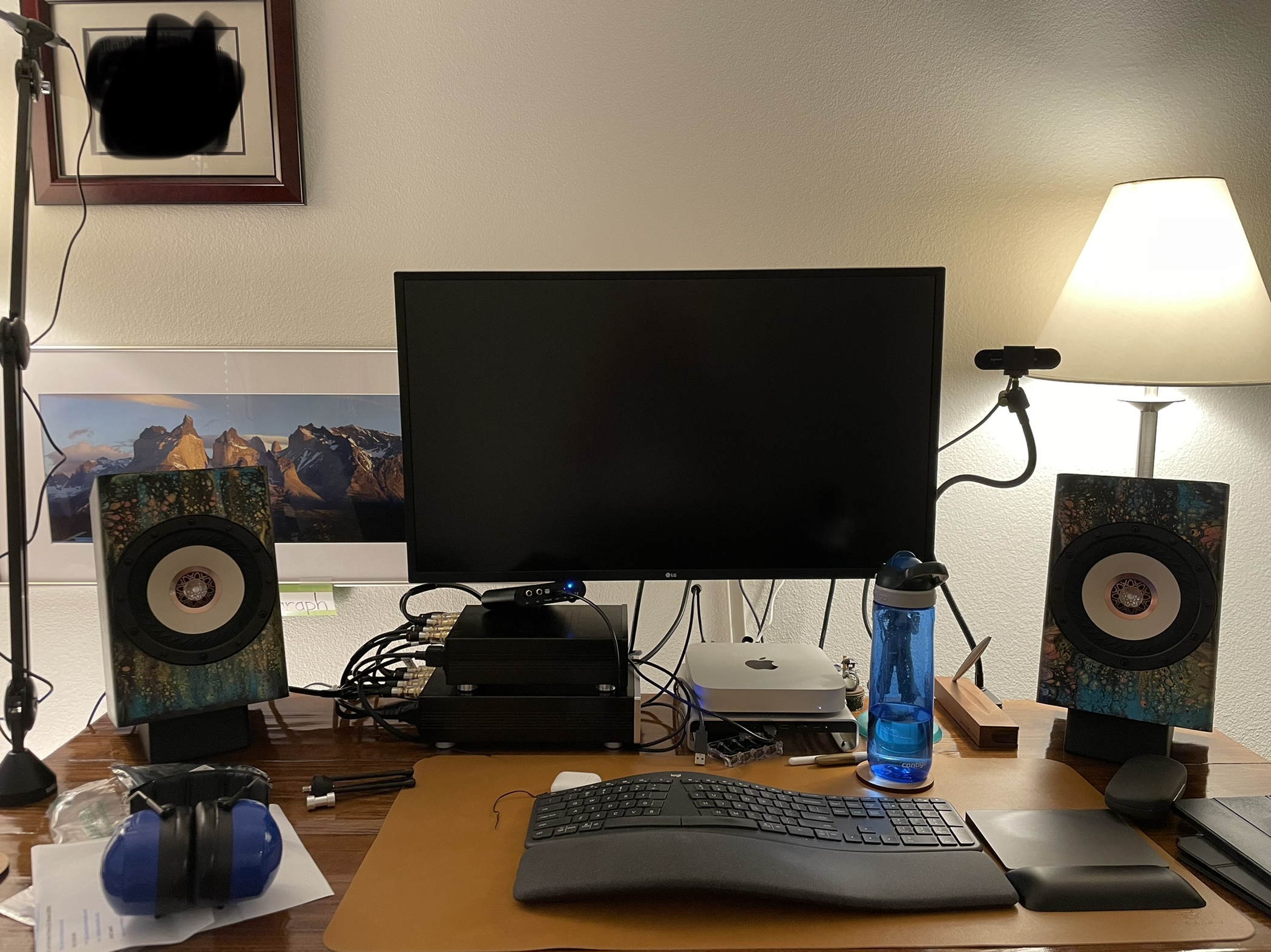

I've got mine set up, finally (almost two years later). Currently running on a MiniDSP 2x4HD for the xover in the Parts Express 0.23cf knock down cabinets with a pair of ICEPower amps I built. The desk setup is utterly suboptimal of course - I'll be mounting these on the wall at ear level soon and rearranging all the electronics.
How do they sound? The soundstage is razor sharp with a lot of transients and other details coming through that are missing on my Amiga's in the main listening area. Drawback is a lack of dynamics (cabinets aren't the right size and not really optimized for response). Once I've got the EQ dialed in I'll probably move to some sealed cabinets with a sub in a 3-way config.
