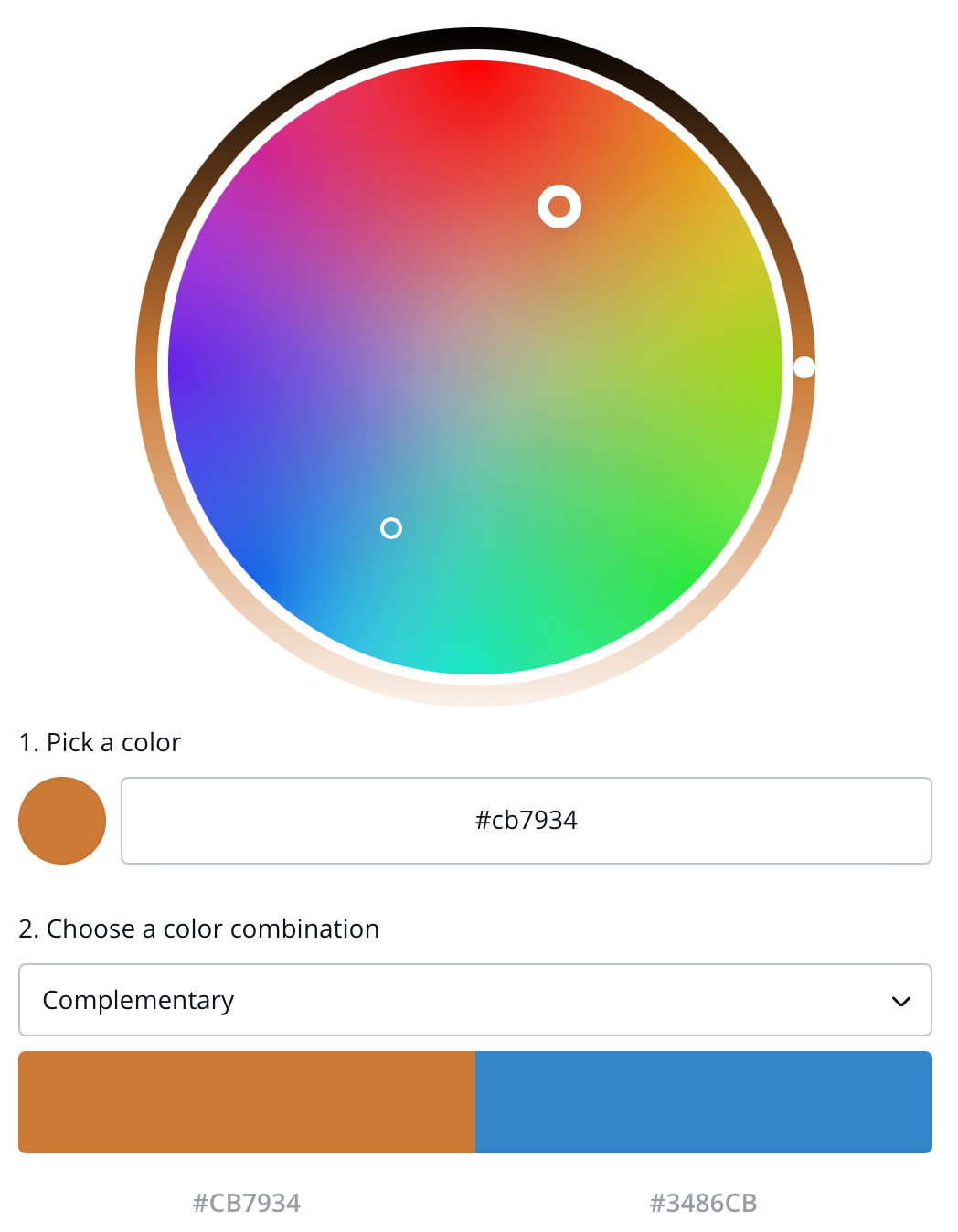

I have a slab or purple heart that I want to make some rings out of to encircle the woofer and ports. But I'm really stumped in what kind of design I want. Do you guys have any suggestions for patterns that would look nice?
I've found they tend to do well with colors that match copper and cream. My wife did a pour painting on the baffles with gold, a metallic pink-ish color and emerald that really complements the drivers.
If you plan to keep the wood on the front I'd go with something complementary but across the color wheel, similar to the emerald I used but maybe a bit more blue. Try the Canva Color Wheel.

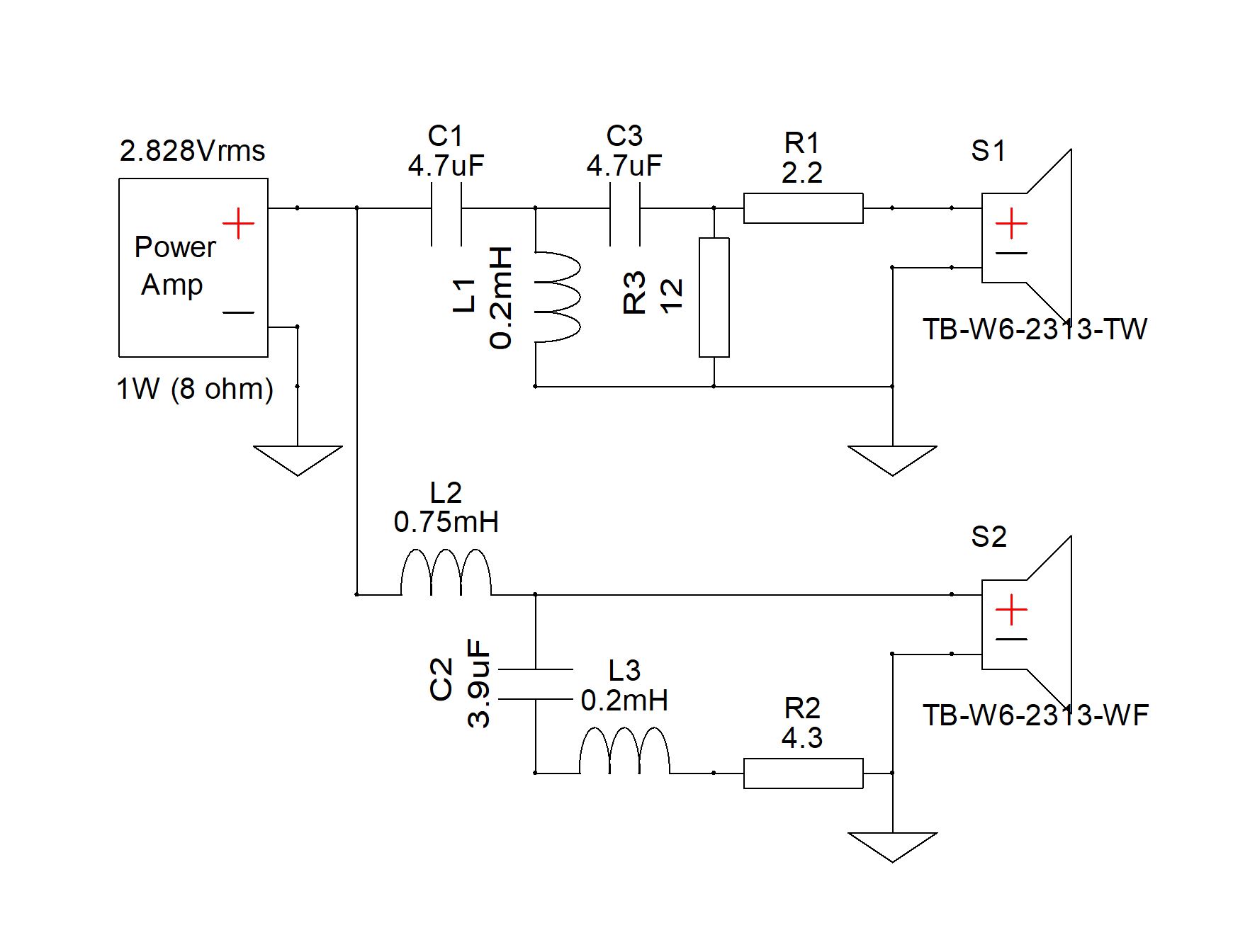

I used TangBand's suggested crossover because it only took a short conversation to accept they were a heck of a lot smarter than I was when it came to getting the most of their products. You get a 2nd order on the tweeter but the woofer only gets a filter. The impedance of the woofer climbs so fast in the crossover region that I think a traditional 2nd order crossover would be pretty difficult to get right.

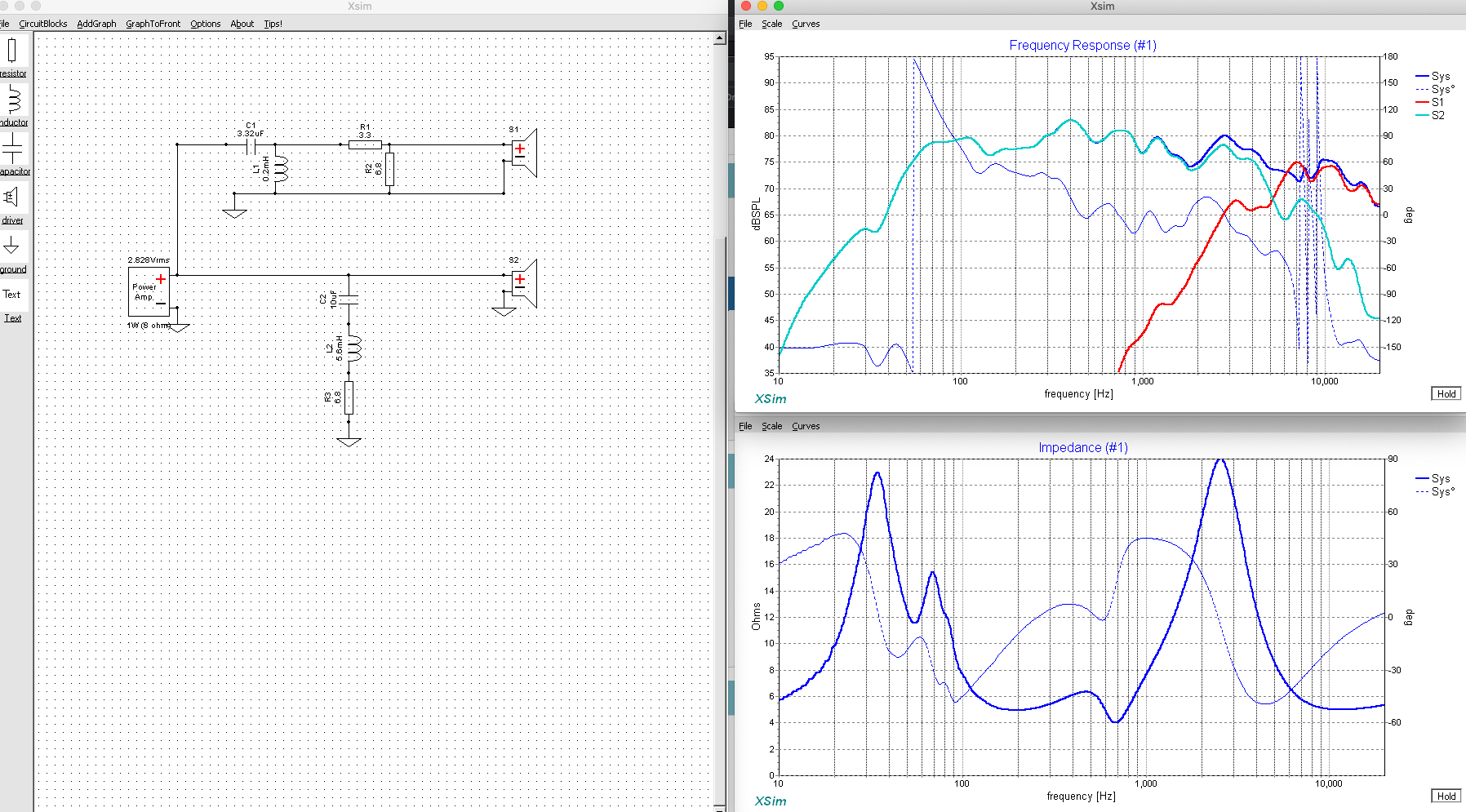

Bobby, do you have anything to measure your speakers?
With mine, this is what I get with a simulation of TB's XO.
I have a basic measurement microphone but I don't really have any environment to properly measure within.
I do have a dats V3 impedance analyzer though

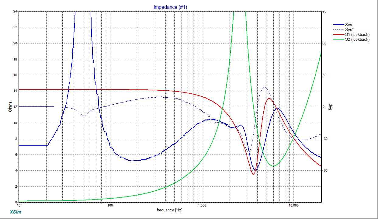

The crossover from tang band is slightly different for the 8-inch version than it is for the 6-in version but it works in more or less the same way.
Just had a look at the W8 XO... that's quite a wild impedance ride!

I briefly considered making my own until I saw that impedance curve on the woofer and then I said "nope nope nope". I was lucky enough to get in contact with the folks at TangBand and ask them questions figuring they knew better than I did. They also suggested having a 3" port on the front instead of the 2" port on the rear I was planning.
I can set up and measure in the room this weekend. There's a fair amount of room gain on the bass (which actually works out well for these guys to the point where I don't feel like I need a subwoofer)

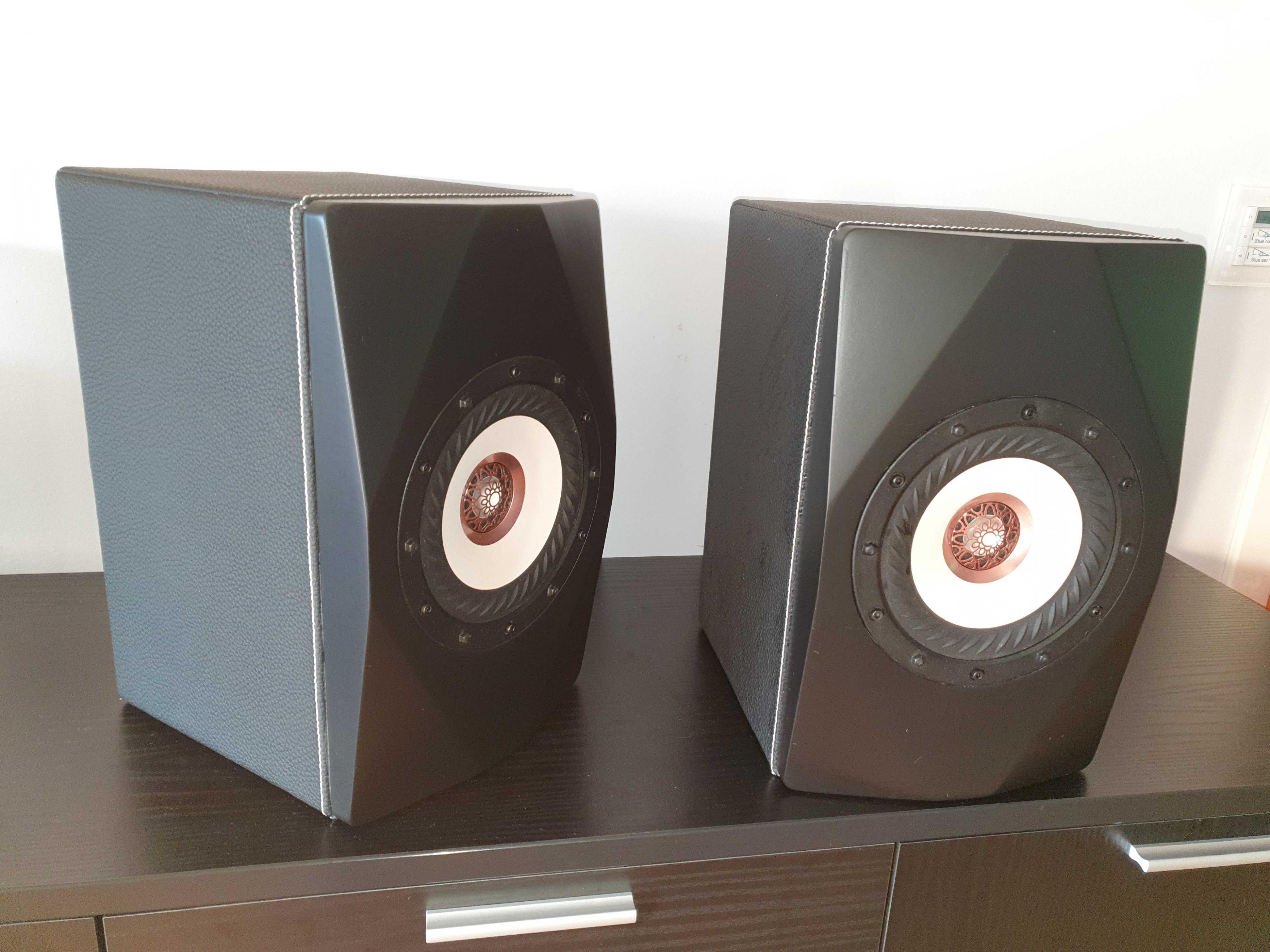

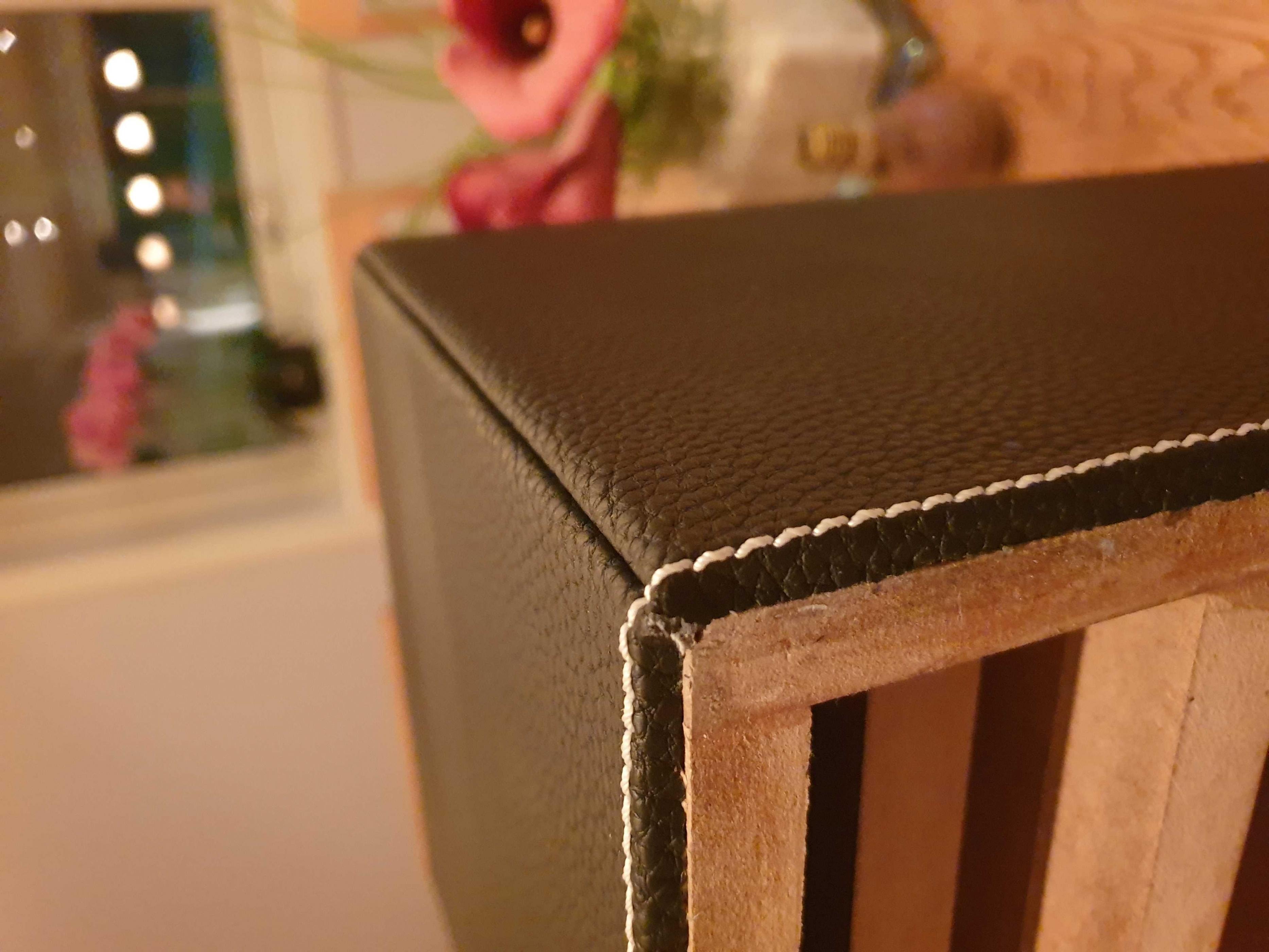

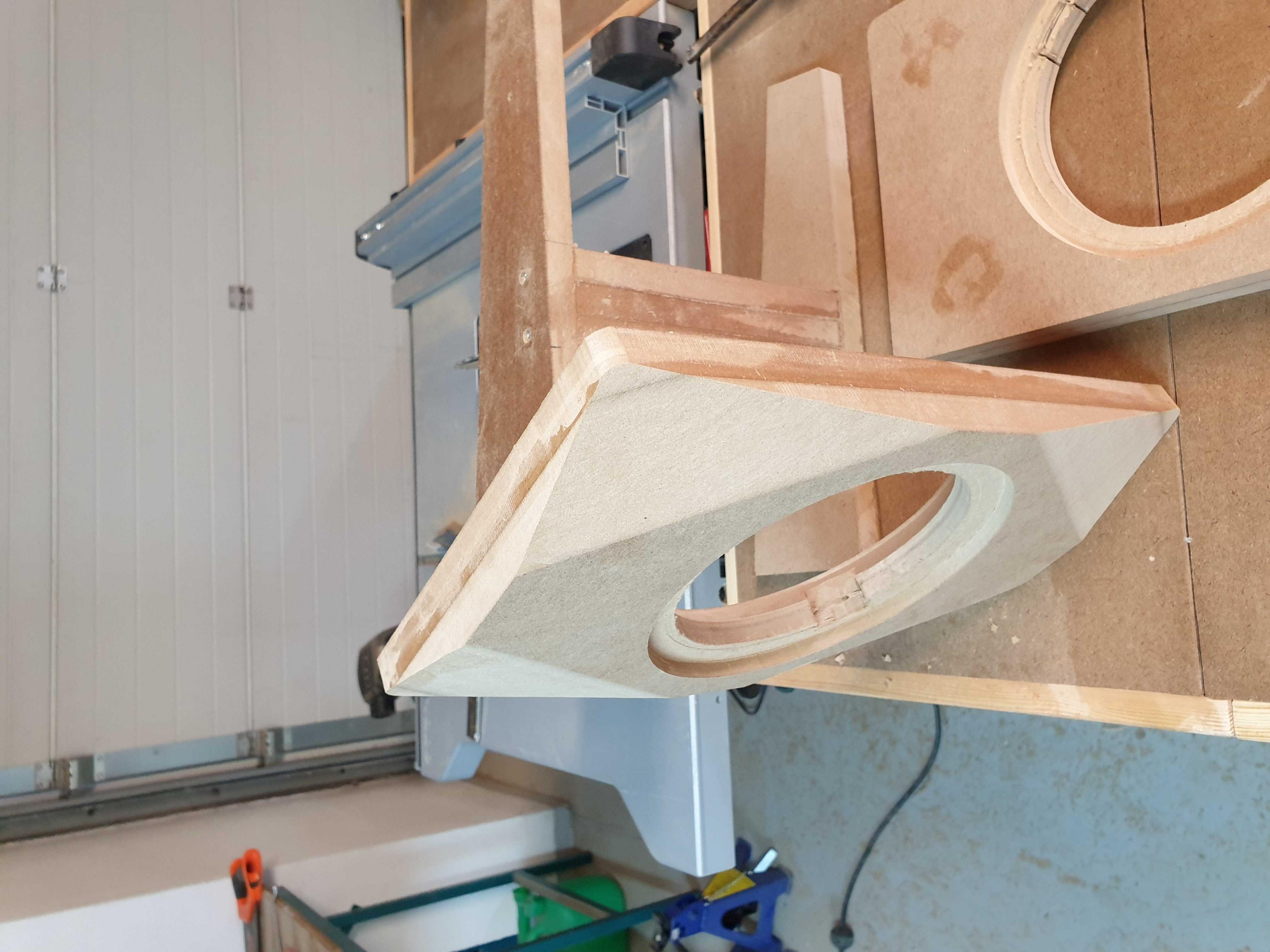

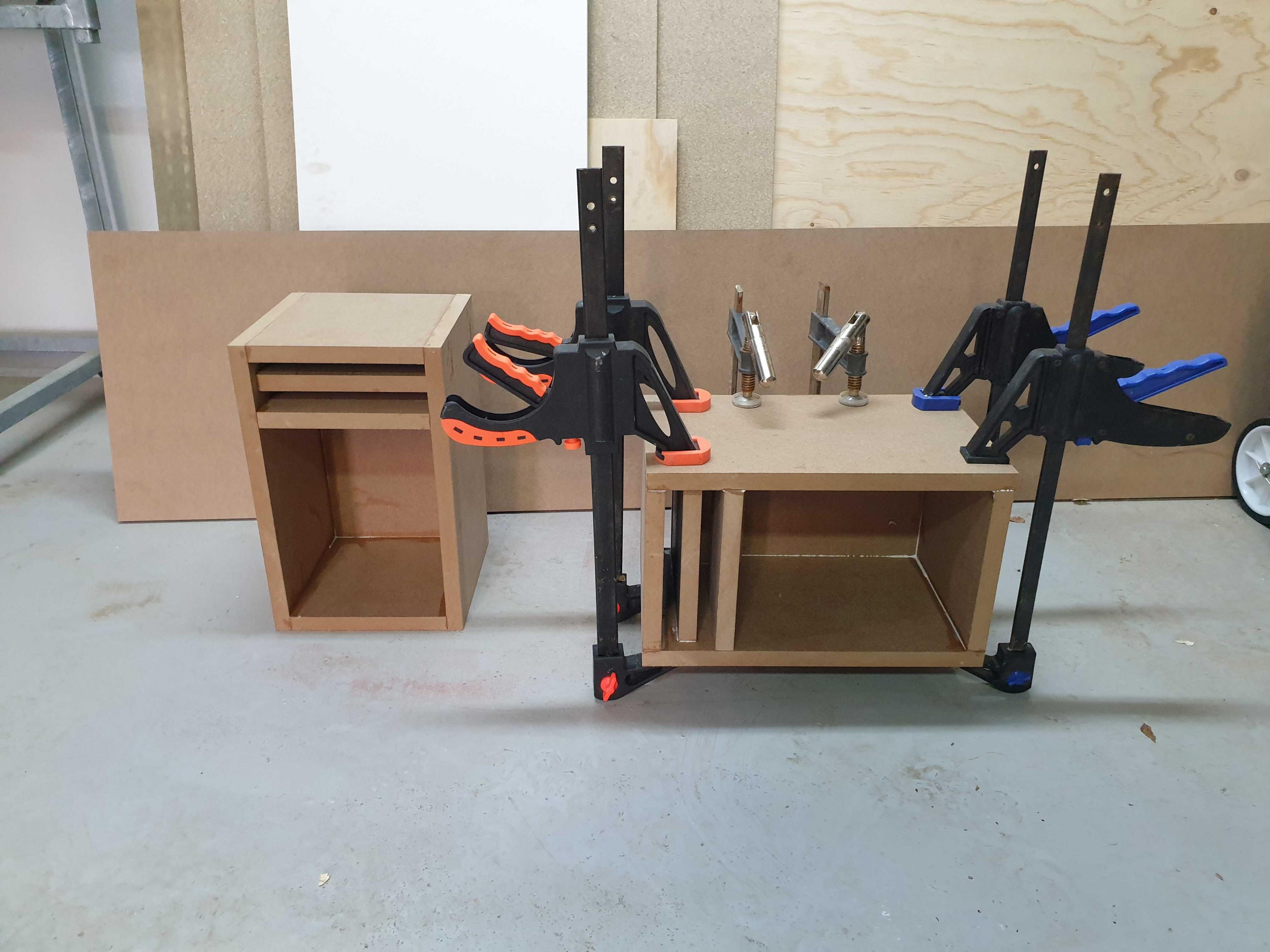

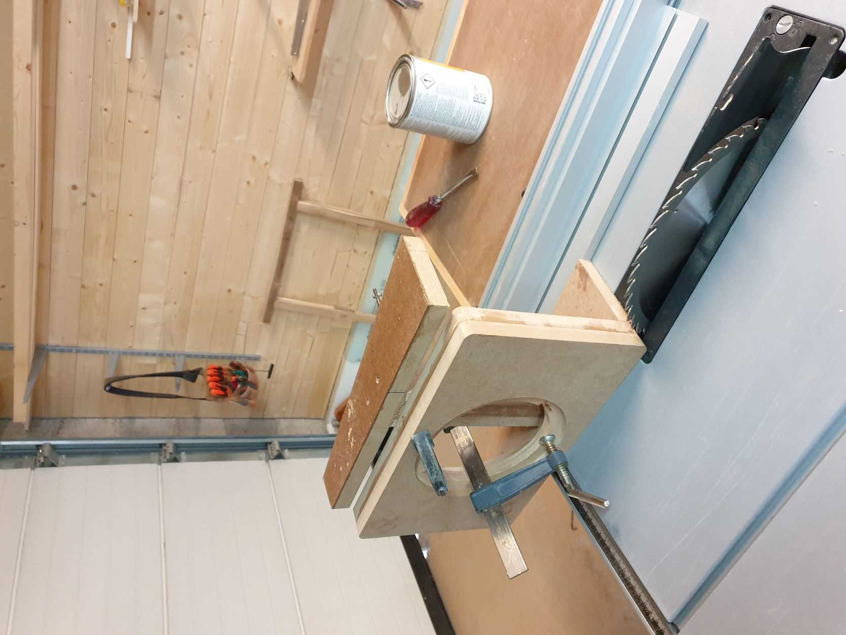

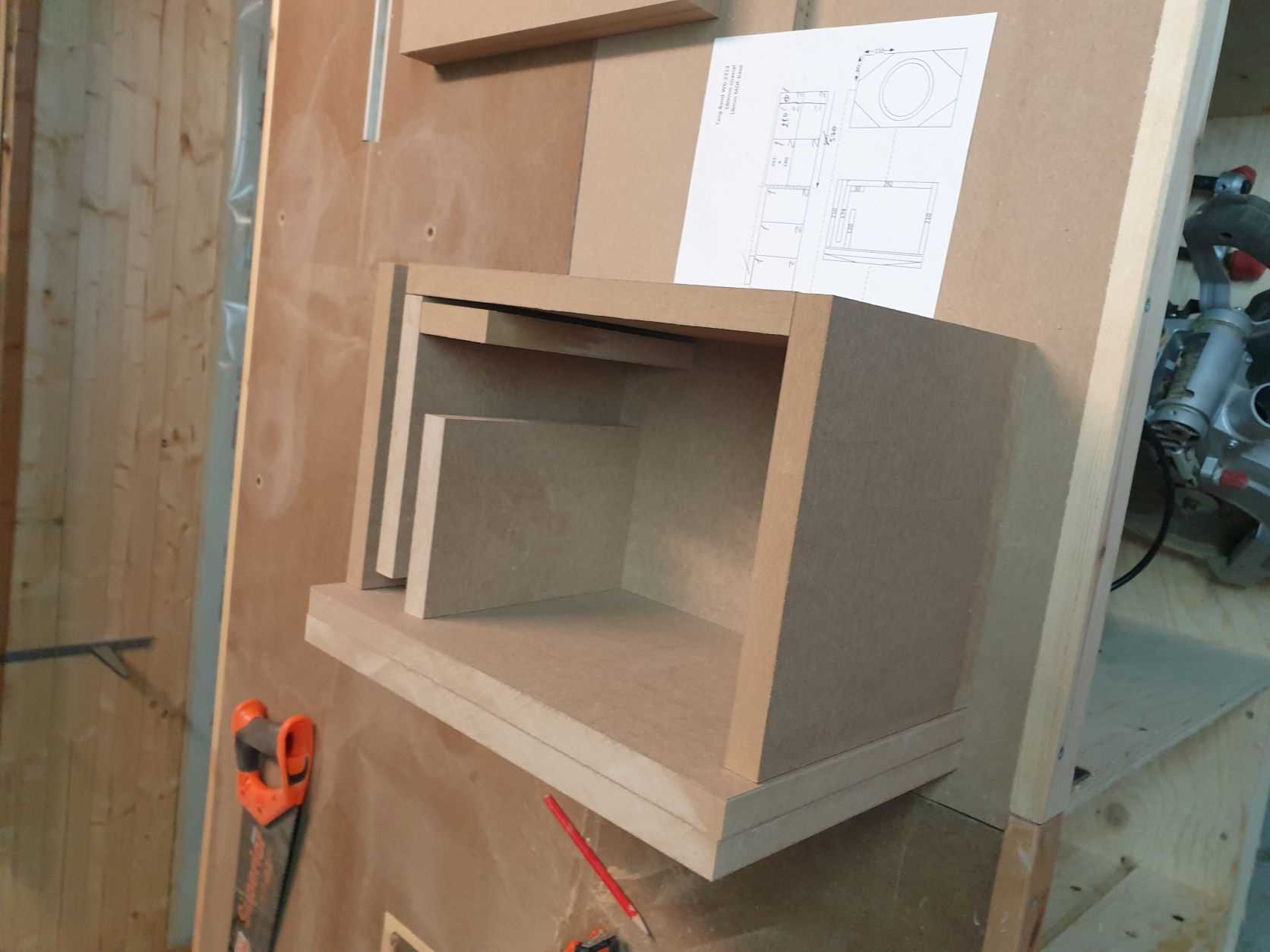

I just finished a set using the 6.5" and a sub, to match my TV room, and I must say I love them!
Tang Band SUG2-25 17l boxes were slightly big, as I intended to make them wall hung above the TV. So using WinISD, I squeezed them down to just over 9l, and did a folded, square port in the top/back, hoping the wall would give a slight bass boost, making up for the smaller cabinet. As I habe the Sub, this might not be needed, but I imagine I get decent bass feom such a small speaker.
Had a lot of fun making a jig, to cut the baffle... my first project in more than 10 years, so I needed to show off a little... hehe.
Then clad the box with faux leather.
Must say that I'm happy with the result... and they sound pretty good to!
Same exerience as Bobbie with Heavy (which "unfortunately is "my" music ;o) however the vocal qualities, and the level of details, makes them (in my opinion) excellent for music and general TV listening (but lack a bit "punch" for movies/special effects).

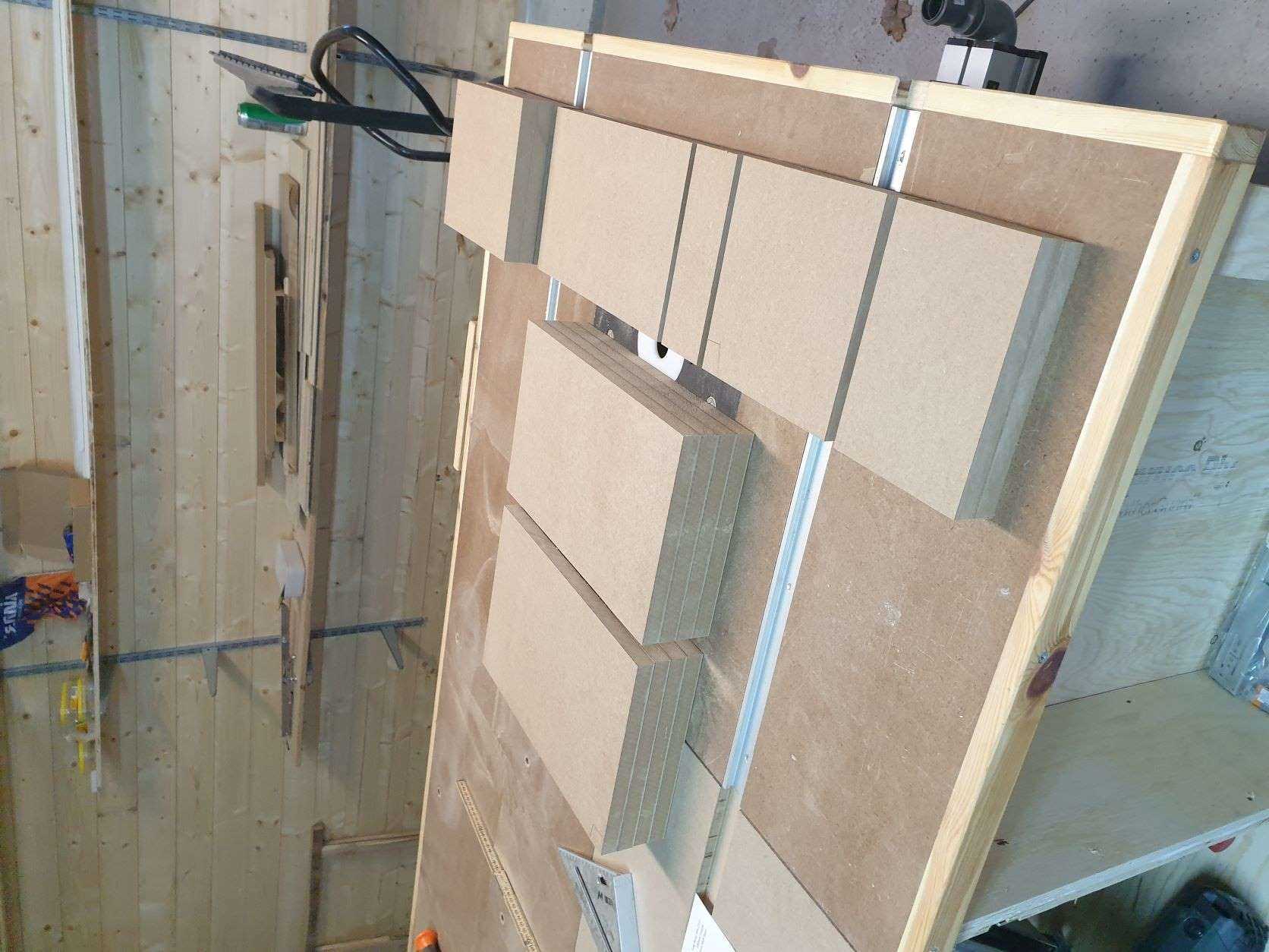

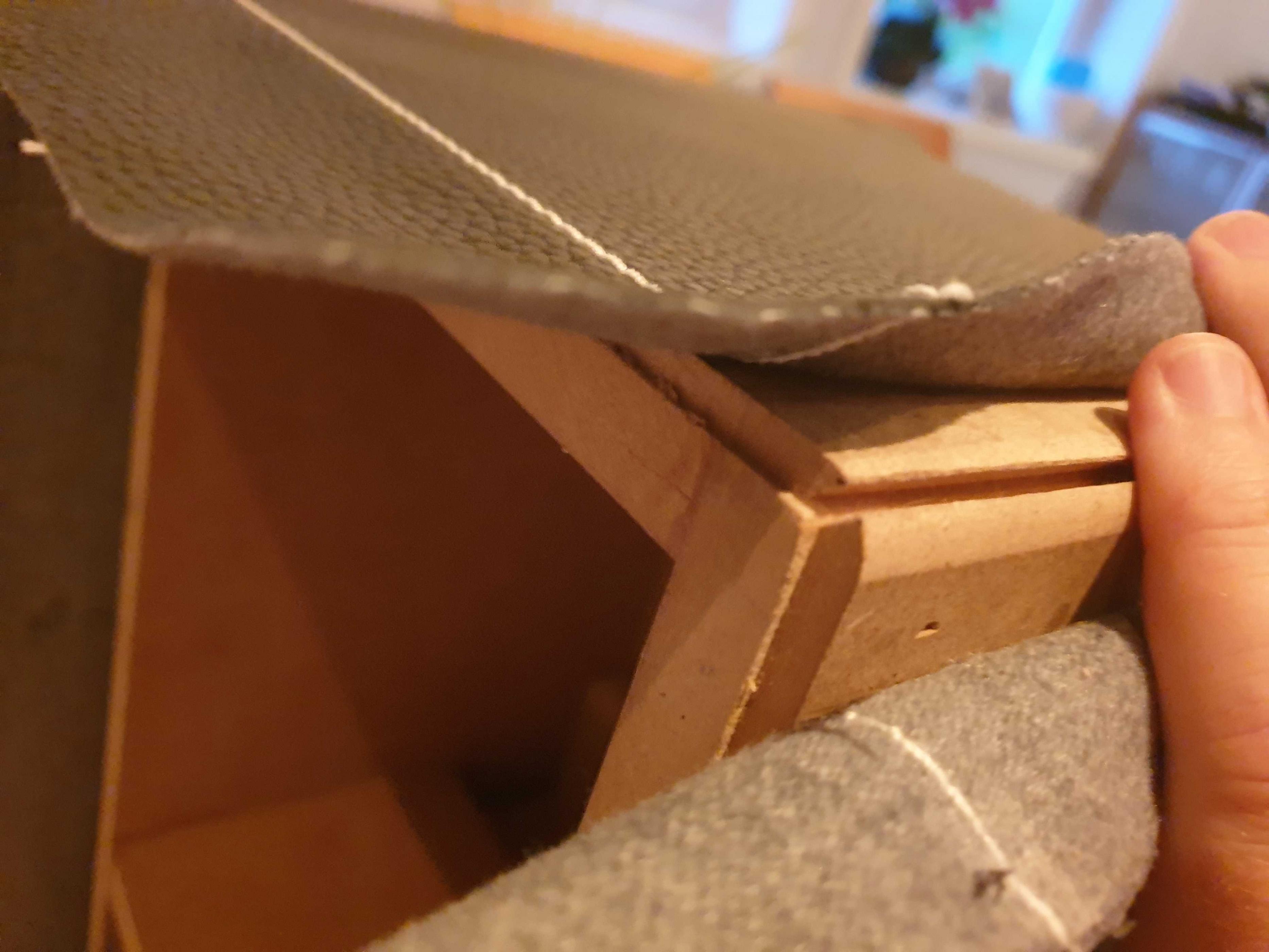

Pictures
The upload took so long, that the admin time for editing expired ;o)
Adding some pictures, if anyone are interested.

I love looking at what other folks do. Cutting that slot to tuck the leather in was a great idea. Nice table saw jig too.

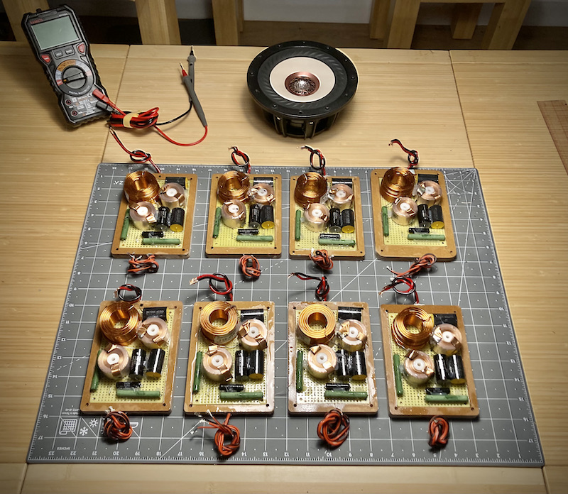

I was not happy with the TB suggested xover, so I decided to try my own.

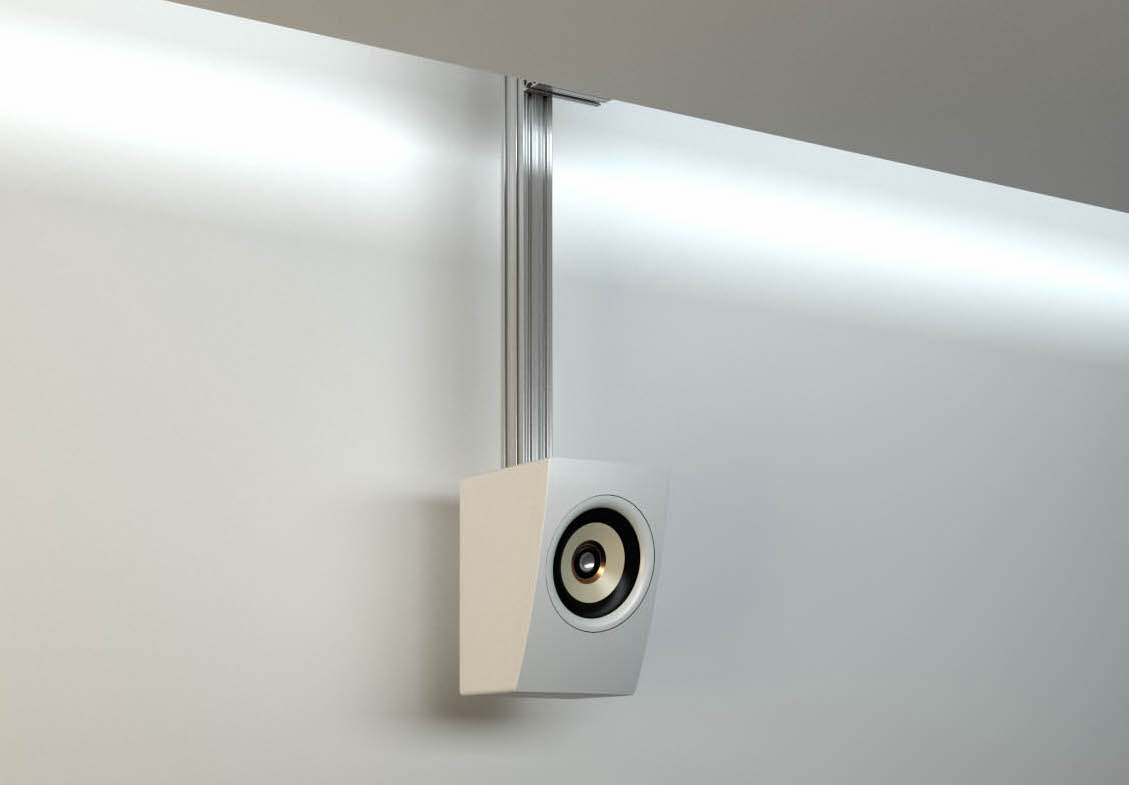

I made 8 of these for 4 surrounds and 4 heights for a HT system I'm building for a client.
I like the sound a lot better now: there was a harshness around 5khz that took me a while to get rid of: luckily the bamboo cone performs quite well at higher frequencies: drivers are cut at 3.5Khz.
I decided early on that I would 3d print the baffles with PETG: I wish I knew better... The quite expensive Snapmaker cannot print such a large model with PETG. However the Snapmaker can also do CNC, which was my contingency plan, and the baffles came out great that way. I may paint them today.
The last pic is a CG render illustrating what we are aiming for: the side surrounds will "swivel" down from the ceiling to meet demanding WAF.
Actually, for coming up with a custom XO, I measure in the room the speakers will be placed in. That way, it is more suited to the actual listening environment, than an utopian room that no one will ever have!
Thanks for sharing!
Here is 1m away, one speaker, in room. I need a longer cable before I can measure from my listening position. It's probably about 1W but I don't have the ability to control or measure that. 1/12 smoothing applied.
