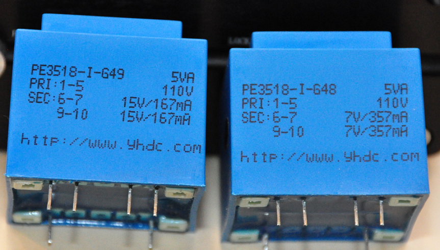

Could someone post photos of 15v and 7,5v trafos? I'd like to know their nominal current. I bought DIY kit which did not include trafos and case. DIY kit seemed like a good idea for modding.
Here are the 110v versions:

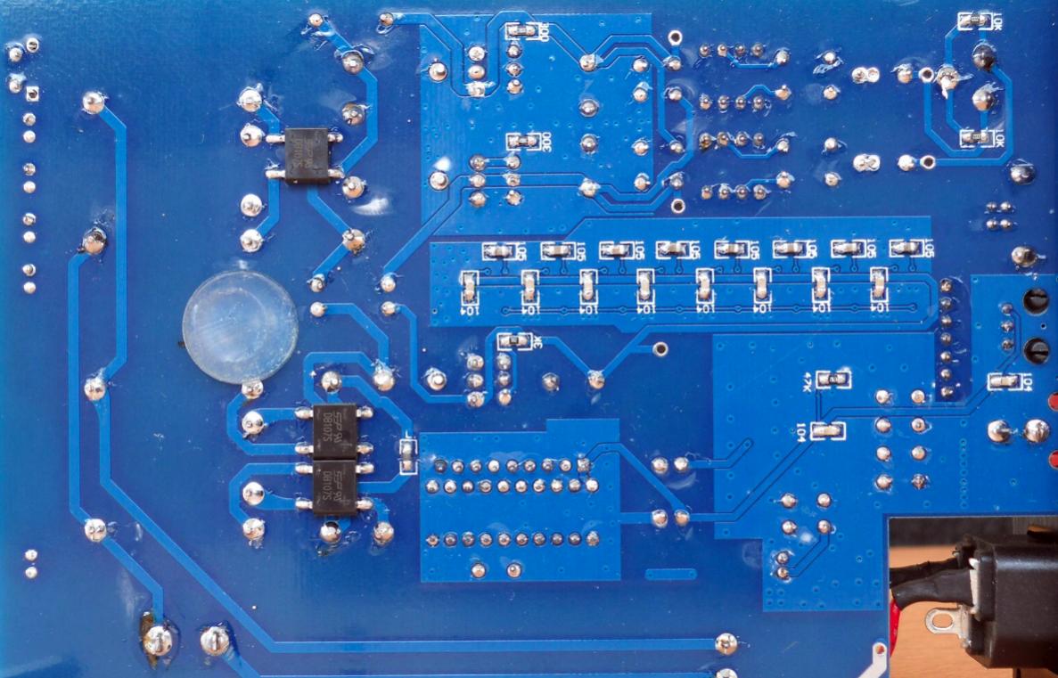

Removing Opamps
Hi Mark, sorry for the delayed reply. At any rate - I don't see an actual question in your post. Did you just want a suggestion on the next steps? Or clarification on a specific mod?
Hi matt_garman,
Thank you for getting back to me.
Have you modded your TDA1387 x8 to remove the opamps ? I believe the attached photos are the work of Malefoda. How does the sound change without the opamps ?
I believe without the opamps it becomes an all discrete DAC.
Thank you,
- Mark

Hi Mark,
No, I never modded this DAC to work without opamps. That's partially due to not having as much time as I'd like to work on these things, and also partially having some neurosis for neat and tidy work. I couldn't see any easy way to build the discrete circuit and keep things reasonably contained in the stock chassis. (There's a practical reason too: I have young kids running around, so it's not safe to leave a rat nest of live electrical stuff out where they can get to it.)
I could have moved the PCB into a bigger chassis, but it doesn't have any screw holes.
At any rate, that's a big part of why I designed the front end, so I could easily (and neatly) play with downstream filters, I/V stages, etc.
On your x8 DAC, I would try to add in the extra capacitance on pin7 of the tda1387 chips. At least in my case, I felt that was the one mod that had the most obvious impact, particularly in terms of bass.
Assuming you want to use the original chassis, you'll either have to get small diameter caps to put on the bottom of the board; or you can use bigger caps by soldering directly to the tda1387 chip pins (solder across pin7 (positive lead) and pin4 (ground)).
