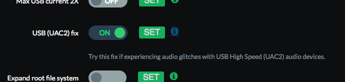

In both case on my RPi it works. But for USB there is that line you have to add in a file, linked to generic USB 2 DACs. I guess it's not linked to the daughter board you've chosen (which daughter board do you have?) but the case most of the time. In Moode 3.6 it's a thing to activate or not. In earlier version it was to be manually added in a file. Check screen copy to help you to search in, say, the moode audio thread.
BTW, I'm now on a SPDIF board, Allo DigiOne, and it's sounding very rock'n roll! Check this YouTube done for my eBay sell, it does lock on a RPi, even at 24/192, on SPDIF.
I'm using the L2706USB daughter board, now i haven't tried Moode yet so that might be worth a try. Certainly not working with Rune or Volumio.. well not for me at least. Would you say that avoiding the usb and using a spdif hat is the way to go sq wise. The iqaudio digi+ seems ok for a try out.
IIRC the "bug" is there in unix, not on the music soft. You may fix that first. But the DAC is seen, just sound NOK.
As for SPDIF I only advise the Allo DigiOne (I know, costy...) as this is the best one, or the Hifi Berry Digi + Pro, this one also has the 2 base clock freq. which the RPi can't handle. Other cards won't get accurate clock. And as this DAC doesn't reclock at all and is jitter sensitive it's the only way.
