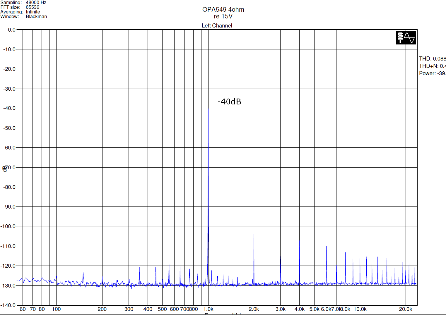

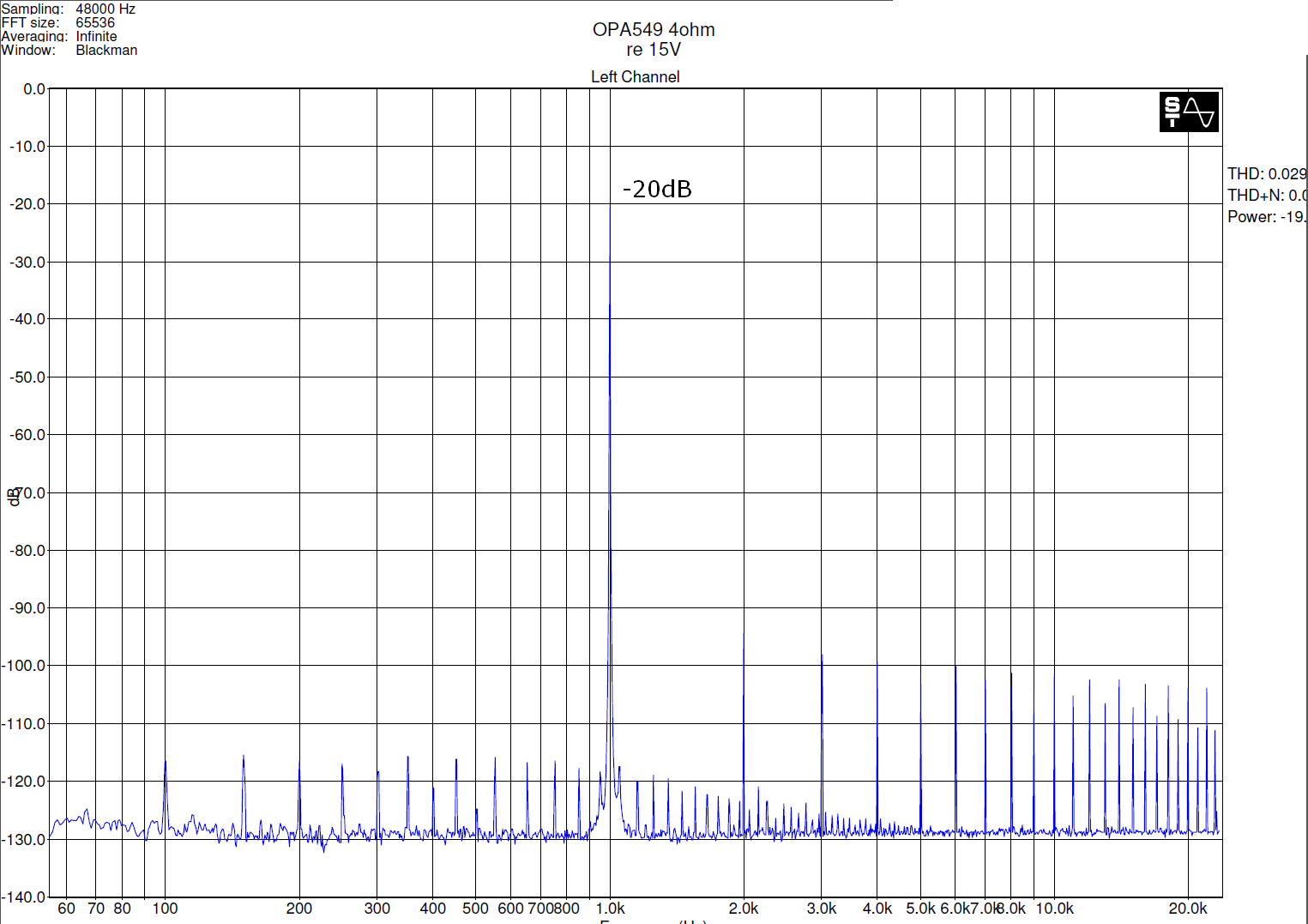

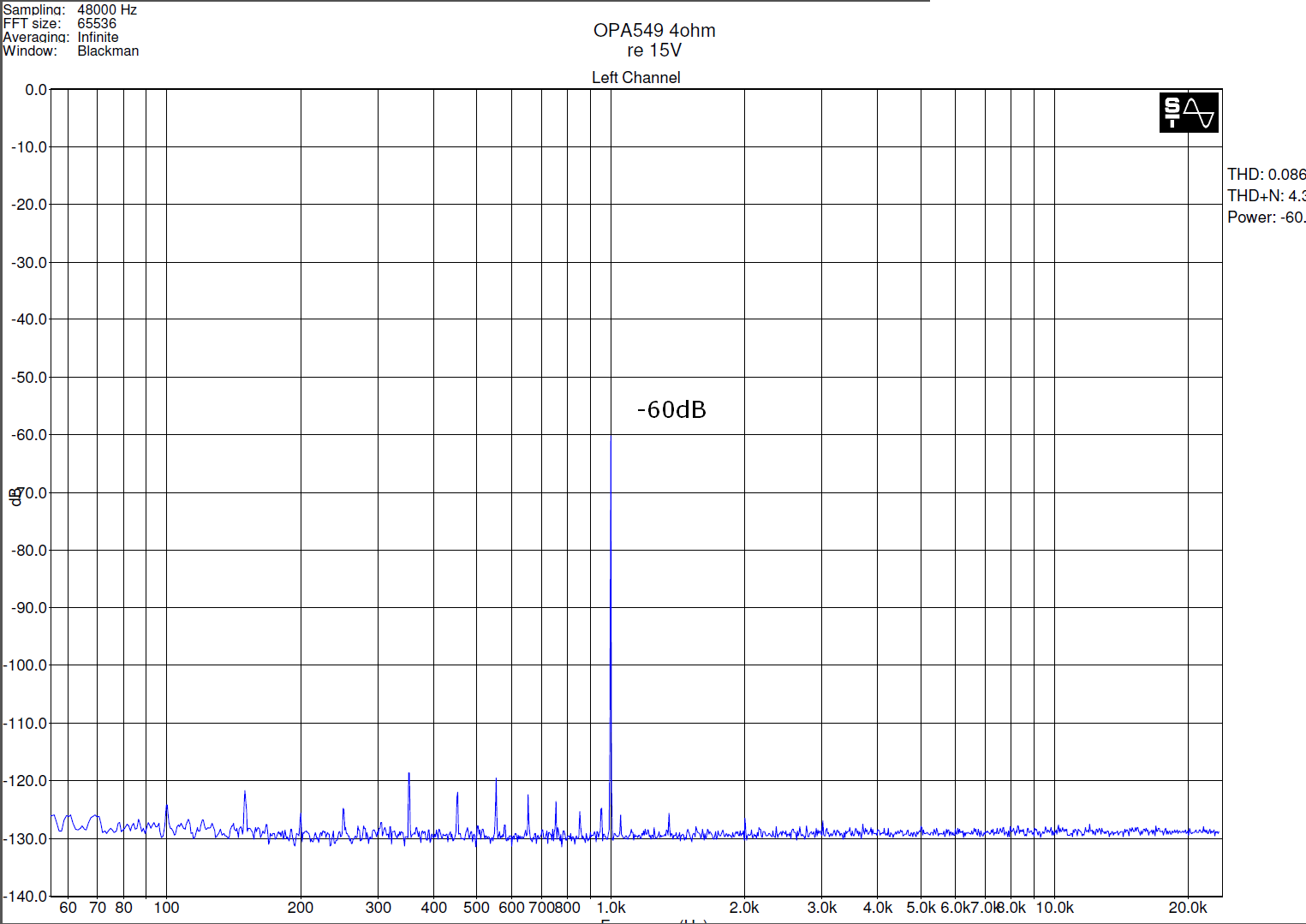

Yes, but it is all about audibility threshold, not only about the fact of crossover distortion. Please see plots for -60dBFS, -40dBFS and -20dBFs level. Please also note how the chipamp PSR reflects in mains components increasing with level (higher PSU ripple).

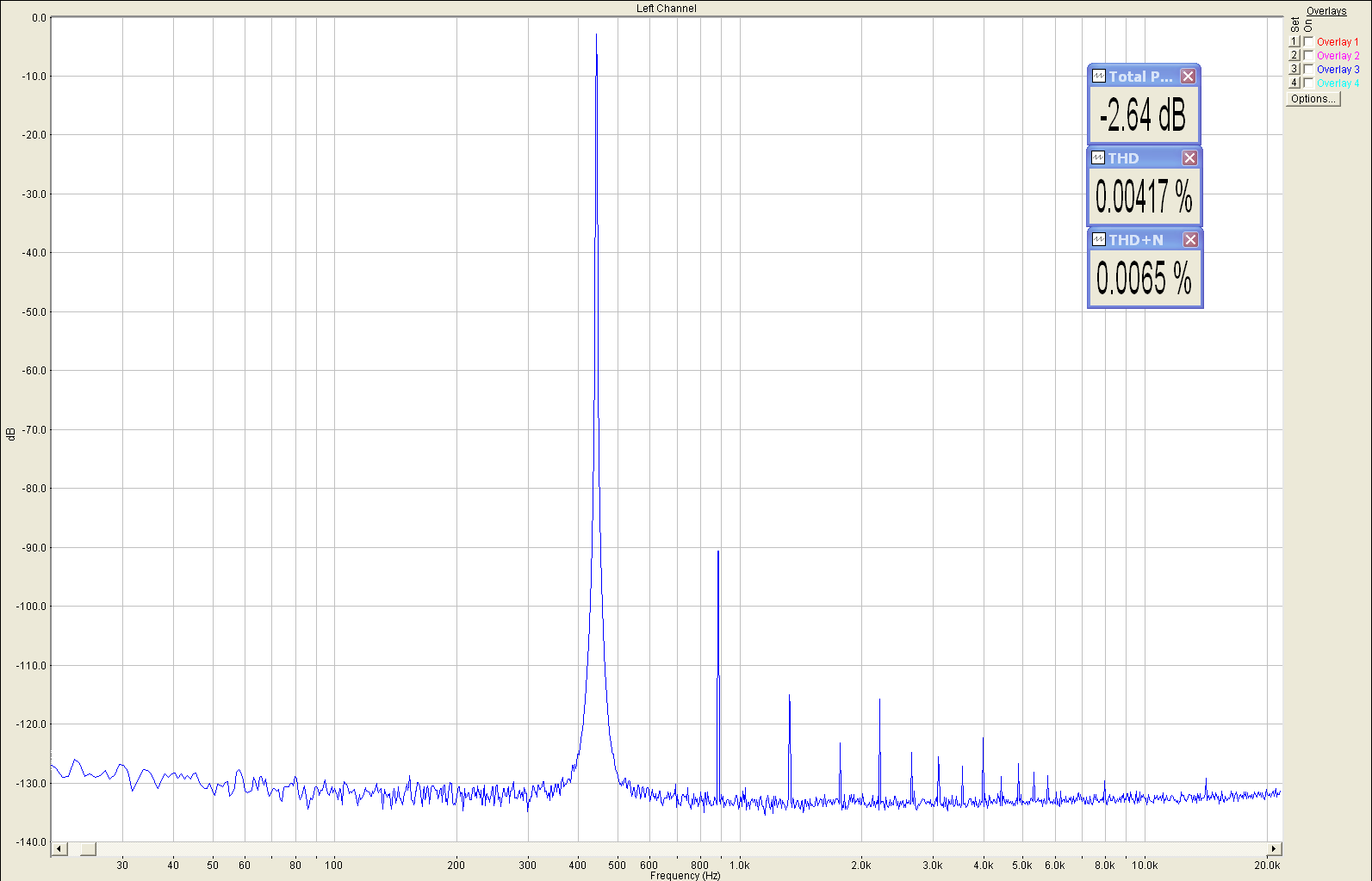

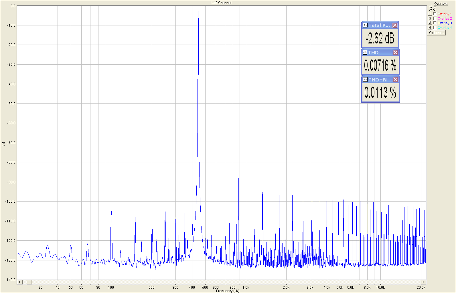

Well, this is the last one I am was willing to create and post
- 440Hz sine, digitally generated
- orig recorded as a loopback
- opa549 recorded through the amp under test
- polarity is correct
- level matching within 0.02dB
- files are TPD dithered and processed in Adobe Audition (fade-in, fade-out)
- file level is about -2.5dBFS
http://pmacura.cz/440_549.zip
At 440Hz, the amp crossover distortion has fallen to 0.008%, so it will be absolutely impossible to discern files by listening, unless one has faulty D/A conversion with nonlinearities and glitches.
