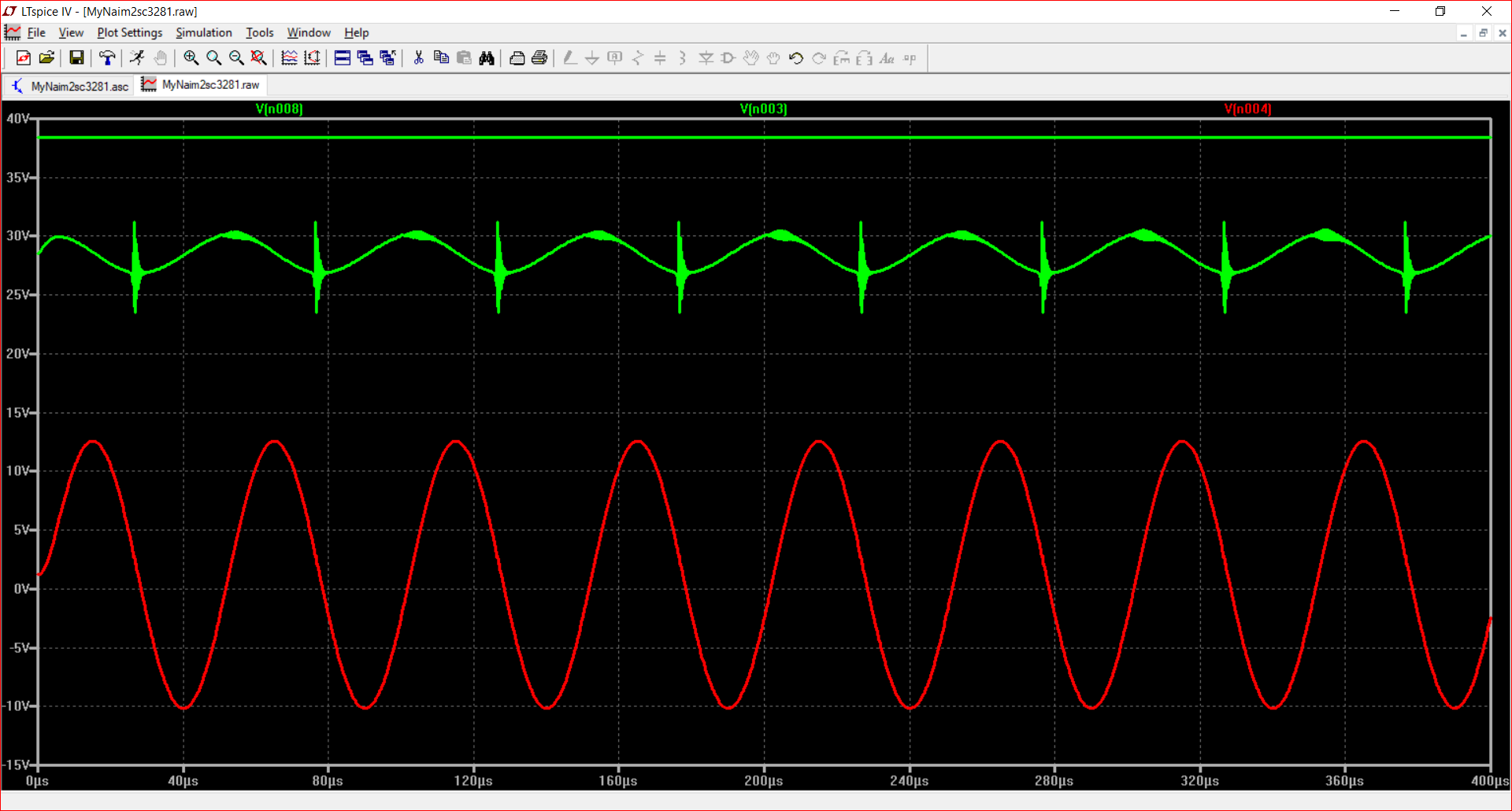

I have adjusted the output standing current to clean out the spikes in my previous simulation as shown attached.
The FFT result corresponding to this is also attached.
The first of these two simulations is too distant to see what contributes to the FFT result. The 22k collector resistor and the step network in parallel with the feedback resistor add fine tuning.

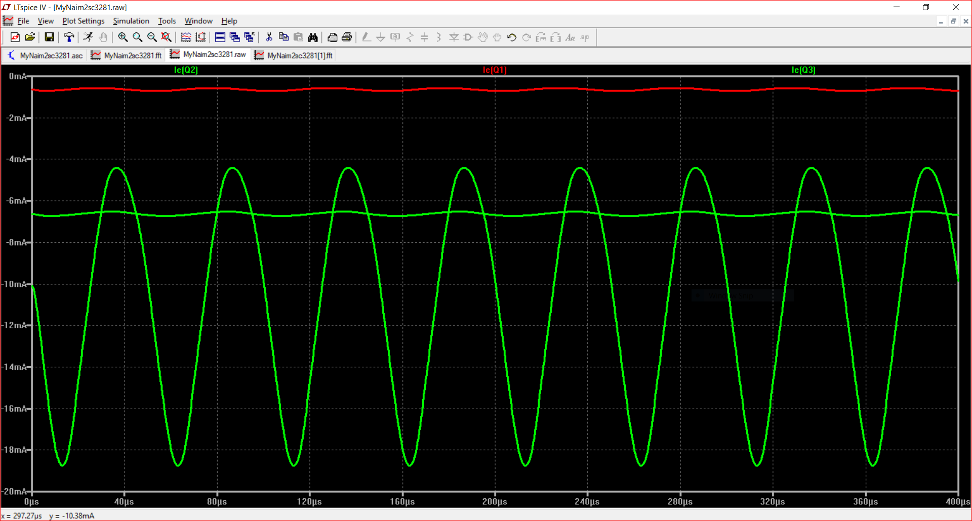

For a closer view I simulated the emitter currents for Q2 (feedback)and Q1 (input) separately to see how closely the respective current peaks aligned with each other in the time domain.

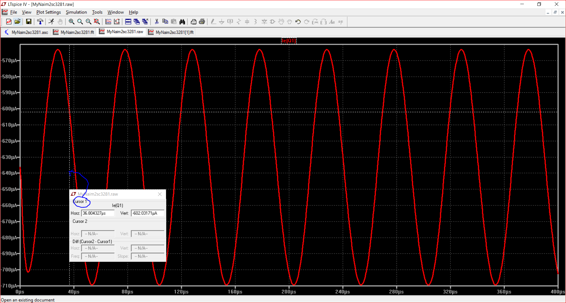

I looked at Q2 first and there is a peak in the current at 36.8us - see the cursor and result box for detail.
I then looked at Q1 at 36.8uS and set the cursor at that point - more on this in my final summary.
Further the variation in current over the operating range for Q2 was 14.4 m.A. while that for Q1 was 146 u.A. so of the pairing Q2 is more dominant - thrusting in opposition to Q1.
Over a 146 u.A. current operating range Q1 will be working over a smaller distance on the gain plot line - the flatness between two points giving a more linear output.
Anyway, at 36.8 uS the cursor for Q1 lays nowhere near any peak in Q2.

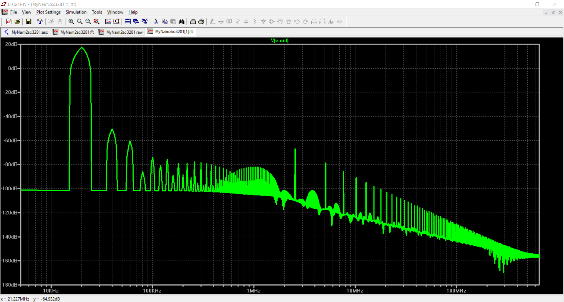

I think at this level of detail you have to double check the simulation parameters or the FFT can get difficult to work with. This includes ensuring the FFT window stops and starts on whole waveforms with enough points and after enough time steps etc. This is far from my area of expertise but there’s been some discussions about this and looking at you plots reminded me of the topic.
I re-ran the test with a start time of 200uS as per Bob Cordell's tutorials for 20kHz sine wave and THD. . The simulation I used was set up for square wave testing. In adapting this for sine wave I omitted the THD .commands - so much for that short-cut, I should have seen better.
The amended FFT is attached.
