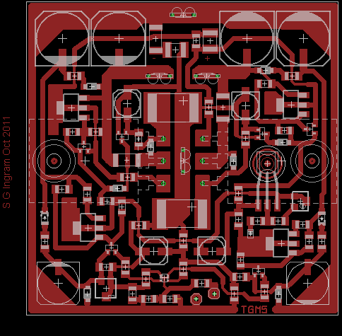

The parts have arrived, plus I have a final pcb layout.
Bigun, You made the smallest board for this Amp. Beautifully looking neat small PCB :cheers:
Can't wait to order the parts and try it also, can You make a list of the parts You order and the suppliers You chose?
It's really neat size, ... will nicely fit inside my actives as an TW and MID amp and with 2 OPs pairs
maybe also as Woof amp.
Waiting Yours impressions . . .. :yes:

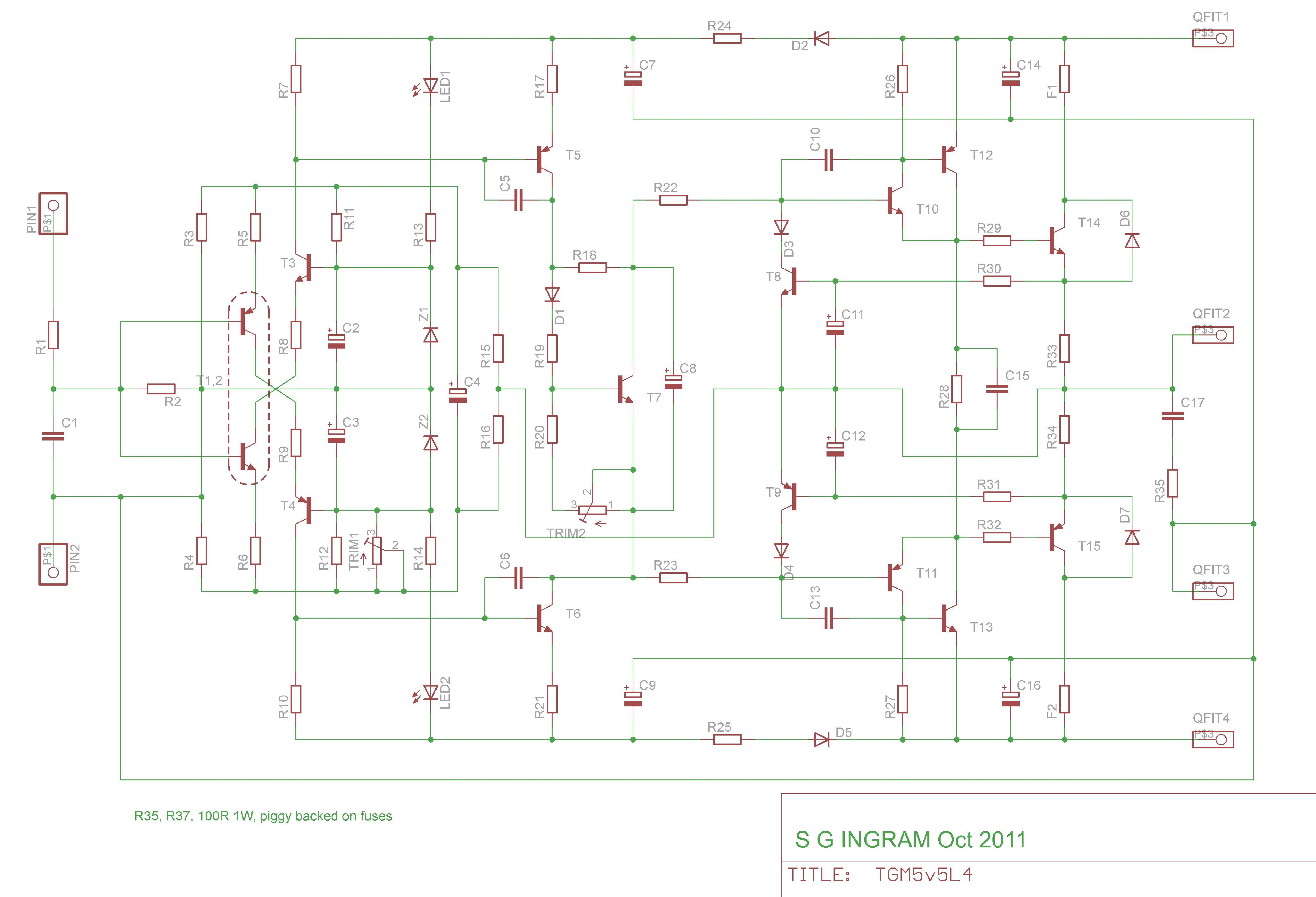

Final parts list may depend on tweaking etc. but I'll start by posting the final schematic used for the pcb layout.

Yes, I included an optional current limiter. It's not intended to protect the output devices from naughty speaker loads. It's there to give some chance of survival in case of an accidental short whilst I muck about with it. It's designed to stay out of the way - it's formed with an RC filter so that it offers protection at subsonic frequencies, i.e. it's NOT a VI limiter.
SOUND-Rays, parts list is something that may change - after all I haven't shown that this thing works yet.
Before committing to the PCB, you could streamline the schematic: some of the components are essentially useless, and could be eliminated, or reused to improve your input stability problem.
The cascoding brings no benefit here, which means T1,2 can be dispensed with, by entering directly on the bases of T3 and T4.
Eliminating those superfluous components should slightly improves things, or at the very least be neutral.
And if you want to keep/reuse T1, 2, you can use them as a diamond input buffer: they will raise the input impedance and thermally compensate T3 and T4, which can only be beneficial.
