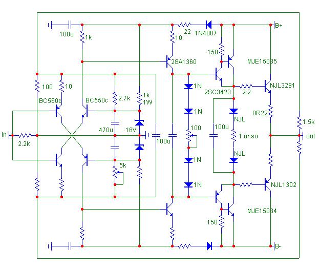

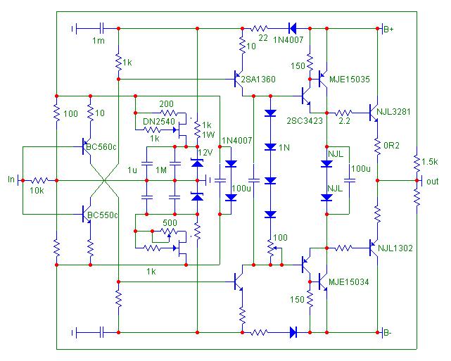

I posted what amounts to a Thermaltrak version of the TGM5 over in LC thread.
http://www.diyaudio.com/forums/atta...etrical-amplifier-ssa-mihai-output-buffer.jpg
Playing around with the TT diode bias spreader (no series resistor), I found that at about 30mA current I get about 18mV over the 0R2 emitter resistor. At 50mA through the diodes, I get about 30mV over the resistor, and at 100mA the output bias increases to about 55mV. Bias current would be 90mA, 150mA, and 265mA, respectively. Nothing earth shaking there, but here's the question:
I've read that optimal AB bias is around 18mV at the emitter. But in order to get that for this schematic, I'd have to reduce the current through the CFP driver to around 30mA. So what are the trade offs here? Or, can I just push more current through the outputs with impunity (assuming adequate cooling)? And, what should be the minimum for the CFP driver?
