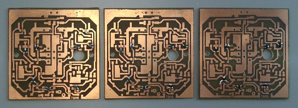

TGM5 prototype PCB you've made is simply gorgeous, I'm impressed how good this toner transfer method is, excellent for DIY-ers. Now you are on the fast lane to make a very good amplifier. I looked over your schematic again and I don't see any problematical spots, only you will have to play a little with Miller compensating capacitors. I hardly wait to hear the news about results.
Regards, Andrej
Good to know the schematic is approved, gives me confidence to build all 3 boards.
I took a look at my soldering iron and realized I stand no chance of soldering the SOT 363 part with a 40W iron that has a tip larger than the part itself. Luckily, I know a kind lady who does this kind of work.

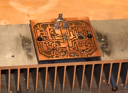

The heatsink has been drilled and 'tapped'. Photo shows the centre channel board (power devices are sandwiched between pcb and heatsink but not yet soldered to the board).

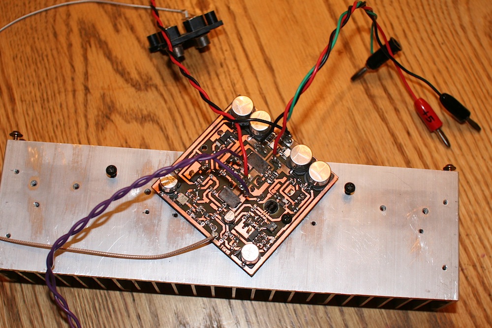

The short was readily identified and rectified, no harm done. The zener diodes are now holding a nice stable voltage. Had I checked for shorts first time around it might have been a 'straight out of the box' experience so I'm quite satisfied.
I've installed the on-board 4A fuses to the power device collectors - they solder straight on top of the 100R resistors I had there before.
The dc offset at the output appears stable and negligible (after adjustment), idle current has been set at 88mA or so and I'm going to see how stable it is (idle current looks stable over a 20 minute window). The board and components are nice and happy sitting a little above room temperature.

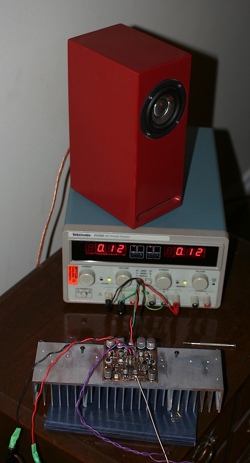

She sings very nicely indeed - I hooked up a 50k volume pot, using Magnum Dynalab FM tuner source, playing through my own design MARTELLO speaker.
