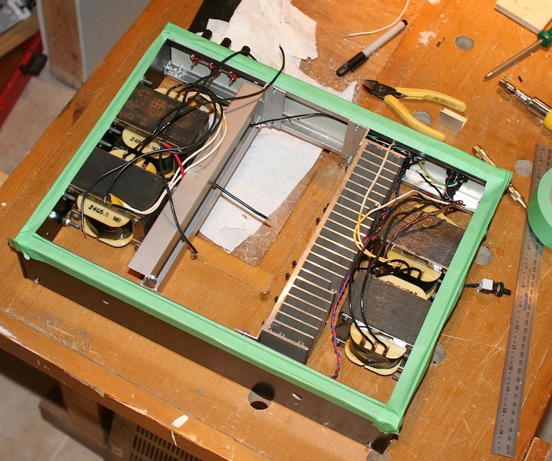

Lots of cutting and drilling going on today - making progress with the Chasis. Installed the heatsink on a pair of DIY flanges. Also installed some L-bracket that I can mount the PSU pcb on when it's ready.

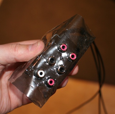

RCA inputs also assembled, 3 dc-connected inputs and 3 ac-connected inputs via some nice 2.2uF capacitors I had been saving up for his. It's a point-to-point wiring job on this one but it will give me the chance to dc or ac couple depending on the source.

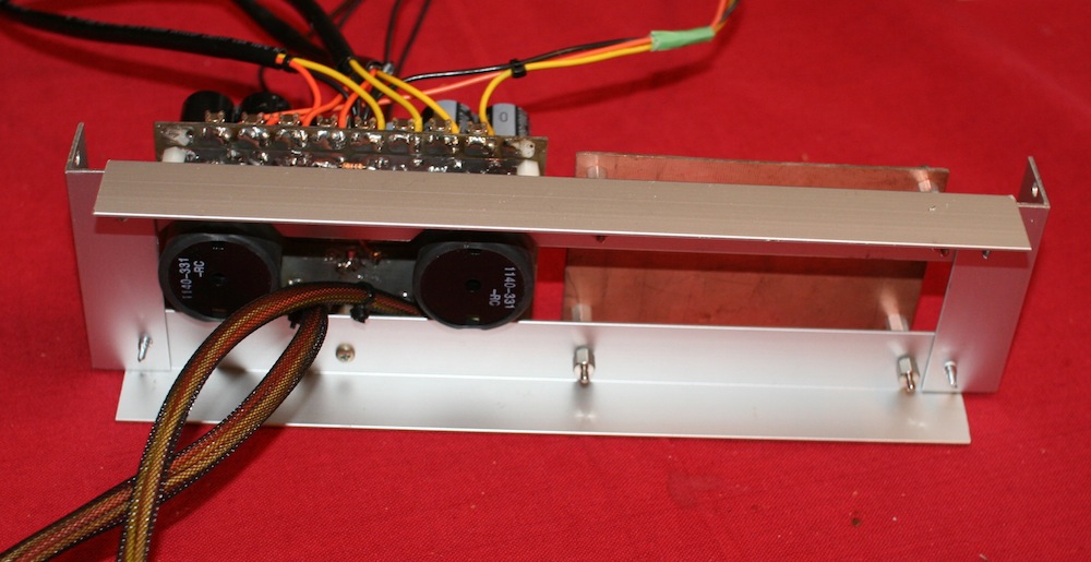

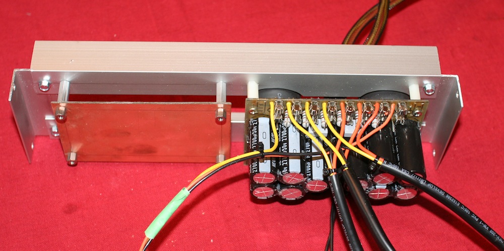

The power supply is coming along now...
Basic C-L-C, each C includes a parallel 150nF film cap. Soft recovery rectifier diodes, separate rectifier for +ve and -ve rails. Rail inductors are heavy duty 11A 0.33mH mounted on the back of the board.

The unused pcb next to the power supply is for future use - most likely dc-protection circuit for speakers.

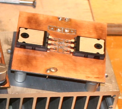

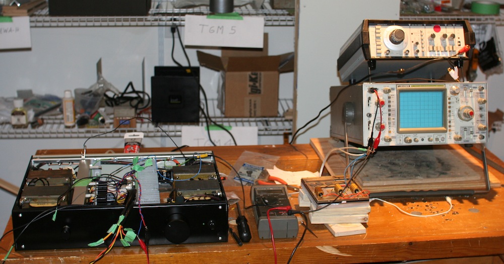

I had some bother last night when I powered it up - smoke released from a resistor and destruction of collector fuse on -ve side of amp. Replaced resistors and fuse. I thought it was parasitic oscillations from the CFP driver, but today I measured a short from -ve rail to the heatsink. Not sure of the cause, I dismantled the amp from the heatskink and reassembled it after cleaning around the pcb mounting holes, removing a piece of swarf. Seemed to fix the problem.
Got the CRO out. Clean 1kHz square wave with (8 Ohm) and without a load. I wasn't brave enough to try the square wave + capacitor-load torture test yet - I'd like to hear it again before I blow it up.

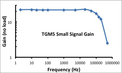

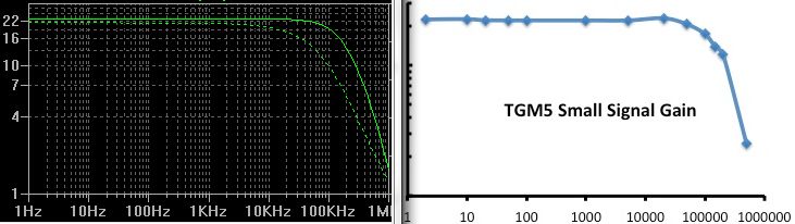

A quick look at the overall gain is attached (measured at discrete points from 2Hz to 500kHz) - the input filter rolls off the signal before it triangulates - and that happens past 0.5MHz....

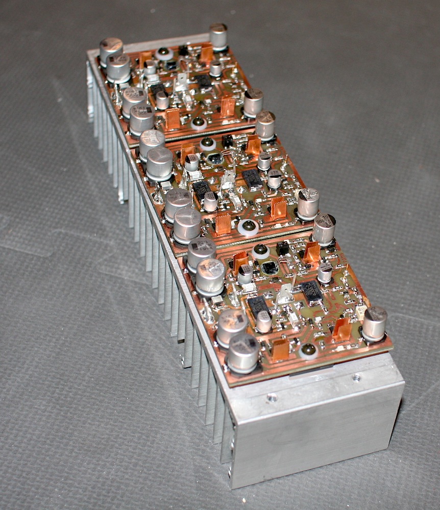

Hi Gareth, really a great job. I particularly like your surface mount heat sinks. The three PCBs actually fits your heat sink perfectly, was this planned or coincidental
Thank you!
Yes, the pcb size was planned to make use of the heatsink I had ... I like to recycle and this heatsink came out of an old Onkyo amp (the same amp also donated the bottom panel and cover to the chasis, plus the volume and centre channel volume pots); the mains fuse, IEC power connector and trafo's all came from two old Acopian power supplies, the psu pcb from my earlier TGM project and all the internal wiring from old computer power supplies

Gareth, nice build progress. Is the bandwidth you measured following the simulator? I understand it should be lower than using cascode, but is it following the analysis? Not that there is a problem, but to know if the models follow satisfactorily.
Thanks !
Well I'm not sure my measured gain curves are that accurate, but I've run the simulation with current parts values and I've attached a snapshot of the simulated plot alongside my measured curve. Not sure I understand your question on cascode - but to confirm: I am using the full Hawksford front end, as proposed by LazyCat, which incorporates cascodes to the input devices.
It looks as if my measured results are close to the simulation and the overall gain is spot-on (x22 = 27dB). I'd have to check back to my actual numbers - I only have access to the plot that I posted right now.

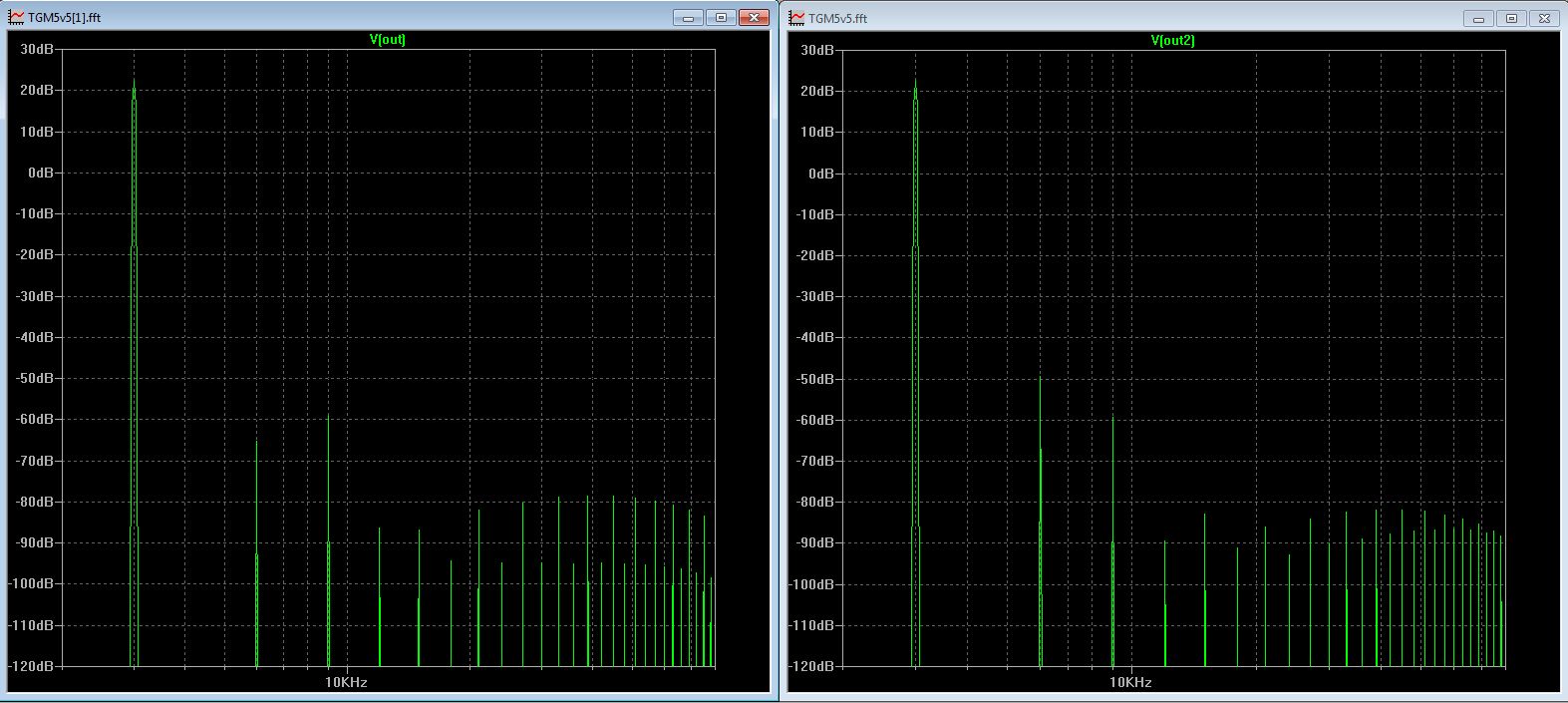

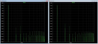

And now for something controversial. Do I want the amp to be fully symmetrical ? The original SSA thread talked about a dominant 2nd harmonic, but simulations say otherwise if one has reasonably well matched devices, something the all-BJT version approaches much more closely than is usually possible with FETs.
Would it be better to tune the behaviour slightly so that we know the amp is slightly asymmetric and to do it in a controlled manner so that it's consistent between channels. Why would I want to do this ? - nominally I prefer a Hiraga-like sequence of falling harmonics with 2nd slightly higher or equal to 3rd.
A little asymmetry in the value of the series feedback resistors is all that is needed to fix a controlled amount of consistent asymmetry in the waveform. Simulations indicate that it's a clean method of doing so, it doesn't exacerbate the higher order harmonics - a problem with the behaviour of TGM1.
Attached shows the harmonic profile at 1kHz, +/-1V input into resistive load. The plot on the left is the output for the symmetric amp, the plot on the right for the 'tuned' amp.

I don't agree with such a method: increasing pair distortion to hide impair ones.A little asymmetry in the value of the series feedback resistors is all that is needed
Better to work on the curents and poles bandwitchs in order to reduce higter ones:
