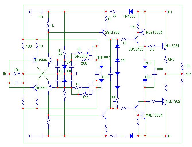

Glad I asked. Show what happens when a rank amateur plays. Good thing it's only lines on the screen. OK, front end from post 1339 in the SSA thread (except non complementary current source pair) http://www.diyaudio.com/forums/atta...ymetrical-amplifier-ssa-amp-basic-mos-fet.jpg - back end from Mihai:
Note: Looking at the top half, I tried to copy your current source LC, but it seems reversed to me. Have I got that wrong?
Sheldon
Sheldon
Sheldon, is your top branch depletion CCS correctly oriented?
I don't think so, but I copied LC's orientation. I think they might be reversed on that schematic. I think it should be like this:
Sheldon
Sheldon
No, I use p and n channel J-FET's but as I see I somehow reversed the p and n position.

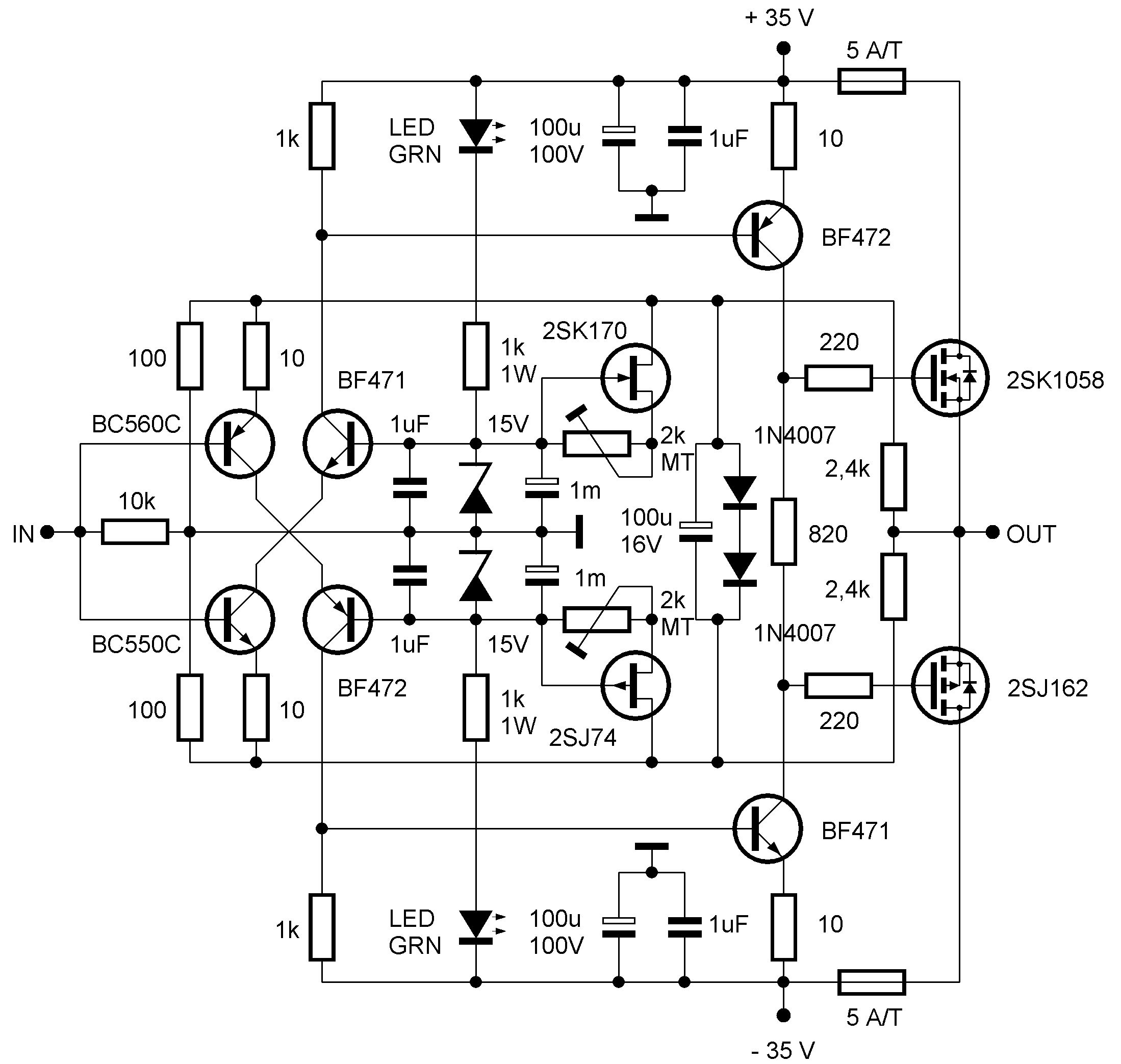

Look Sheldon If you would still like to omitt cascodes from input pair, there is already tested solution from Christophe's (Esperado) Crescendo sch. Only that instead MOS-FET output stage you can incorporate output triple BJT stage.
P.S. Christophe did a great job on implementing SSA bridge feedback to a standard, most common front-end. In this way any symmetrical front-end can be SSA modified to low Z (current) feedback. Advantages are quite obvious from his measurements and subjective listening experiences.

Sorry if I was not too clear. I copied the top half of your schematic, but used depletion mode devices for both top and bottom.

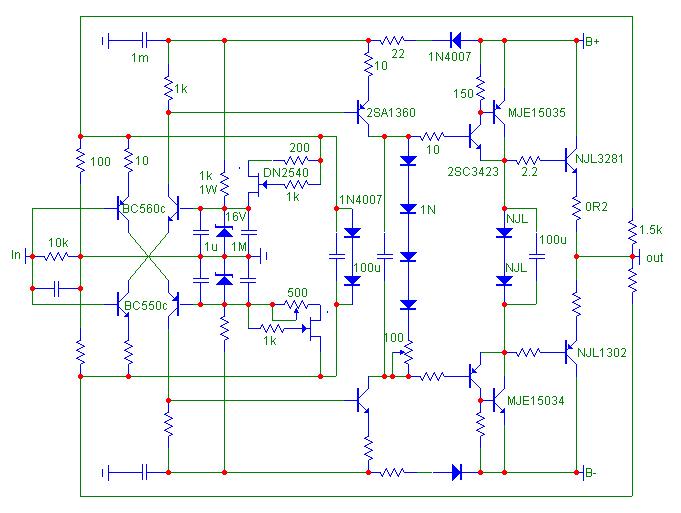

I am not against the cascode, just playing with the schematic to understand the possibilities. Is the last version I posted OK, at least in principle?
Sheldon
Yes, both n type fets as adjustable current sources. They're well placed in your sch, only that I don't know if 1k gate resistors are necessary in CSS.
Sheldon
Sch is in general OK, only in series with two NJL diodes there should be a resistor defining correlation between driver-output quiescent currents. Now as it is, the amp would be B-class biased no matter of the 100 ohm trimmer resistance setting.
Others have recommended stoppers for the DN2540, due to the high transconductance. I'm not qualified to judge, so put them there as a precaution.
That's true at low currents through the TT diodes, but apparently not at higher currents. See my post 138: http://www.diyaudio.com/forums/soli...imple-symmetric-amplifier-14.html#post2775971

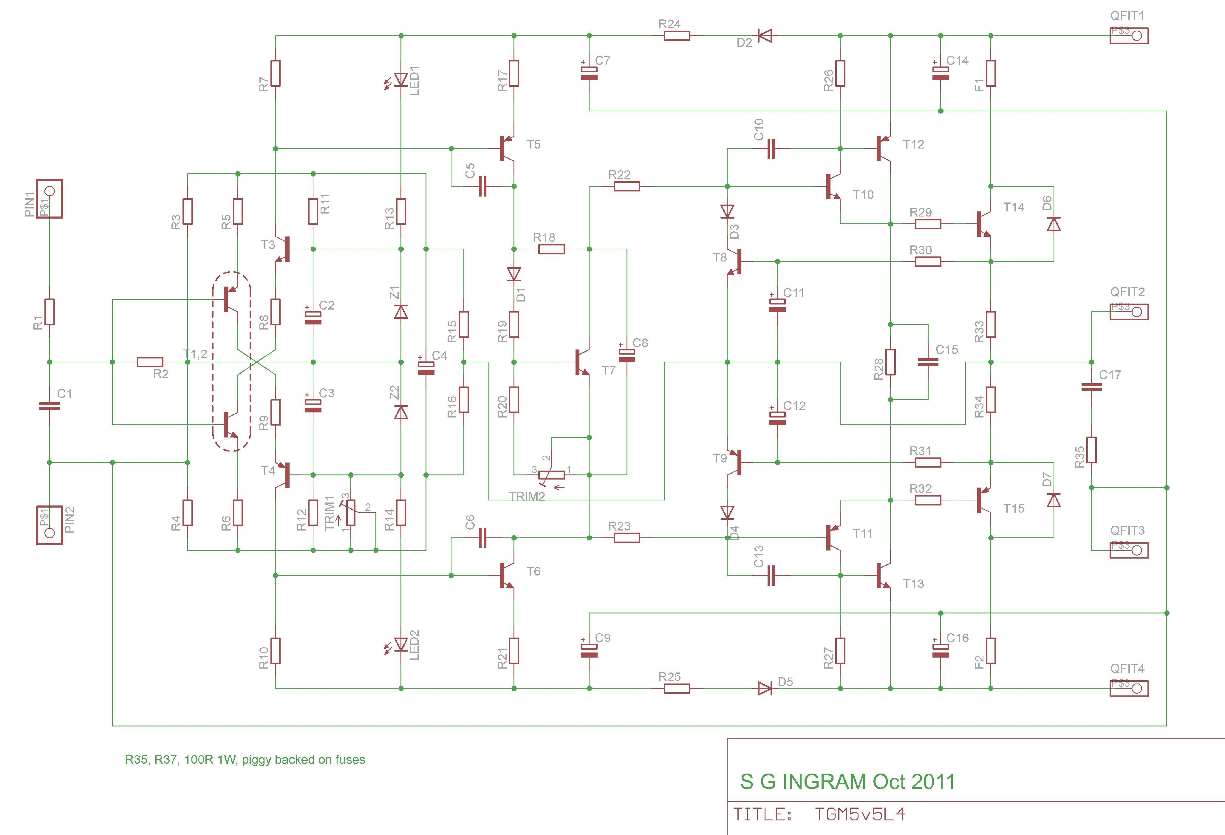

I posted what amounts to a Thermaltrak version of the TGM5 over in LC thread.
http://www.diyaudio.com/forums/atta...etrical-amplifier-ssa-mihai-output-buffer.jpg
Playing around with the TT diode bias spreader (no series resistor), I found that at about 30mA current I get about 18mV over the 0R2 emitter resistor. At 50mA through the diodes, I get about 30mV over the resistor, and at 100mA the output bias increases to about 55mV. Bias current would be 90mA, 150mA, and 265mA, respectively. Nothing earth shaking there, but here's the question:
I've read that optimal AB bias is around 18mV at the emitter. But in order to get that for this schematic, I'd have to reduce the current through the CFP driver to around 30mA. So what are the trade offs here? Or, can I just push more current through the outputs with impunity (assuming adequate cooling)? And, what should be the minimum for the CFP driver?
Digging around a little more, I think I may be able to answer my own question. I realized that this version of the FC100 output buffer differs from the original, only in that it has a single output pair. Therefore it requires only 1/3 of the drive current to the outputs. So something on the order of 30mV current through the drivers and diode bias string is plenty to maintain class A operation in the drivers. Seems like this can work out with reasonable values. Of course, I can add series resistance to the diode string if I want to use less current in the drivers, or if there is an issue with TT diode variability.
The one issue with this is that the variables (driver current and output bias) are not independently controlled, so part variability could be an issue. And I don't know if changing the driver current values will change sonics.
In summary, I think I can achieve optimal class B bias with reasonable current through the drivers, using this TT biasing technique. If I want to run much more class A in the outputs, I can either run more current through the drivers, or add some series resistance to the diode string.

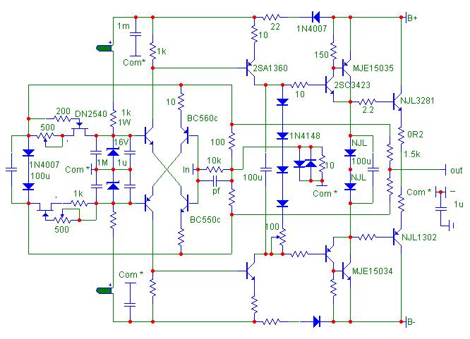

Meantime, my latest schematic versionl. May need a resistor in series with TT diodes, depending on driver current. Final determination, once assembled. Also may need compensation for the drivers. I plan to more or less follow the schematic diagram for the physical location of parts.
I've checked this, but may have some mistakes. Sometimes I have to wait a day to find them, after looking at the schematic too long.

I think the CCS devices will themselves have a temperature sensitivity; the VAS devices are also temperature sensitive, not as much as the input pair but still enough to change the current through the bias diode string. I'd run it through spice to see how all these things add up and then decide if you have the right temp comp scheme or not.

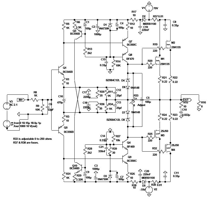

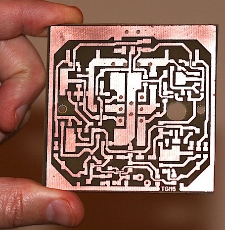

I've made some progress. I printed out my pcb design onto glossy paper, Oxford University magazine seems to work best, with printer on 'transparency' setting.
I chopped up the 6" x 6" shiny new double sized pcb into 4 equal(ish) squares and using the wife's clothes iron I transferred the pattern to the pcb (after cleaning said pcb with wire wool and acetone). It worked pretty good but I noticed two issues. a) the pattern was reversed, I forgot to print out a mirror image
and b) the traces expand / squish under pressure of the toner transfer process and closed up the spaces between the legs of the SOT 363 part. I had expected I would have to calibrate the design to my production method.
So I reduced the pad and trace sizes for the SOT 363 and drove back to work to re-print it mirror imaged. The next transfer worked better and after touching a couple of spots with a marker pen and covering the backside with protective sellotape I committed it to a bath of etchant.
And half hour later the cake was baked. A clean in acetone and a shiny new board was delivered to the world
I've since drilled the holes called for by the design. Photo attached...

Hi Gareth
TGM5 prototype PCB you've made is simply gorgeous, I'm impressed how good this toner transfer method is, excellent for DIY-ers. Now you are on the fast lane to make a very good amplifier. I looked over your schematic again and I don't see any problematical spots, only you will have to play a little with Miller compensating capacitors. I hardly wait to hear the news about results.
