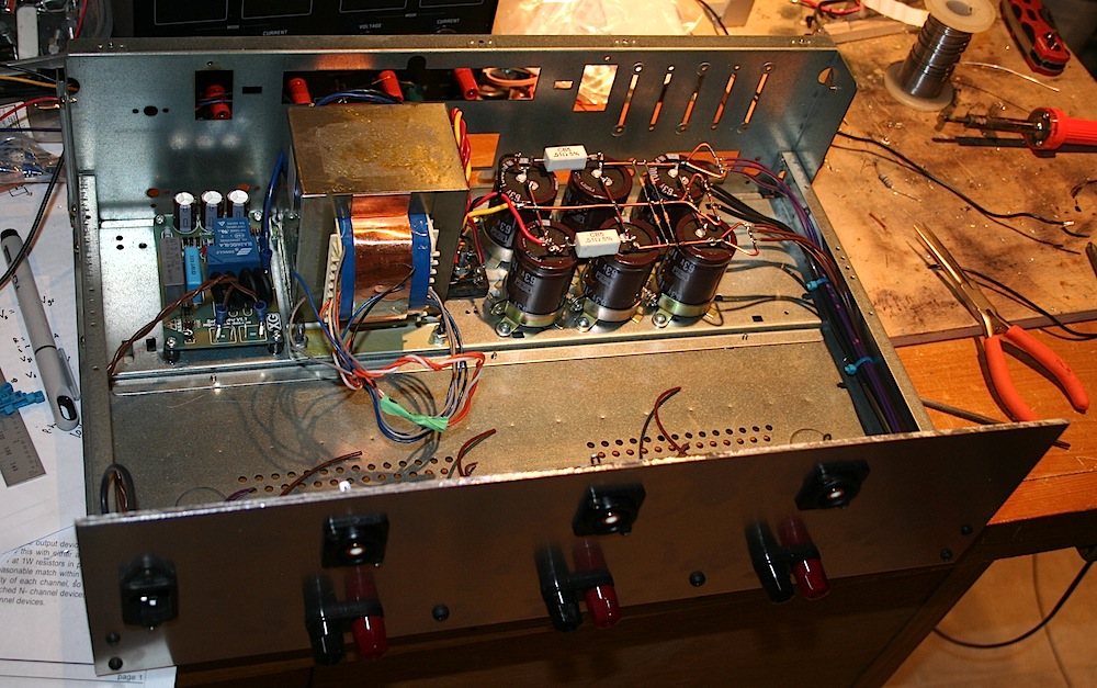

Well I have been distracted building a pair of speakers for a friend, a rather nice pair of Pencil's using the Alpair 10.3. I like this driver.
Anyhow, slowly getting back to the amplifier as day job permits. I'm recycling an old Fisher stereo chassis, with transplanted power trafo, heatsink and new rear panel. I've had to move around some of the chasis pieces so it's a bit of a mongrel now.
But the soft start circuit, power trafo, bridge rectifier and filter caps are all installed. The main ground return and power rail wiring is in place. More bits to add yet - maybe at the weekend.

It's me that needs the belly band
Actually it was there when I took it out of a Pioneer HT receiver. I was quite impressed to see that it had one. I like them - I fitted them to the trafo's in my tube amplifier.
I take your point about the gnd connection, that's something I may tidy up before I put the lid on. Hopefully soon. Right now I'm about to hand off a pair of speakers I built, my friend is coming around today to check them out and decide what else is needed.

Because I am not going to install the input capacitors there is always the danger that a bad source will result in dc at the output. So I am installing a dc protection circuit (conveniently mounted on the backside of the heatsink). This design is recycled from an earlier project and uses very low Rds-on MOSFETs as solid state relays and a circuit to turn-off the output if dc is detected. There are catch diodes to prevent damaging voltage spikes from back emf when the speakers are disconnected. No delayed turn-on included - will see if this is needed or not during testing.
Joined 2009
The belly strap runs underneath - it has to run around the outside of the E-core or else it would represent a shorted turn for the main flux and quickly overheat - clearly Pioneer would not make that mistake. However, there's a mounting flange under the trafo between the belly strap and the chasis. The electrical connection to the chasis looks like it should be good but I haven't checked it. I suspect it makes a reasonable contact with the chasis, which I would prefer to leaving it floating. The purpose of the strap is that it acts like a shorted turn for stray flux, the leakage inductance. Hence copper for it's good conductivity - the leakage flux generates a current in the belly strap which in turn generates an opposite field to the stray flux and cancels most of it out. Rather than rely on it to keep stray fields out of the amplifier I have positioned the heatsink between the power trafo and the amplifier pcb so that the amplifier is kept further away from the trafo - stray fields decay rapidly with distance. I have also designed the amplifier pcb traces with minimal loop area to reduce pick up any stray fields and the input wiring is short and also with minimal loop area.
Yes. From the photo it just looks like a flat steel cover on top but I wasn't sure if it was earthed as it could be isolated from the laminated core. I have a large transformer of similar construction I salvaged from an amp...that is, with the copper band. Waiting for a suitable project in which to use it. Might have a look again now yours has piqued my interest, as I'm thinking of building a second GB to biamp my speakers.

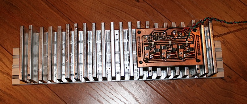

Well I've got things hooked up enough that I can power up in the chasis. Being rather eager and confident that it was working fine at 20V rails I plugged it in with fuses removed. Poof - little rising twirl of smoke from one of the 100R resistors I had mounted in parallel with the fuse holders. It isn't just a case that these resistors are under-rated but there was a lot of volts across it, instant frying. I removed the debris and removed the remaining 100R resistor under the other fuse holder. I won't be using them again, too fragile.
So I used a sturdier resistor connected to the empty fuse holder by crocodile clips (the other fuse was not removed). Still too much current and it was not adjustable. To cut a long story short, since last testing the amplifier out one of the power FETs appears to have developed a cold solder joint - a fragile joint as it turned out since it almost fell off the board. By desoldering and re-soldering it I was able to get things working again. Rather embarasing - I don't remember having a cold solder joint before. So I punished myself by accidentally picking up the iron by the hot end! ... hmmmmm
The amplifier is sitting on the workbench with about 60mA idle current per FET, no load and no input. Both fuses installed and measuring the bias current across the resistor in the power supply rail and across one of the FET source resistors. I am noticing that the bias adjustment gets very touchy when I try to go higher than 60mA per FET even though it was perfectly fine when being used with 20V rails. This is not a thermal issue, over the past 10 minutes the heatsink has warmed up considerably but current draw is rock solid. I suspect an oscillation so it's time to get out the scope.
Further work needed...
