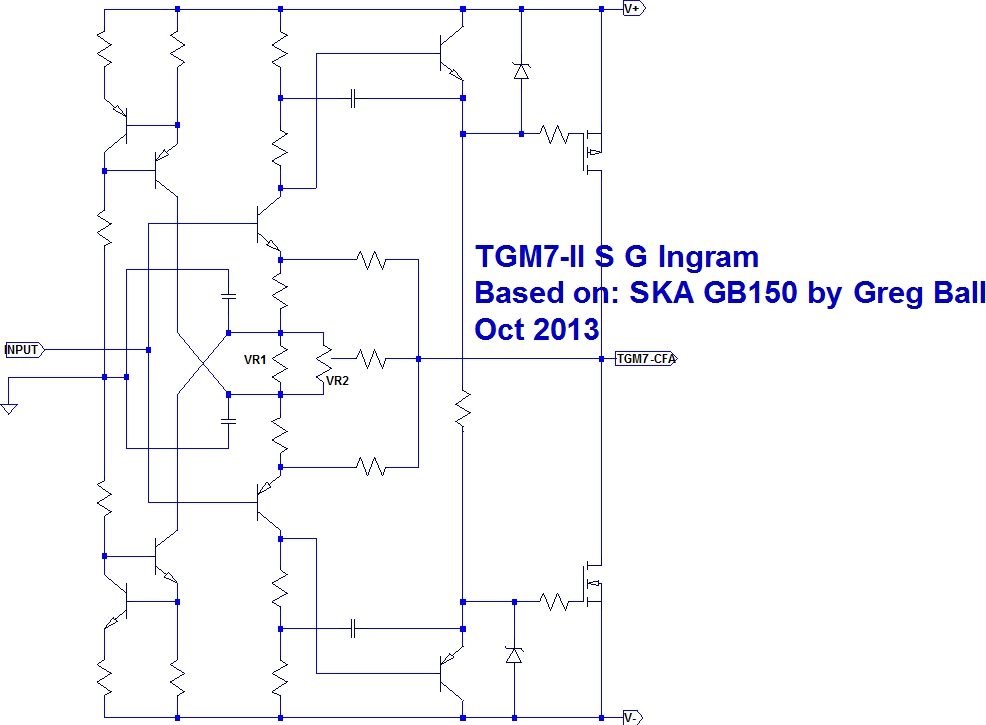

Hi Bigun
The feedback caps you alluded to ---is this C3 across R23 in your schematic on the thread 8 ?
thanks
kp93300
Joined 2009
Hi kp93300, yes I was talking about C3 across R23 in my schematic.

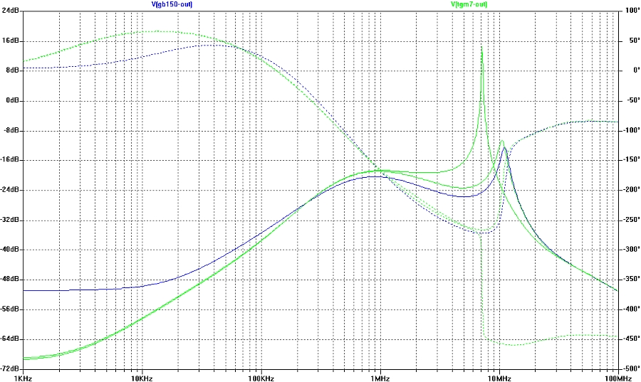

My spice simulation may have some issues - but I'm attaching the file for your interest. The plot shows the PSRR (with respect to the +ve rail).
I've attached the spice file so you can run the simulation. Note that it uses device models from Bob Cordell; I'd like to acknowledge his copyright.
I've attached the PSRR plot generated by the spice file. There are three curves in total (look at the solid lines). A PSRR of 0dB means that the noise on the power rail appears equally on the output of the amplifier. A PSRR of -60dB or better is a minimum requirement and is easily met over the audio frequency range. What I am showing here is the very high frequencies where there is an issue with a peak. A high peak here can result in oscillations. The current flowing at the output is drawn through the power supply and therefore the signal at the output can appear as a voltage drop in the power supply. And a phase change can result in this signal being amplified by the amplifier - positive feedback and resonance. This is how I am looking at it. A peak in the PSRR usually also has a sudden phase (dashed lines in the plot) change - indicative of resonance.
My model does not include stray capacitance and parasitic inductance, so the results are clearly approximate. But since I observed oscillations in the general range of the predicted frequency and was able to quench them based on the changes indicated by the simulation I like to think it's pretty good.
Looking at the PSRR plot:
Greg's GB150 is the blue curve. A slight peak at 10MHz. My TGM7 is the green curve and there are two versions. As-built the PSRR is the top green curve with the huge resonance spike in the range 7MHz to 8MHz. Nasty. After removing the 3k resistors from the unused collector legs of the LTPs I get the lower green curve. It is now closer to the baseline GB150 behaviour.
So the problem is eliminated when I remove these resistors and replace them with jumpers. No changes to the compensation are required.

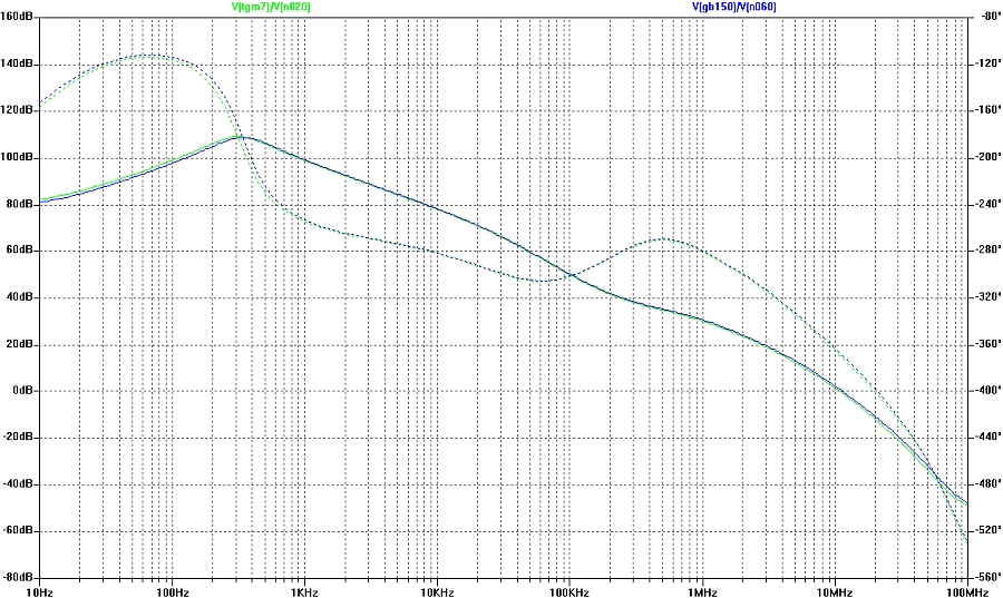

I'm not too sure that the way I examine the phase stability with an open loop gain plot is quite correct and would love to be taught better if possible.
I've attached the spice file I used for looking at the OLG and the plot that it produces. I am looking at the ratio of the voltages either side of the OLG signal generator that I've inserted into the global feedback loop.
It shows this amplifier has a scary amount of gain at high frequencies and a scary amount of gain at audio frequencies. If I'm looking at this correctly, I want to home in on the phase change (dashed lines) that accumulated before the open loop gain (solid lines) drops below 0dB. It looks like a 100 degree change between 1kHz and 10MHz. Looks OK to me.
However, without stray capacitance and parasitic inductances this is likely way over-simplified.
The slope of the gain line is indicative of phase.
At the zero crossing, it is said that the slope must be less than 9dB/octave.
Many suggest this should be less than 6dB/octave for a more adequate phase margin.
Your slope is certainly steepening as it approaches and passes through the unity gain frequency.
+105dB @ LF is in the normal range.
10MHz for unity gain is in the normal range.
I don't understand the reported 360degrees @ unity gain.
I haven't much experience with these guidelines but it's good to know. I will probably design some options into the next round of the pcb to allow me to reduce the gain at high frequency, I'll see if I can find a method (simulated) that reduces this steepening - although I do suspect the simulation is getting less accurate out there where stray impedances are not taken into account.
The phase at unity gain - I don't think this matters too much, it's the cumulative phase change over frequency that I worry about rather than the absolute phase.

Well I got to thinking about the amp design and whether to fiddle with it a bit more. The 10MHz resonance appears in simulations to be made worse because of the LTP input. Extra devices with phase shift catches up with you in end. So after being inspired by reading Gaborbela's thread I got to thinking about a singleton input, or CFA. I remembered something was proposed by fab here: http://www.diyaudio.com/forums/solid-state/239443-cfb-ska-hybrid-vssa-ska-amps-concept.html
I've been looking at this in more detail. My version is based more tightly on the GB150 but is pretty much the same otherwise. And I am now thinking that I may use this approach and re-spin my pcb for it.
It appears that the OLG has better margin at unity gain. The only downside is the need for larger caps in the feedback network and overall lower PSRR. The LTP simply does better with higher common mode rejection of noise on the rails.
I like that the CFA has a low impedance feedback node, so it won't pick up as much stray signal - perhaps more tolerant of pcb and chasis layout.
Trouble is with this symmetrical CFA type of topology is the potential for terrible bias stability with respect to temperature - which might kill this idea before it gets off the drawing board.
