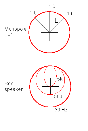

But there are some practical barriers (pun intended) to tackle in cross talk cancelling.
I don't get it how the 'box' you describe could provide some cancelling? If you listen from distance, say, 2 meters from speaker the angle difference of the paths from the speaker to each of your ears is so small the directivity of the speaker do not change enough to provide any amplitude difference.
well - frankly speaking I don't get it either
therefore I have nowhere never said that there is crosstalk cancelling
rather I have said that": "crosstalk is diminished" or perhaps even more precisely: "negative effect of crosstalk is diminished"
BUT this is of course just a hypothesis
in fact my aim was to create an ambiopole that would require minimal physical barier according to the formulas given by Ralph Glasgal
BUT to my surprise I discovered that in case of such "ambiopole" adding theoretically required physical barier leads to no perceptually significant change!
I was surprised but that was what I had found then
so frankly speaking I have no certainty as to the principle operating here
I supposed that it has to have something to do with directivity of box speaker, of a dynamic driver on a baffle (see picture attached)
