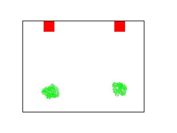

el`Ol said:I found the sweet spots for listening to synthetic productions with Carlsson speakers. They exactly form a square with the speakers. Finally a northern concept for us trolls![]()
so extremely off axis?
surprising!
I wonder what is the operating principle of this
best regards!
graaf

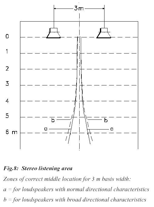

I originally posted it in "Loudspeaker perception" thread but the fact is that it is no longer "stereo imaging" thread and nobody seems to be interested in discussion these issues
anyway, continuing the question of "sweet spot" (aka "stereo listening area")
The stereo listening area is very narrow. For a basis width of 3 m, the listening area at a listener's distance of 3 m is only 21 cm wide (for loudspeakers with normal directional characteristics).
At 5 m distance it is only 38 cm wide (reverberation time about 0,5 s). For a larger basis width the listening area is even narrower. Loudspeakers with a larger radiation angle (spherical loudspeakers) increase the width of the stereo listening area by a factor of about 1,5; they have, however, the disadvantage of reduced sharpness of localization.
see: http://www9.dw-world.de/rtc/infothe...sound_perc.html
what can be explanation for this?
I mean "increase the width of the stereo listening area" with "loudspeakers with a larger radiation angle"?
on the other hand - have You experienced "reduced sharpness of localization" in Your extremely asymmetrical listening positions with Carlssons? if yes then how significant?
best regards!
graaf
When I listen to synthetic productions in the usual positions everything happens within two straight lines through my head and the speakers, so classic pingpong stereo, but with a sense of depth. Even the two perceived rooms are one-dimensional. Only the square position does a proper fusion of the two tunnels to a real three-dimensional room. There still happens less in the center, but this doesn´t sound un-realistic.

With real stereo-recordings the radiation angle of the Carlsson is very wide, but the imaging remains sharp. With synthetic reverb production it is the other way round: very narrow sweet-spot (the mentioned square) and more diffuse imaging. The CFS has a wide radiation angle as well. It has a slightly less sharp imaging, but still the reach out and touch effect. As mentioned the impulse response of the reflected signal is important. Synthetic productions have a large radiation angle as well, but impaired realism of the image that is clearly ahead of the Carlsson, however.
As mentioned only the Carlsson gives the feeling of being in a real room.
