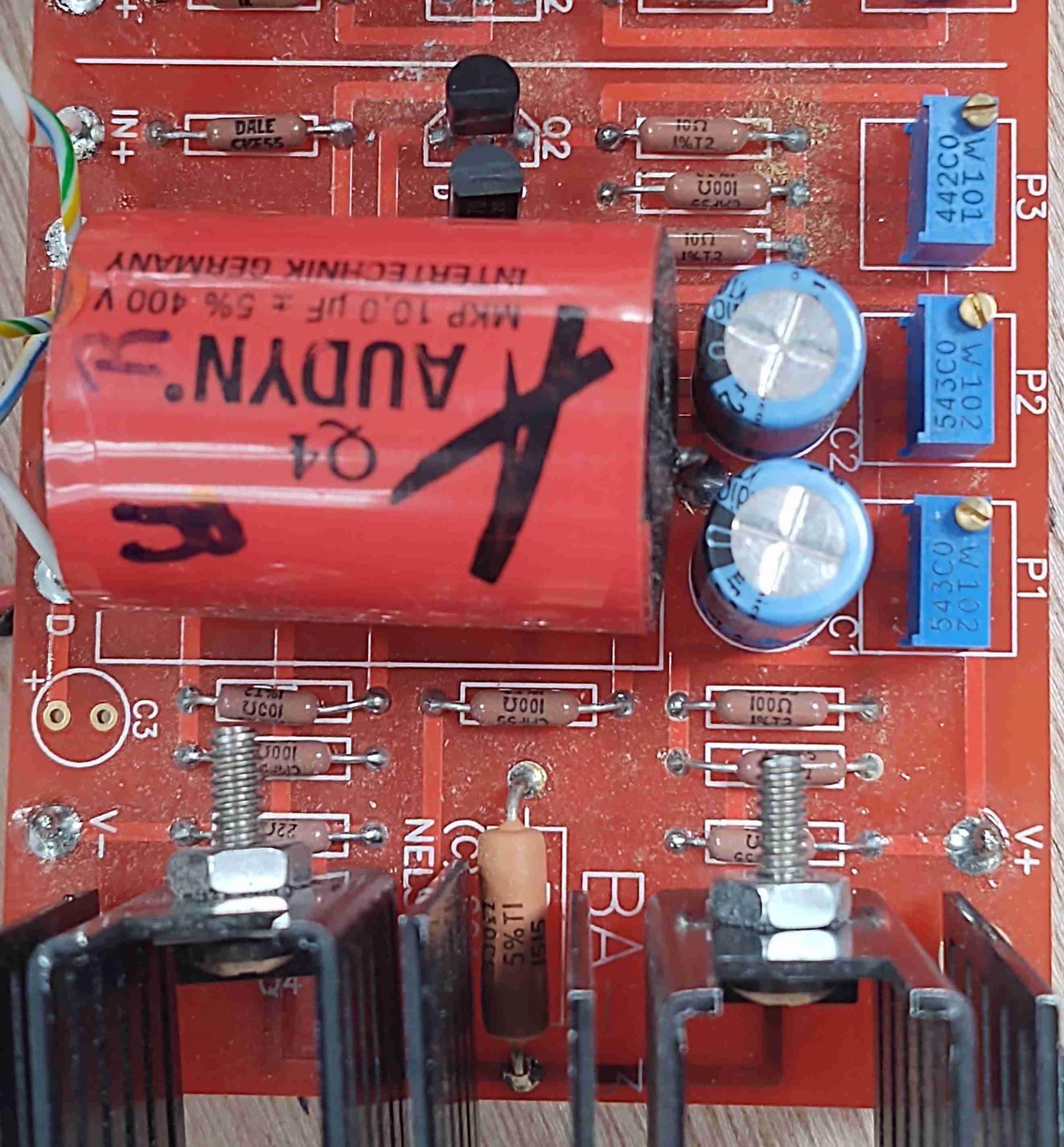

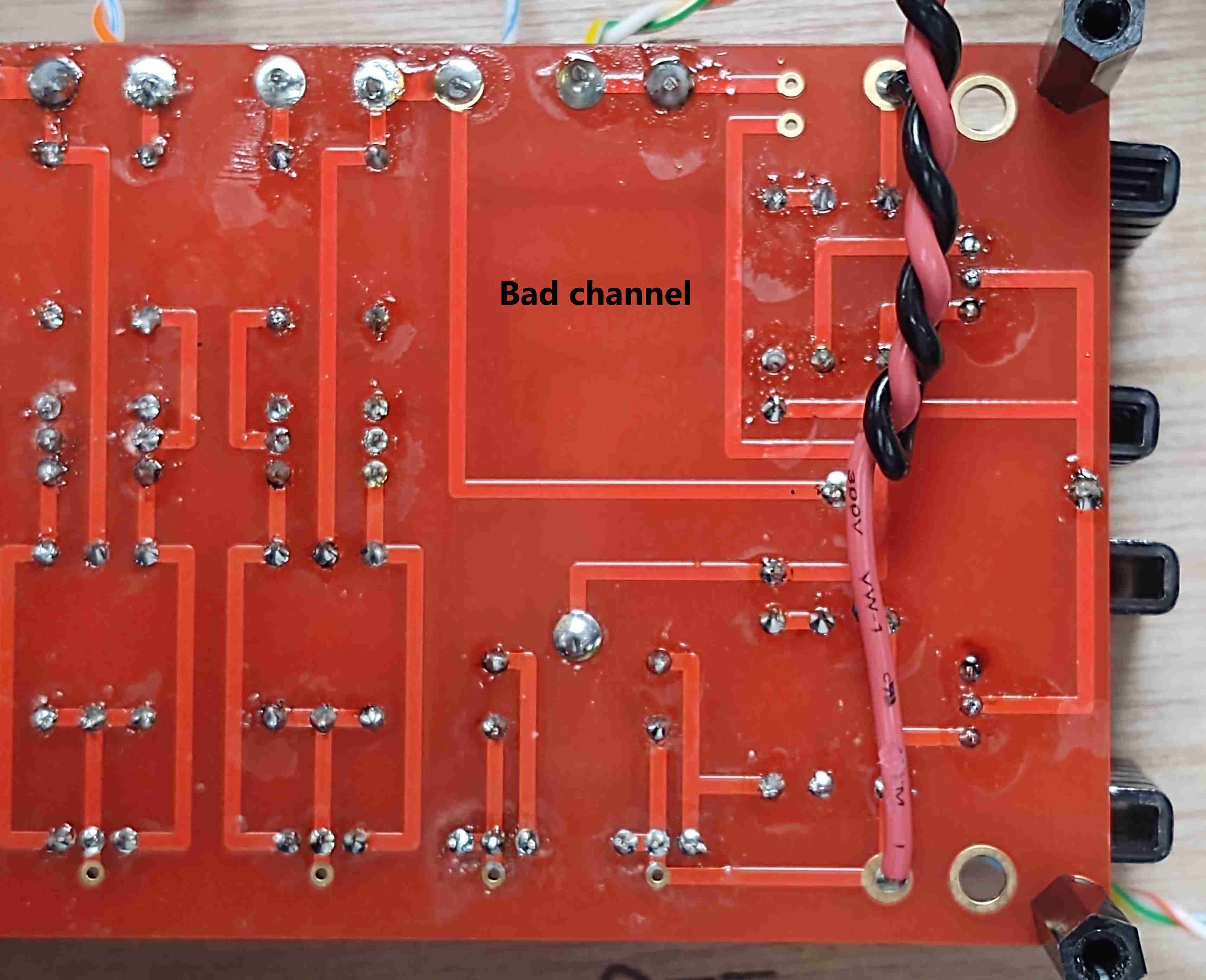

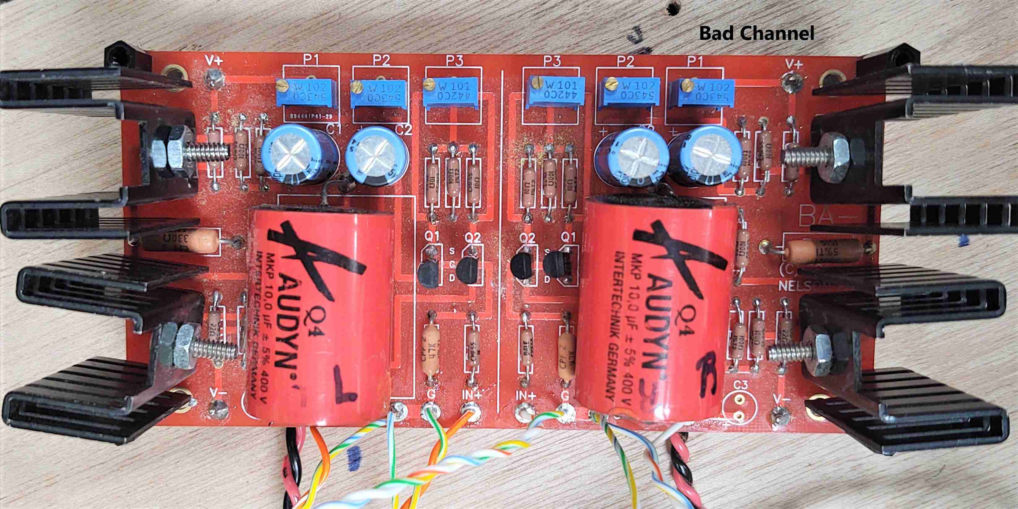

Here are some pics of the bad channel. My next step is to recheck all of the resistors to make sure none are faulty and then check the traces for continuity to rule out a board defect. I reflowed the board again, checked the output coupling cap and it tested fine. Continuity on both the inputs and the outputs from the bad side to the test set up were also good. If all goes well on the resistor recheck and board trace check, I'll retry it again and if she she still refuses to sing I'll try replacing Q3 and Q4 since I have spares. I didn't see any gross screwups on the installation just a lot of dust from sitting in the garage for 2 years. If you see anything I screwed up please let me know.

Hello PJN,
the values over the bias resistors of your 'bad channel' let me assume, that on the
board is everything o.k..
I would search for bad contacts/solderjoints at the volume pot, RCAs,....
before I would desolder the JFets or Mosfets. Measure resistance from RCA (hot / mid contact to the board input for low resistance - if volume pot is at full vol).
I would check the same for the output.

Success, I must have had a bad mosfet, replaced them on the bad channel with spares that I had and presto, music plays. I just bought a transistor tester to hopefully avoid this situation in future builds. Have it playing through an Aleph J in my garage and I'm impressed. It does have lots of gain which is what I wanted so it will be good with my M2 and F4. Now it's time tp put it in a proper case and off of the plywood test platform.
