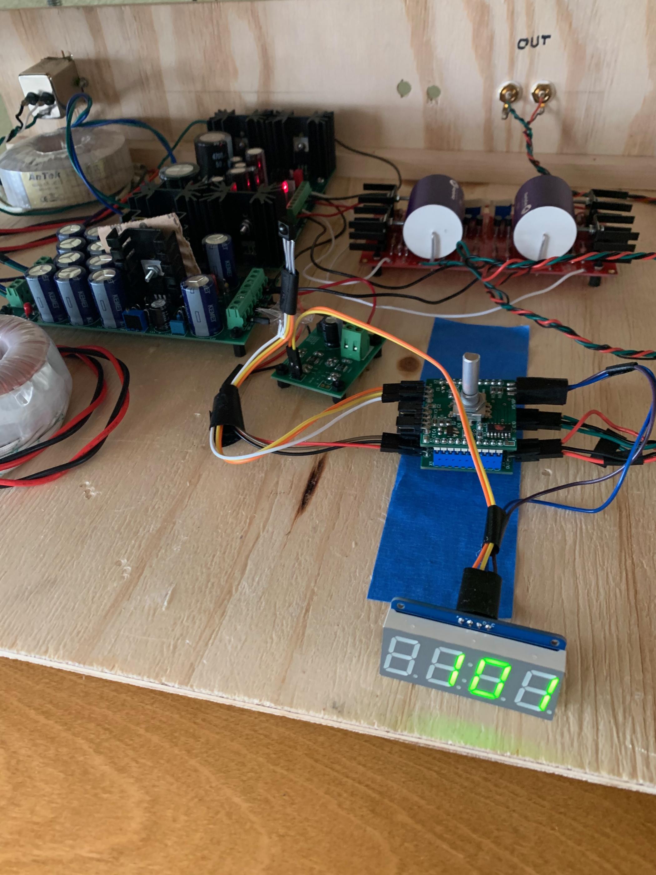

If I understand it correctly, will I need the following?
MCL - LCD Control Board for MUSES® Electronic Volume Control
SVC Hi-End MUSES®
Electronic Volume Control with Input Selector
Will I need the separate power supply offered?
LPS9, Ultra Low Noise Power Supply for Audio
I’m thinking I do?

The academy parts have the advantage that they‘re already soldered. (Which could be regarded as a disadvantage, though
Many have successfully built meldano‘s jig (he‘s at version 2 with the next generation muses btw) and there, a very wide band of „power-supplying“ from topnotch PSU down to cannibalising from the main PSU proved to be feasible. Exception: the display‘s current must be totally isolated.
AcademyAudio also offers some well documented App Notes how to integrate the Muses Attenuators with B1 Kork and BA2018 linestage.

BA-3 and Muses 72320. BA-3 rails at +-30 Vdc
I also use the Muses for BA2018 LS and it really compliments the linestage.
How do you feed (=power) the muses?
(and is this a vrdn with the BA-3?)
The VRDN powers the Muses (+-15 Vdc). The BA-3 has its own PSU (Sigma 22).

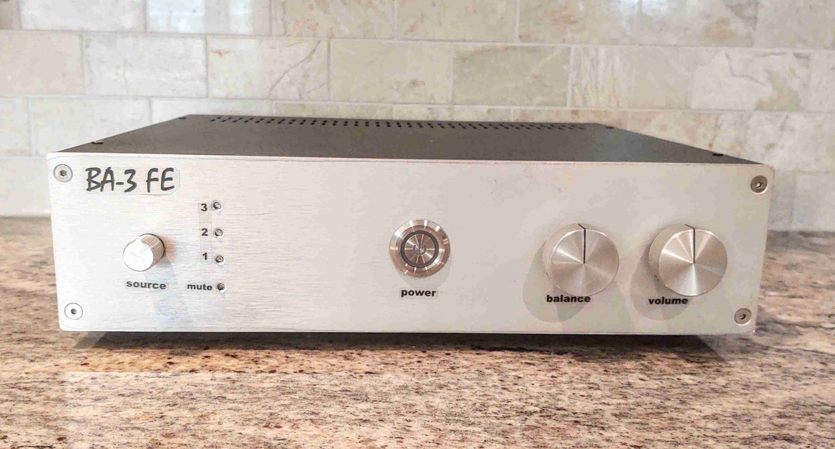

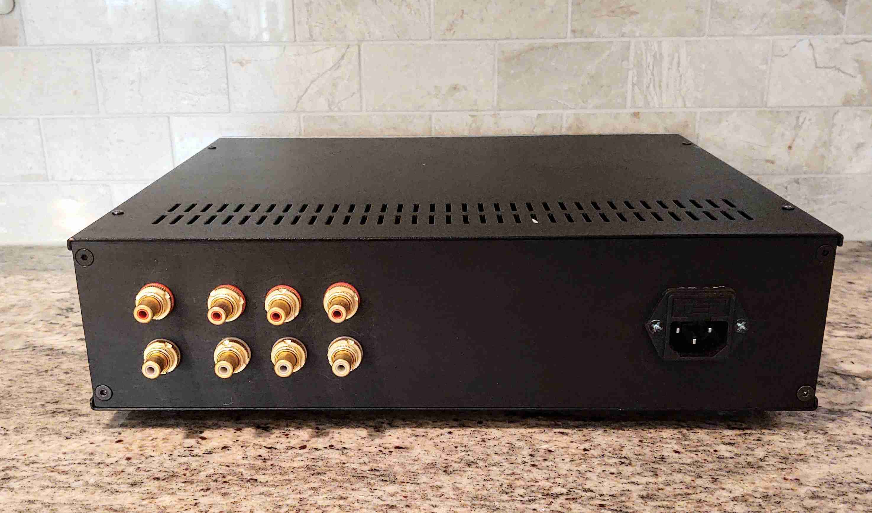

Finally got my BA-3 preamp in a decent case. I used the largest galaxy 2U from the DIYA store, it proved to be a bit of a tight fit, but it worked out well. I had the chance to try it out with my F4 replacing the Doug Self preamp that I had in that service. Good news is that it has that extra bit of gain that I was looking for. Not a big difference sonically though, maybe a bit more ease and naturalness, maybe a bit deeper soundstage. Very good imaging, but the differences are subtle and could due proud parent syndrome for my latest project, or due to the bourbon that I was enjoying. In any event I'll leave it in the system for a while to enjoy.
- The BA-3 as preamp build guide
