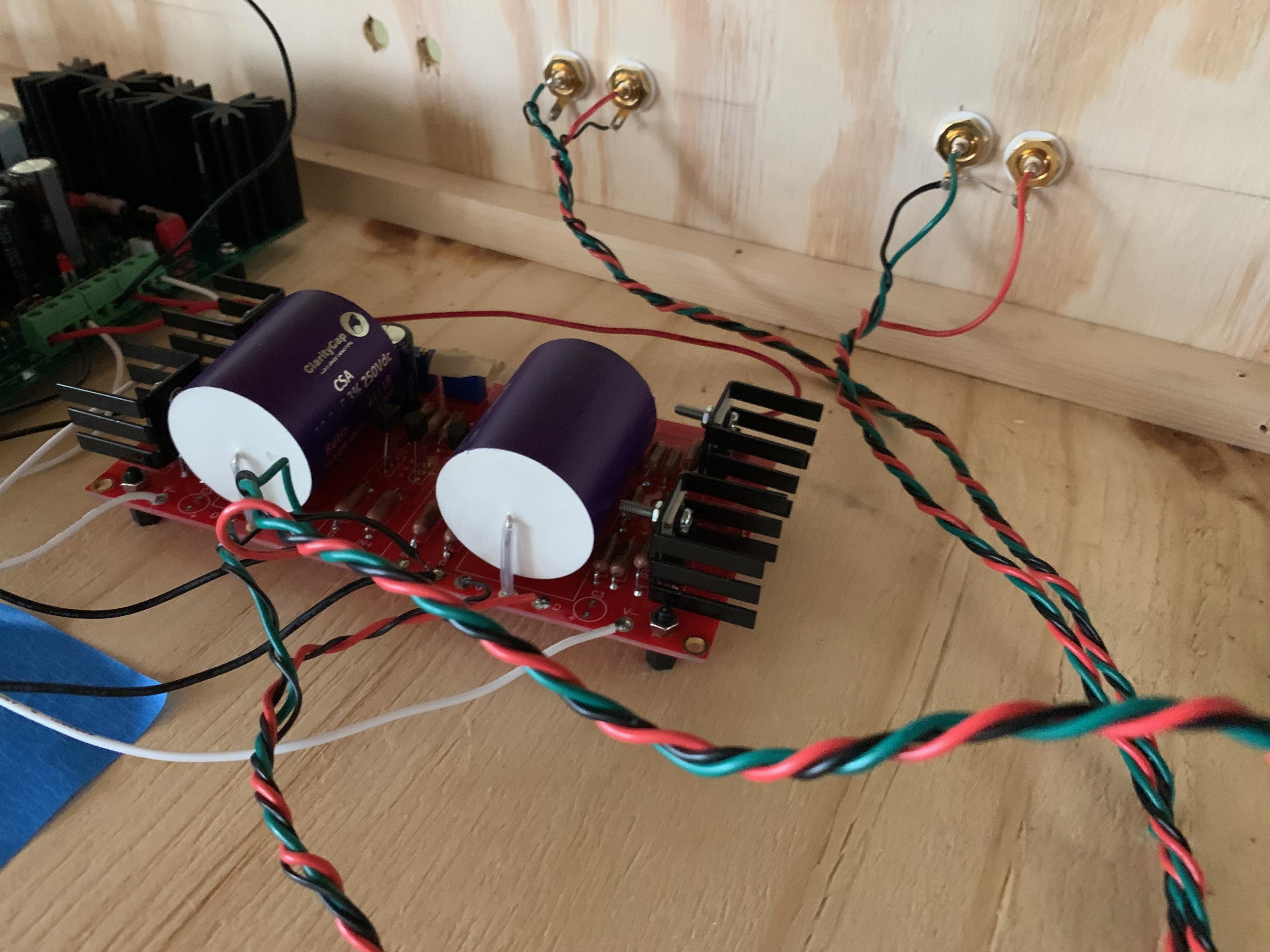

I have developed a preference for Auricap. It’s relatively cheap compared to other boutique caps.

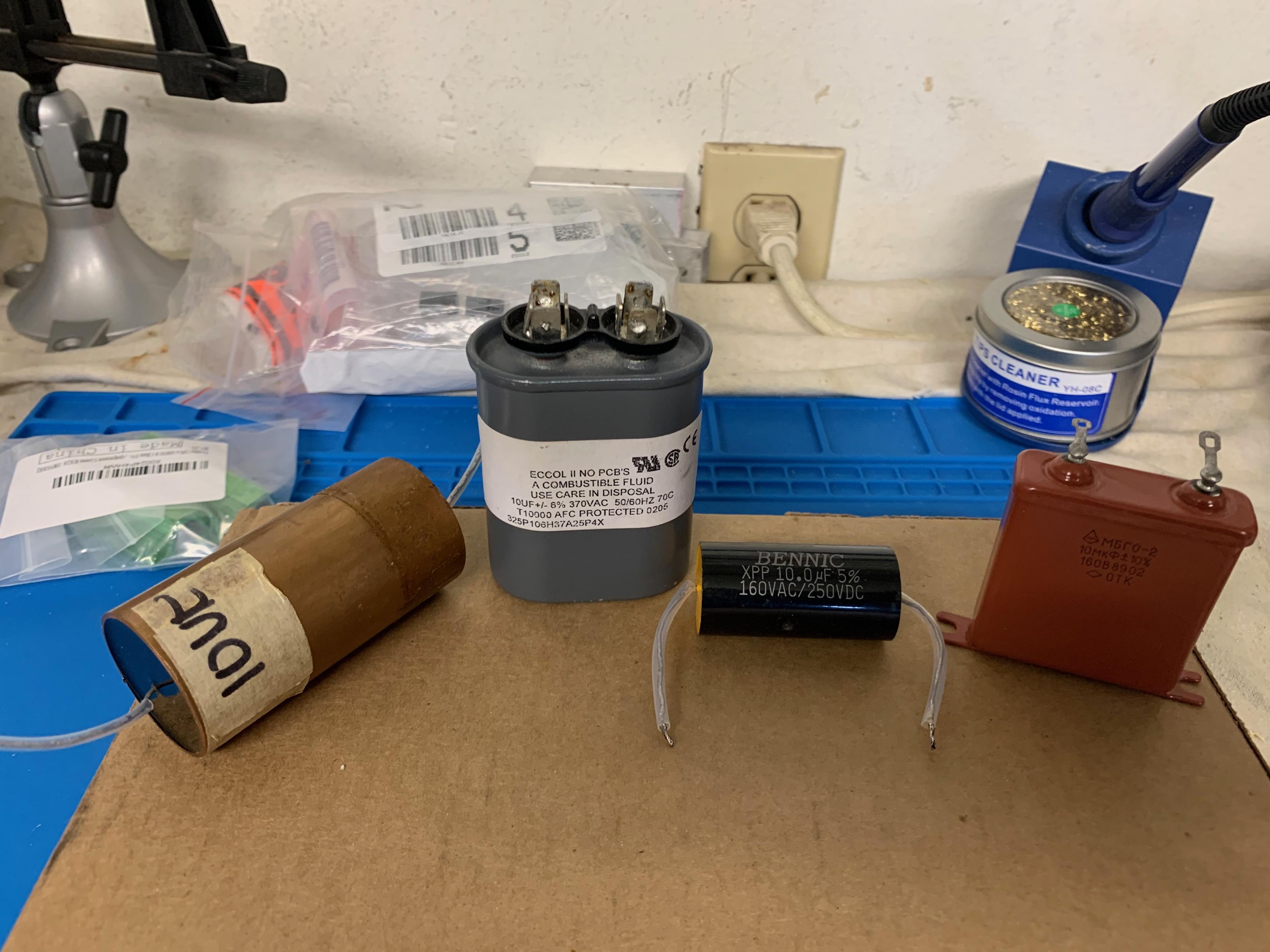

I have tried several caps too like the old Obligato (copper body), PIO motor run, Bennic, Russian (brown). Basically caps I have on hand. I am surprised about the Bennic, but currently have the Clarity cap installed.
I will try the Auricaps.
Check out Wago connectors on amazon for solderless connections. Very easy to swap things in and out quickly.

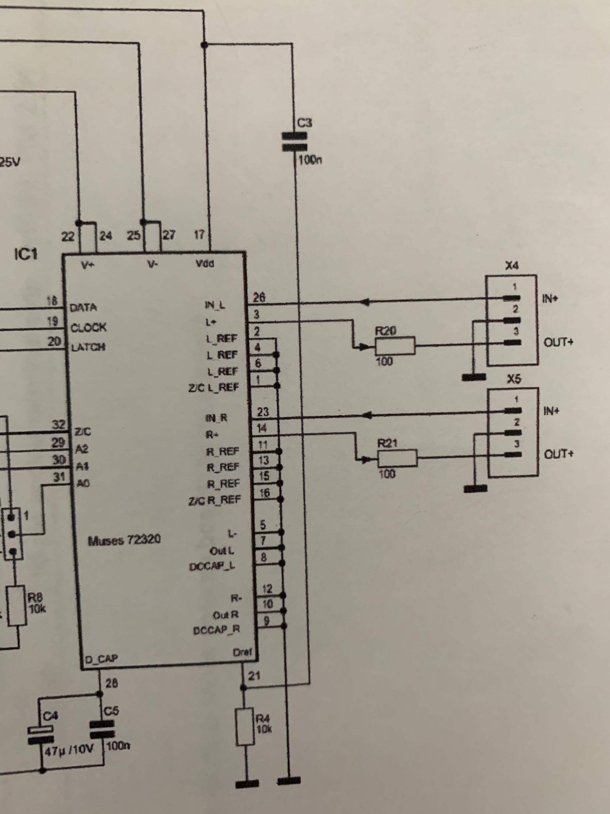

Hi guys,
As I reported before, I have Muses volume control to my preamp but I am getting a slight hum when connected to a tube amp.
The Muses is powered by a VRDN. No hum if I connect the combo to my M2X and of course, F4. No hum if I use regular vol pot to the BA-3 for both SS and tube amps. So, if I may, looking at the diagram, the correct way to manage the ground is:
R+ and L+ of the input RCAs to 1 (in+ X5) and 1 (in+ X4), R negative to 2 (X5) independent of L negative to 2 (X4). For the output to BA-3, X5 #3 to Lin BA-3, X5 #3 to Rin BA-3 and then wire from X4 #2 to L -in >BA-3 and X5 #2 to R-in > BA-3.
Or should I use R+ and L+ from Muses volume to BA-3 inputs, then connect PSU for Muses GND to PSU for BA-3 GND?
Thank for your help!

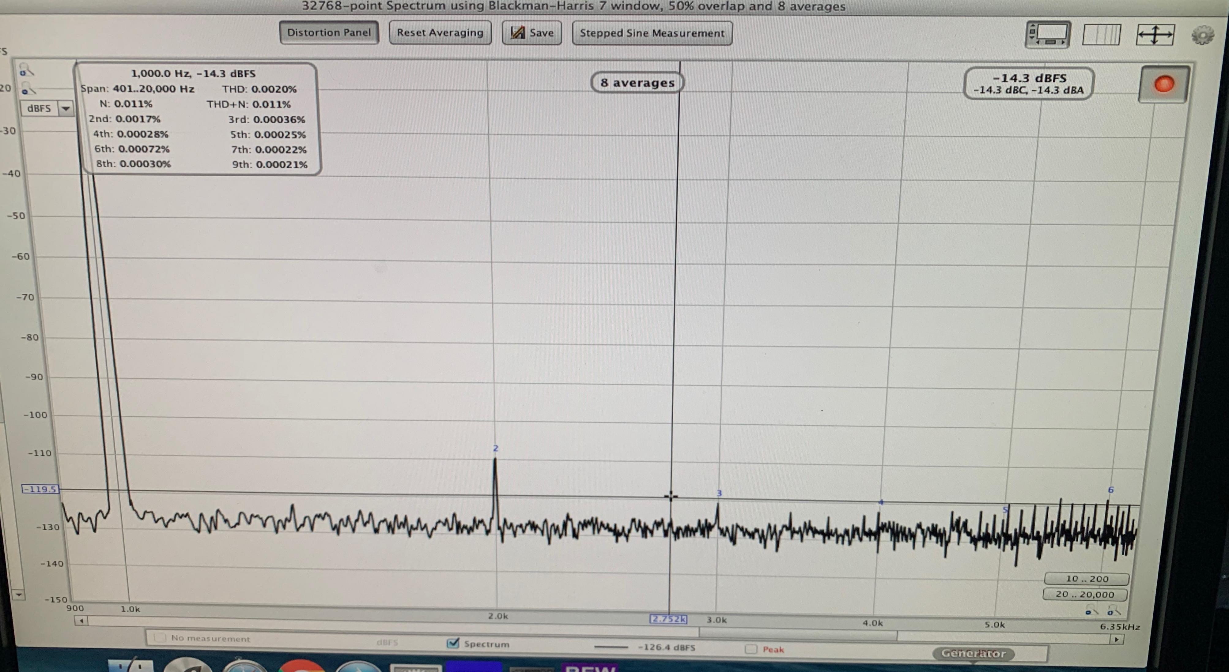

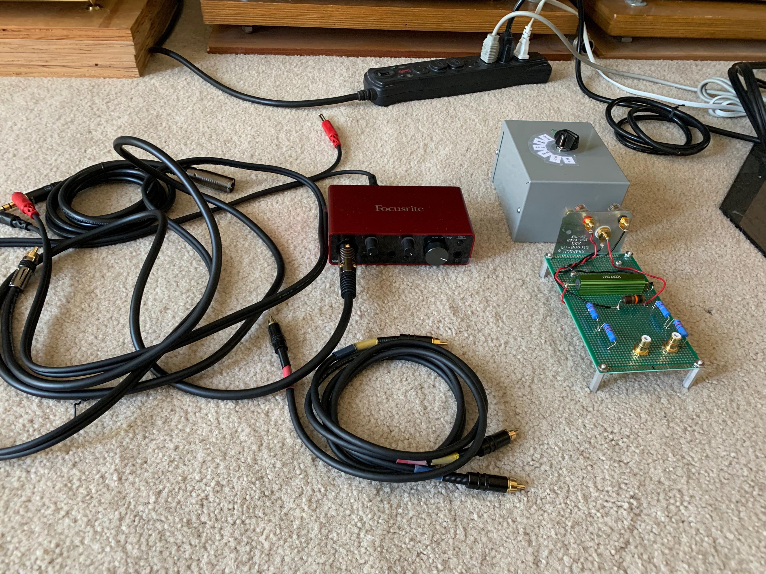

I was able to adjust H2 and H3 relationship (magnitude wise) in my BA-3. It is a tedious process and took me many hours to do the adjustments. I use Focusrite Solo for soundcard, a DIY 10k load, and a DIY attenuator and the investment is worth it.
Right now, H2 is ~9 to 10 dB higher than H3 for both channels and I ended up with the ff measurements.
L Channel: R11=0 .98V, R12= 0.987V, offset at 9.1mV
R Channel: R11= 0.992 V, R12= 0.992V, offset is at -6.3mV
The sound is dynamic and detailed than dominant H2 (I measured and adjust equal resistance leg of the pot at P3 before installation) and the soundstage is just right for me.
Thank you ra7 and chede for the tips and guidance! Amazing preamp and I do think that adjusting P3 is a must.
