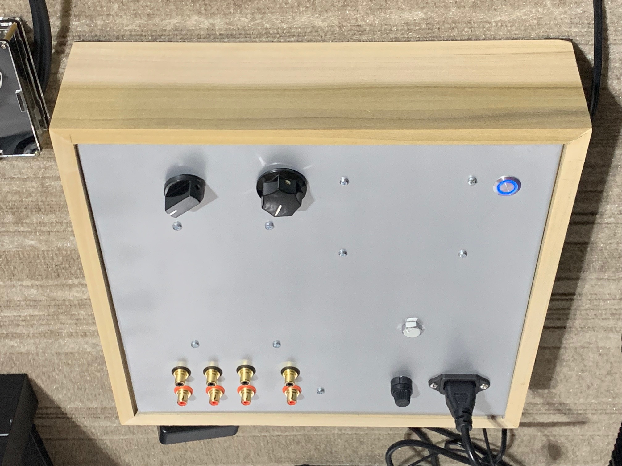

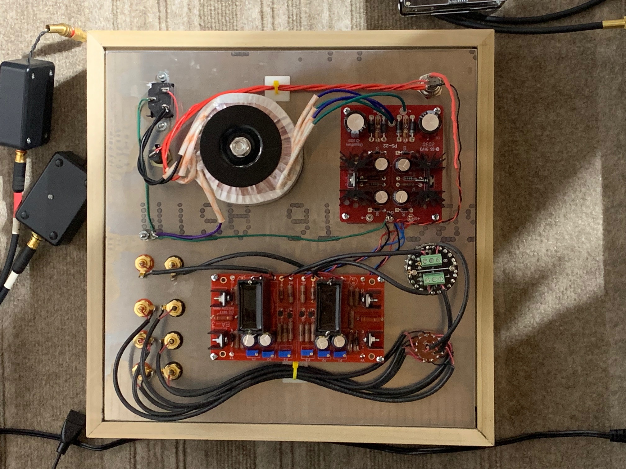

Will operator error strikes again. There was nothing wrong with my build. I just need to read the guide a little more closely and be patient adjusting the bias. I adjusted P1 and P2 to zero ohms and fired the amp up and started making my adjustments. Everything came into place and I was able to get it to bias at about 1v and offset was fairly close to 0. I will probably go back and check everything again later, but it is playing music.
Here are some pictures of my not fancy build. I wanted something that was more like the tube amps I have build in the past.
Nice build BRN. I would drill some holes where the heat sinks are to help with ventilation. Otherwise the hot air can get trapped in there.
Which output caps are those?
Ventilation is a good call. The base does have feet to allow air to flow under it, but adding vent to the top will only help.
The caps are Panasonic EZP-E 10uF that I purchase for another build, but never used. So far they sound good, but at the moment my hearing is jacked up. I had a procedure on my left ear and can't heat s#!t out of it.
