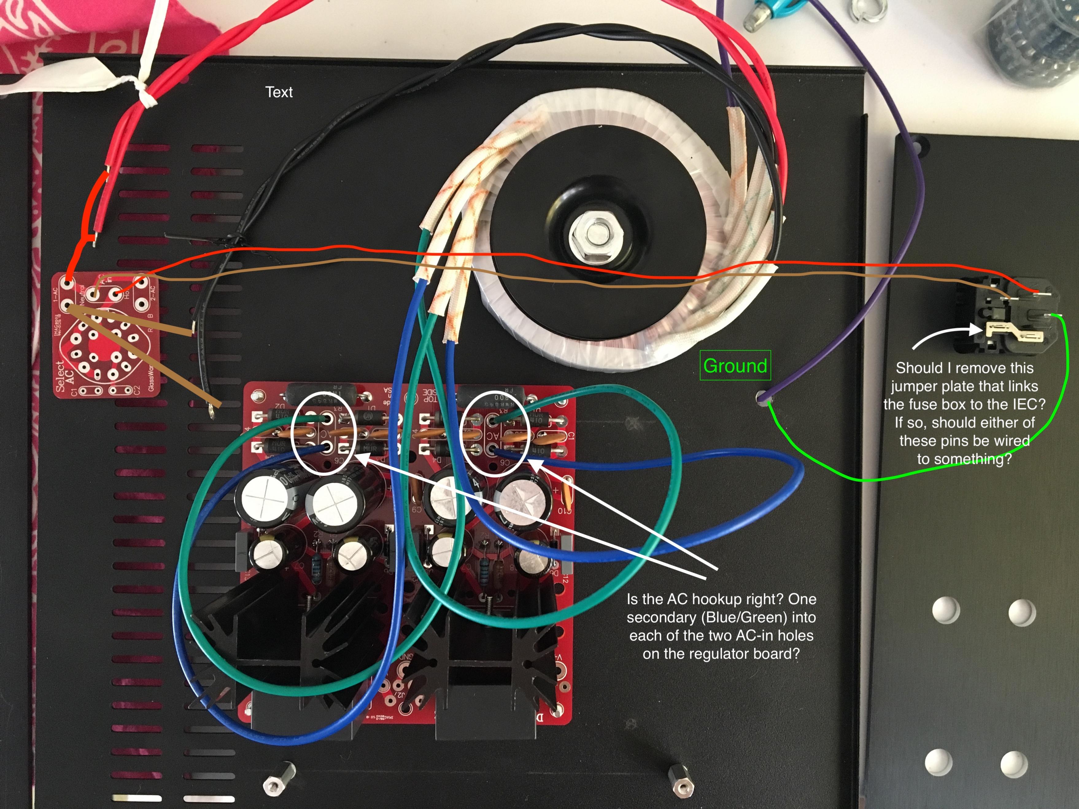

Okay, I have the boards for BA3-FE and power supply stuffed. Now to figure out how to wire up everything!
Before I solder any wires, I'd appreciate some confirmation that I'm headed in the right direction (or some course correction, if needed) with hooking up the IEC, switch, chassis ground, transformer, and PS board. I'm basically trying to mimic 6L6's build guide, and did my best to decipher how everything connects from his photos... but I'm still unclear on a few things. See attached pic. I tried to draw the wiring as I understand it.
Points of confusion:
1. Should I remove the (what I think is a) jumper plate that connects the fuse box to the IEC? If so, how should the two remaining pins be wired?
2. For wiring the secondaries to the regulator board: does it matter which color wire goes in which of the two AC in holes, so long as the secondaries are paired together (green/blue)?
3. For this dual/bipolar regulator board from Glassware, there's the option to run it in a dual configuration by leaving the two v+/v- sides separate, or in a bipolar configuration by adding jumper wires to connect the two sides. For the BA3-FE, I'm assuming I want to leave it in the dual configuration, right? (I can post a better picture of the board sans wires if that would help. Here's a link to the schematic.

3. the ba3 fe needs a bipolar psu - optional two for stereo - so jumper!
1. leave the mains fuse in function for safety reasons!!!
2. you might want to check the phase of the primary/secondary windings
(in series configuration - like in ct - the voltages either null or sum up)
have fun
A.

1) Please explain why you are interested in removing that plate.
2) Correct, it doesn't matter as long as you have the secondary wires paired properly.
3) Install J1 and J2 to make the PSU bipolar. The center near the jumpers becomes ground, and V+/V- comes from the outside of the PCB. See photo from different project, but it's wired identically -

The secondaries look right, each one has two wires coming out next to each other.
Thanks, @Attila and @McQuaide!
So for the mains fuse, I have it "wired" correctly in the photo?

1. I didn't see the plate on the IEC you used in your build guide - it looks to my eyes like you had wires coming from each of the pins in both the IEC and the fuse box, which is why I wasn't sure if I should remove the plate. I see now, though, that the plate just functions as a connection between the IEC and the mains fuse, which would align with this diagram which I've been using as a reference to complement your build guide photos.
3. Thanks for this photo - It is very helpful to see this PS board in action in a different build! I'll add the jumpers to make it bipolar.

As for the mains, plug a cord in (not to the wall outlet) and check continuity from the prongs to the connections to the transformer and ground.

On the transformer primary red wires are hot, black wires are neutral, you have it opposite at the switch in your diagram. It will work either way but better to do it correctly the first time.
For the transformer secondaries you need to find the “pair”. The transformer has 4 secondary wires and two of them are pairs on the same winding. You can find the pairs by testing for continuity with a meter. If you have continuity or a low ohm resistance between two wires they are a pair. If it’s a lot of resistance it’s two wires from a separate winding, you don’t want that...it will blow the fuse immediately.
