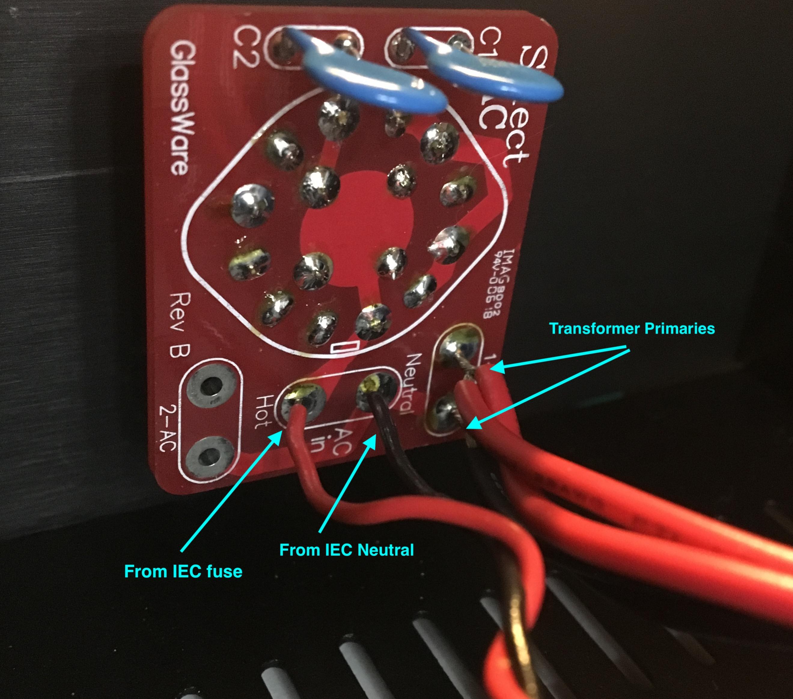

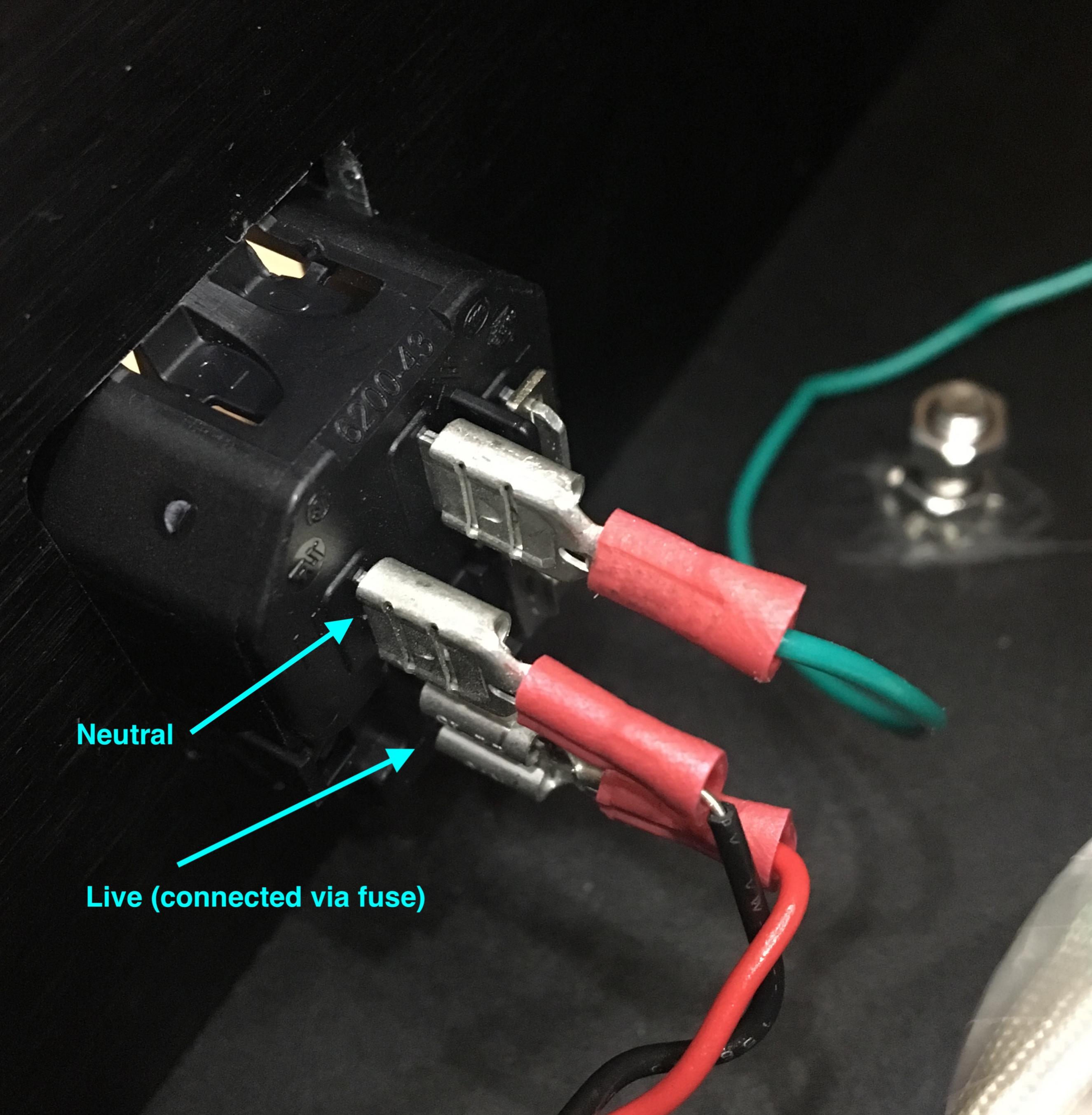

Related to Hikari's AC concern,
Please ensure that you wire the live side of the AC wall outlet to the live side of the IEC.
As I understand it, and PLEASE, do not think I am an expert:
When the fuse blows, it's supposed to disconnect the live conductor from the amp circuit, not the neutral. If you fuse the neutral side, the live AC is still live after the fuse blows.
Live and neutral can be reversed if you make your own power cables -- so be careful!
Thanks, BigE. Hikari's comment made me look more closely, and I think I have it wired correctly. Attached is a closeup of the AC switch and IEC socket wiring. Of course, I might have all wrong, too!
