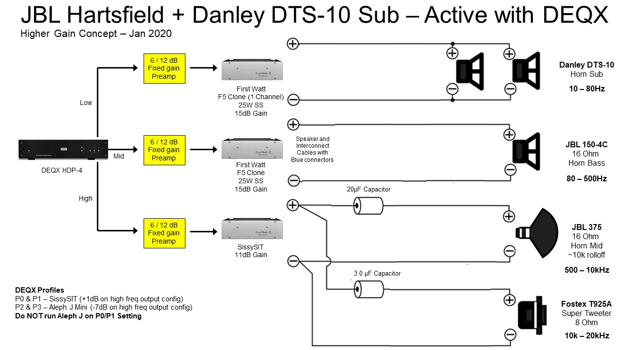

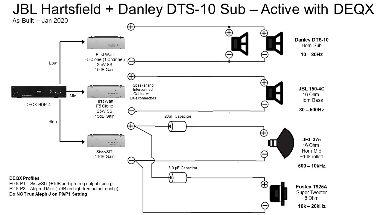

I'm looking for input on a fixed gain preamp project.
My system is active (details in pix) and the amps are 15dB gain F5 (3 channels) and 11dB gain SissySit (2 channels). The DEQX unit is acting as a DAC, active crossover, speaker & room correction box, and preamp. As a preamp, there isn't gain. I had the unit re-calibrated yesterday for the SissySit, and it really sings!
When I take the system to max volume, it sounds great (and pretty loud). However, I want a little more gain for those jam sessions that require turning it up to 11.
My thought is to make a box with 5 channels of fixed gain preamp using a clean/transparent design. Perhaps I have a switch for 6 and 12 dB gain.
Would a regulated PSU and 3 BA-3 driver boards be a good solution?
What would be the best way to do the gain setting for this case?

save BA3 boards and make little bigger amps than F6 , using BA3 source follower OS (or F4 crippled , whatever)
for preamp - see upcoming Iron Pre , for 6 or 12db gain ; hopefully it'll be Swiss Knife package
ask Jim (6L6) for details - what , when ......
there are plenty of preamp stages in Papaland ( Wayne's , BAF Heaphone/line ..... ) , I'm just writing what's most fun lately to me
