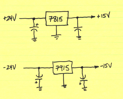

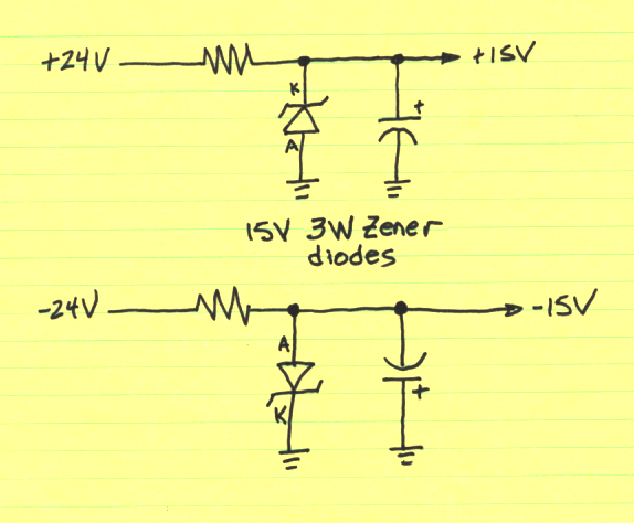

The absolute easiest thing would to run a couple of 1W 15v zeners from the 24v supply to make +/- 15v, or a pair of 7815/7915 fixed regulators and a couple of small capacitors, either would be more than enough as the main supply is already well filtered. A separate supply is overkill.
Is there a way to source +-15VDC from the power supply in my BA-3 that is feeding +-24VDC to the BA-3 board?
Sure, there are a couple ways. You could use two zener diodes (Figure 1 below) and two resistors. 6L6 was probably posting in a hurry and accidentally omitted the resistors from his description. Or you could use a couple of voltage regulator ICs, one to produce +15V and another to produce -15V (Figure 2 below).
Either will work but I prefer Figure 2 myself.
(BTW Mouser has many many 1N5929B zener diodes in stock. 15V and 3 Watts: link )

Thanks, how about these regulators:
https://www.mouser.com/ProductDetail/ON-Semiconductor/MC79M15CTG?qs=sGAEpiMZZMuLLNXTG1MZak6HpgO6pjZJx4khxPKvBKg%3D
https://www.mouser.com/ProductDetail/ON-Semiconductor/MC7815ACTG?qs=sGAEpiMZZMutXGli8Ay4kCBGNN2haXZXl%2FF7GTwr8so%3D
And what would the electrolytic cap values be?
