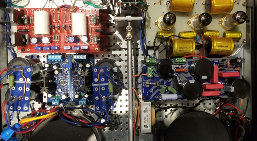

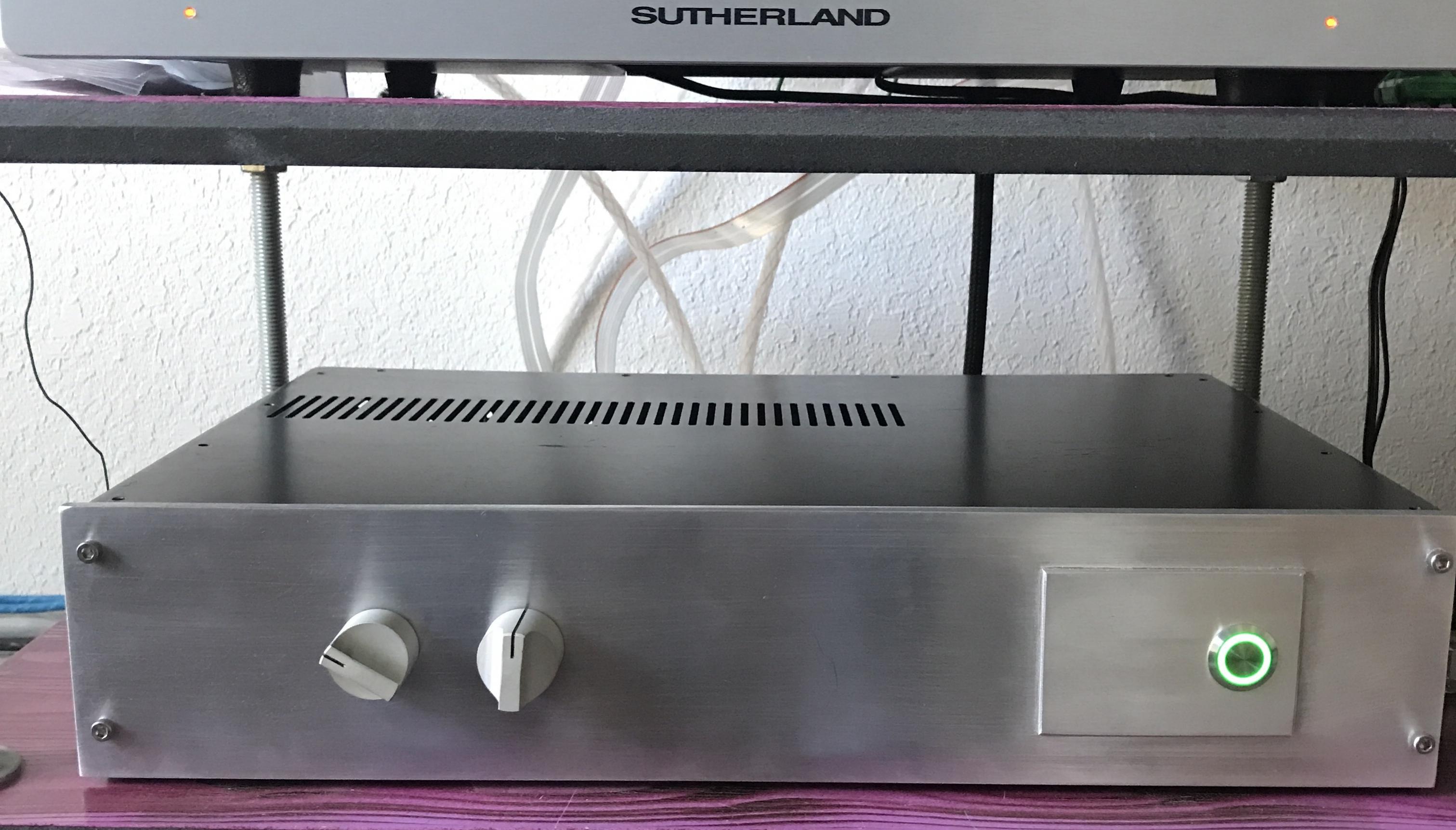

So everything is working great with my BA-3 preamp build I have about 15 hours on it running at 90%. Going to let it burn in a little longer for I bias it up.
So a little background before the BA-3 I have been using a Hagerman Clarinet tube pre and before that the Mesmerize B1 and the B1 buffer before that. The Hagerman was the clear winner over the other two. I was the BA-3 and the Hagerman after I get more hours on the BA-3. So on to the BA-3, my initial impression was it was a little rough at first somewhat on the bright side my source was CD's I start there before I switch over to vinyl. It only took a few hours of burn-in it started to settle in and that brightness calmed down, Been listening to a mixture of different music genres Vocal, Jazz, Rock, Acoustic, mostly everything now on vinyl. I have to say I am really impressed with is so far tight bass, wide sound stage, and dead quiet one thing I didn't get from the tube pre there always a slight low hum. (tube gear right) Big thanks to everyone who put everything together to make this build possible and for all the help along the way.![cheers :cheers: :cheers:](https://files.diyaudio.com/forums/images/smilies/cheers.gif)

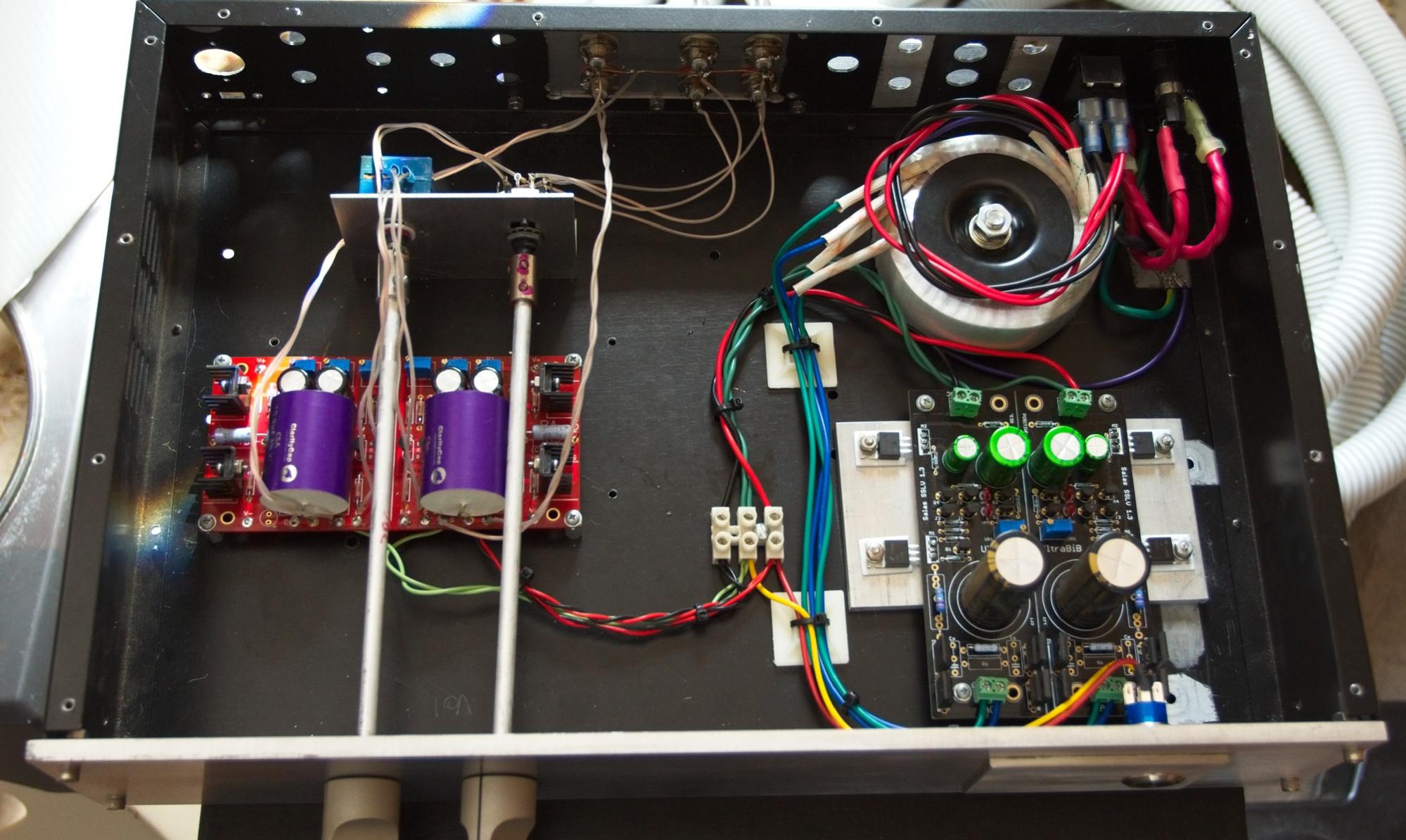

I built my BA-3 line stage using Dale RN60 resistors with Solen output capacitors.
I put it in a cabinet set up for a previous less-than-successful project- a Chinese JC-2 preamp kit. Despite subbing in NOS Toshiba 2SK170/2SJ74s, it never sounded good.
I had a Chinese kit built Kubota supply that I used for the +/-24V supplies. If the Kubota had been unsucessful, I would have tried an AMB Labs Sigma 22 kit.
The BA-3 is easily the nicest sounding solid state preamp that I have built. It has a warm tubelike quality, but is also fast and detailed. It lacks the huge sense of depth you get from a tube preamp, but I find it pleasant enough that I could live with it if the world ever runs out of tubes. It was well worth the low cost and modest effort that it took to make.

Robert,
Good work, and how have you set H2 / H3? It definitely makes a difference. Although it may never sound like a tube pre, it will have better resolution and be close with the right combination of H2/H3.

This is coming together, I should be ready to apply power and test tomorrow. The SMD soldering seems to have worked based on multimeter checks, but we'll see. The regs are putting out +14.95 and -15.16VDC.
This has been more labor intensive than I thought, but enjoyable.
