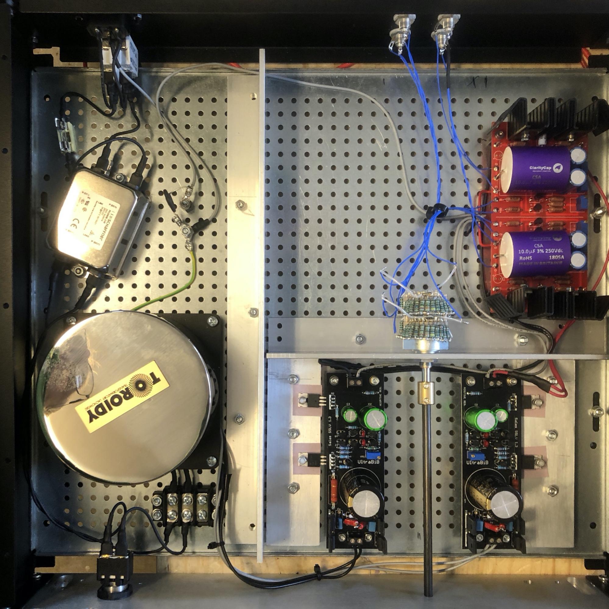

BA3 is warming up at bias ≈890mV. It sounds very controlled and relaxed with fine details. At 90% bias 1V gives 2.5V out. In a few day I will turn up the bias. The FFTs are done with almost no warming up without tinkering with P3s. 1K/1V sine wave from RCA input, so through a 10K pot at minimum resistance. More testing with full bias. Feets and an indicator led is scheduled.
Thank you 6L6 for bildguide, NP for a nice design and everyone else for tributing.

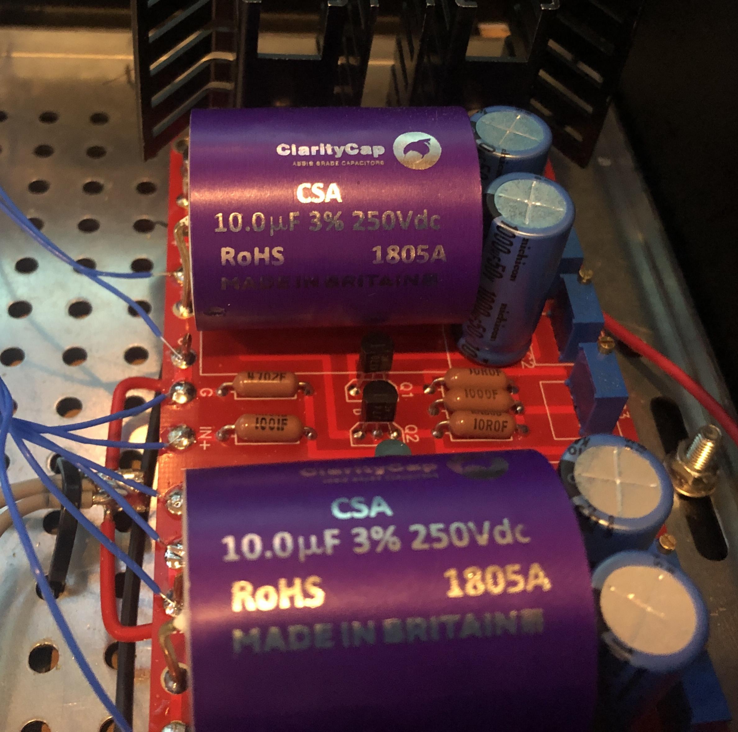

Very nice build! I like the isolation of the PS. What type of coupling caps did you use?

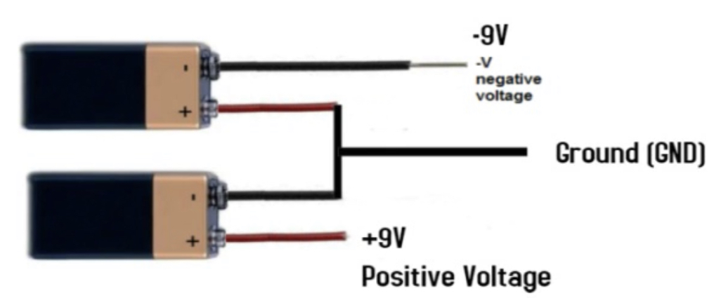

So, I’m using two 24v meanwell SMPS’s (like ACA) to power my BA3 FE. I have no problems getting the positive voltage, but the SMPS I’m using to power my negative rail will not power on. I’ve attached a pic of the wiring config I’m using (sub SMPS for the batteries in illustration)
Any tricks to get this to work properly?
to get that , SMPS outputs (both pos and neg) must be floating/isolated from case and safety GND
Yep, that did it. Thanks ZM!!!
The two SMPS are working fine and feeding the CRC as expected. My question now is grounding scheme - do I take V+/- from the caps and reference the circuit ground to chassis? Or does the circuit ground need to float too?
The picture in 1816 is all the progress I’ve made. I simply cut the barrel connectors off, tied the + of SMPS 2 to the - of SMPS 1. I tied that new ground reference to the cap bank ground, along with the new + and - to the corresponding spots on cap bank. Beyond that, I have not attached the +, -, or ground from the cap bank to anything.
